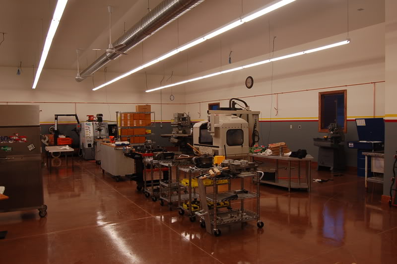

My shop when I built it in 2011

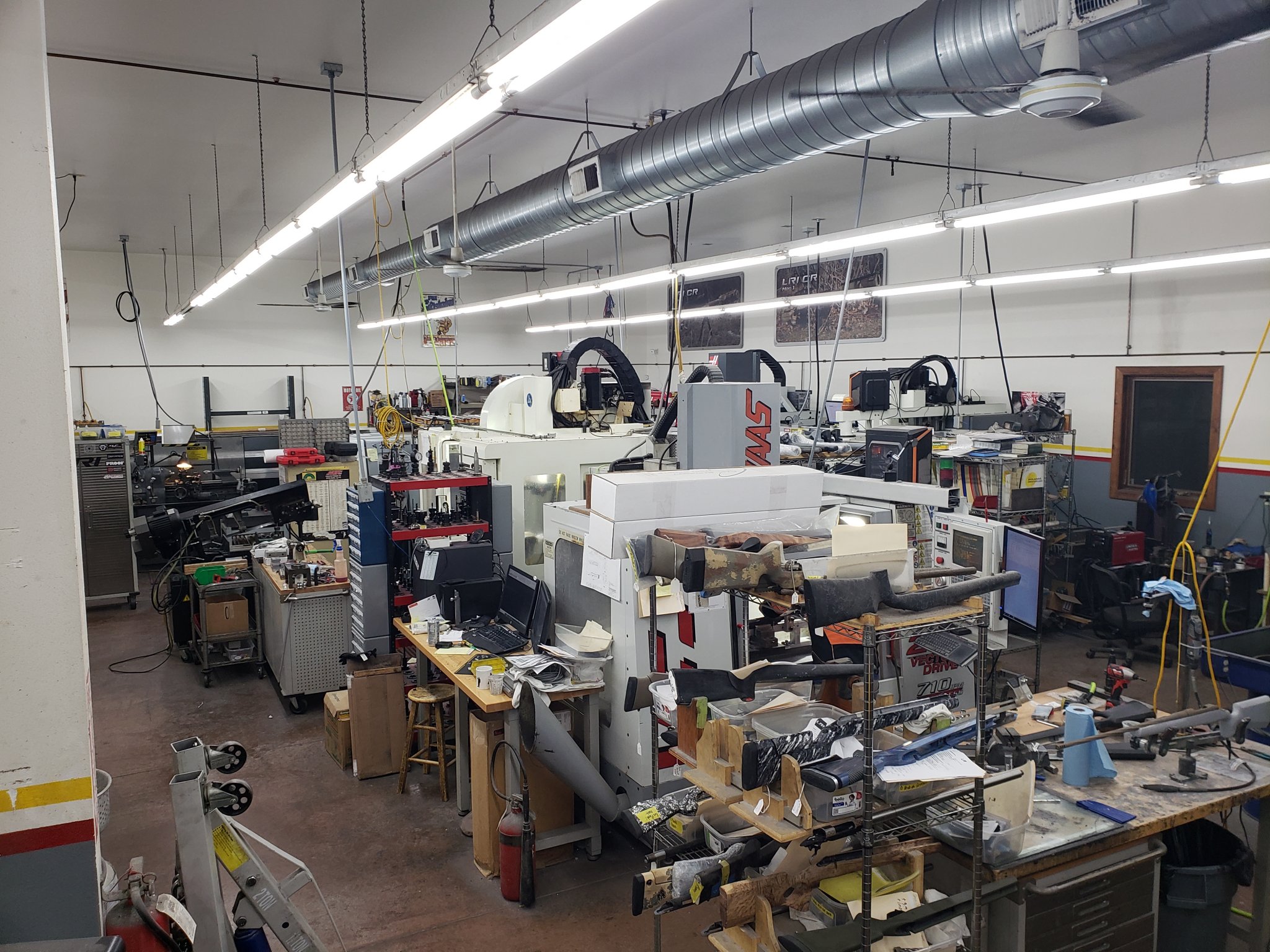

LRI today:
Chad at LRI is a real pro and basically changed gunsmithing in the precision bolt world with his CNC techniques. He built me my first 6.5 Creedmoor before they were cool and it was a laser! He would be a good guy to learn from.
Reactions: Ledzep
Chad,
This hands down is the probably the best, most helpful and relevant response to a question that I may have ever gotten, and I don't just mean on the interwebz. Coming from someone whom I respect as one of the best machinists that I am aware of, this means more than I can express. I will absolutely heed your advice and will be looking at online resources to learn more, and your cautions on Posting (if that is the proper useage) has not fallen on deaf ears.
Thank you so much
