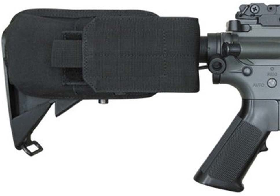

One of these works well for pretty cheap. Just a cheapo pouch that's made to hold a spare mag, but works well for battery pack also.

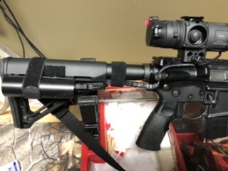

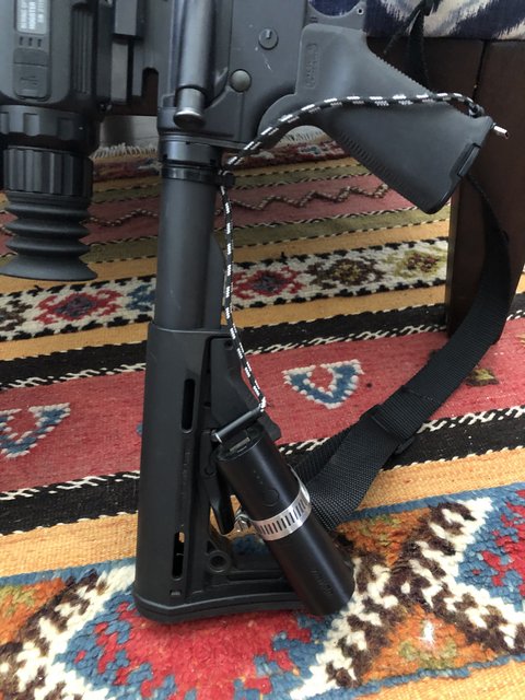

I have one of the 5k cylinder shaped ones. Last time I had to use it I just strapped it to the off side of my AR stock up under the cheek piece with some ranger bands. Worked like a champ.

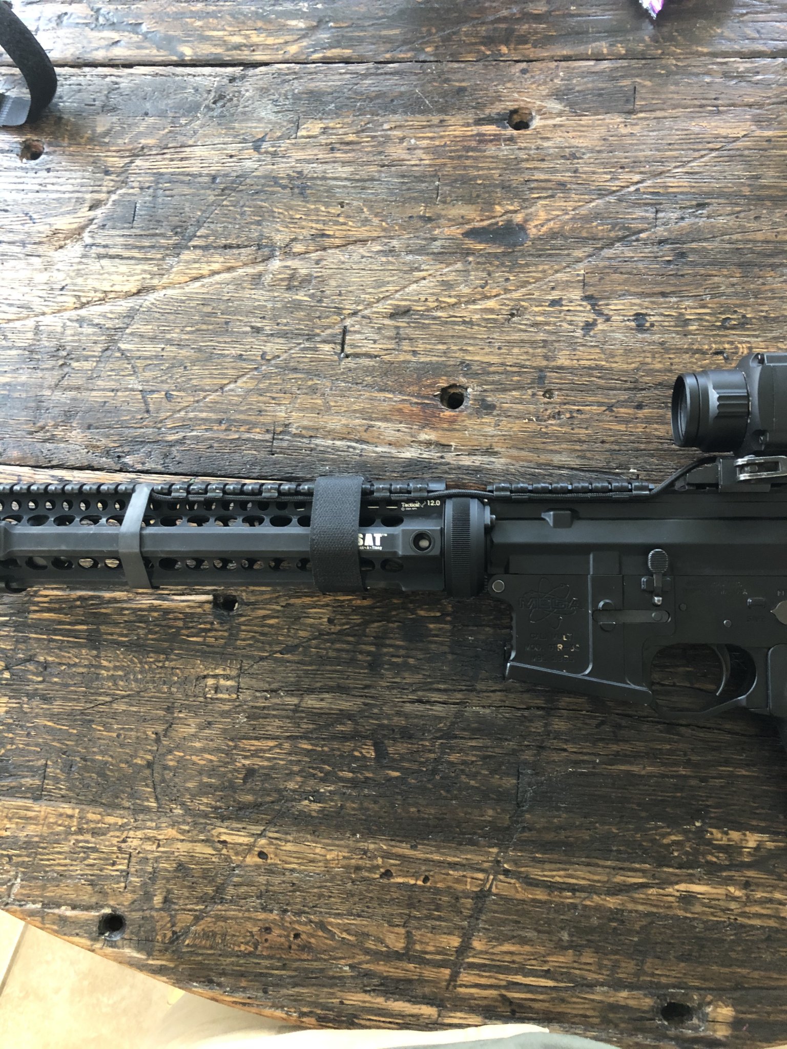

I use the bobo method....just add velcro to the stock and battery to get it set, then cinch it down with a velcro strap. As Crews mentions above the 5k cylinder fits snug to the stock.
Using the TNVC TRB with a USB extender, prefer the battery on the stock. Feels more balanced to me.

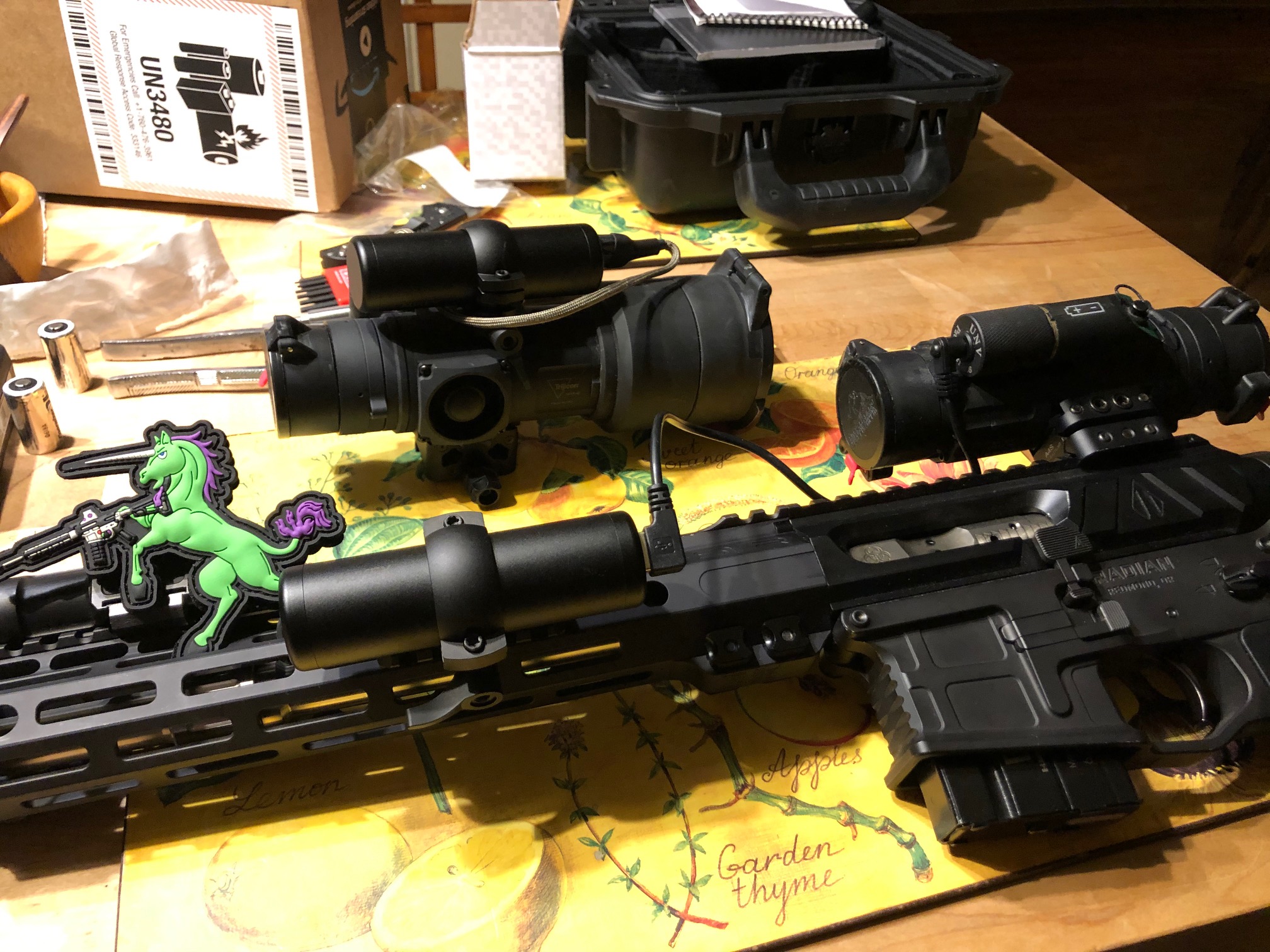

First I have seen of Apex which looks like a good plan. Here is Something I have been toying with 30mm quick release scope rings. $15 for a pair of rings and ten each for the batteries. Reap 60 won’t work with quick release lever so have an even cheaper set of non qd rings to try for it. All of the 5mah lipstick batteries have worked on both of my units. One type of batteries seems to prefer to use a slow charge function.

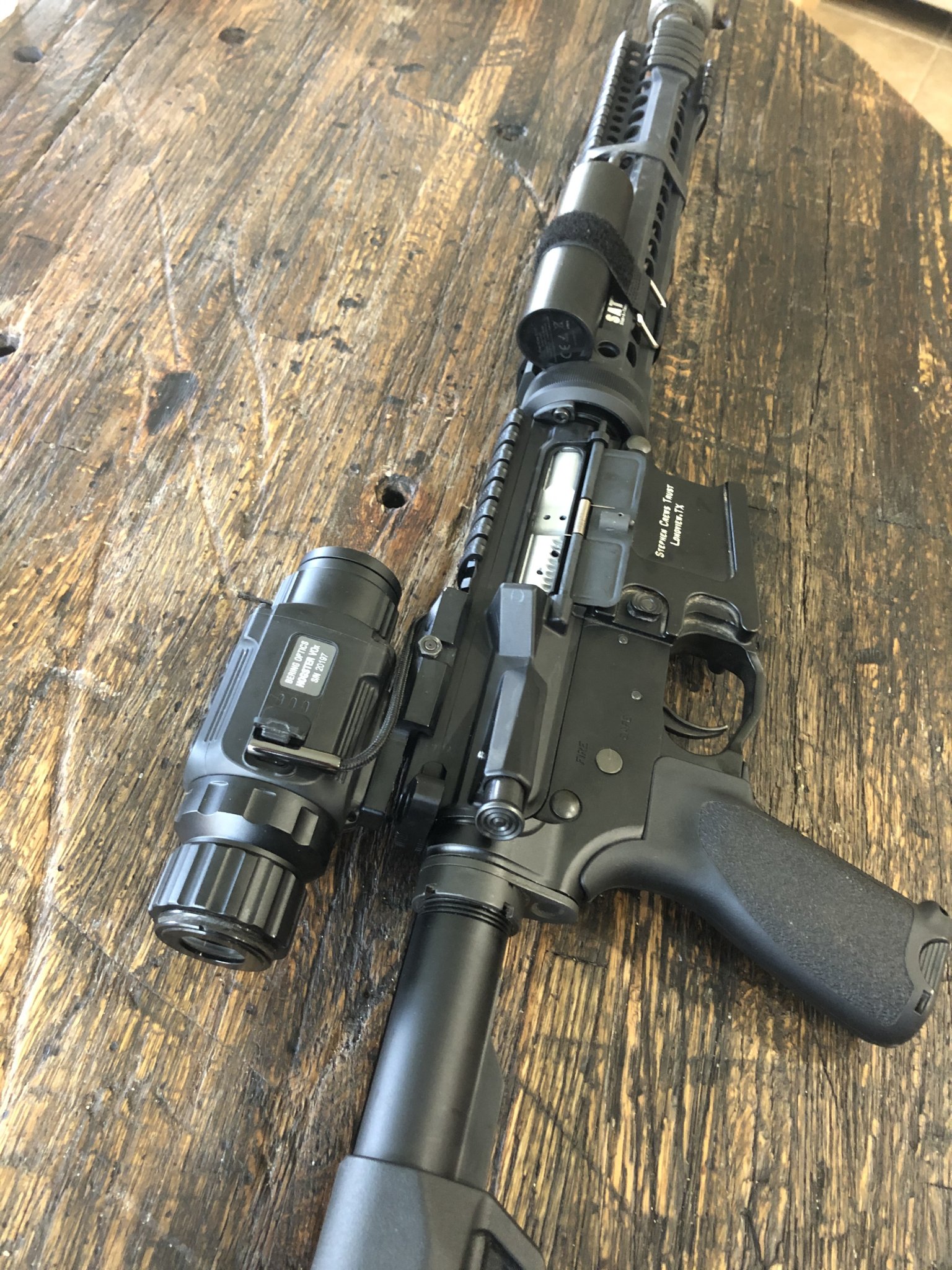

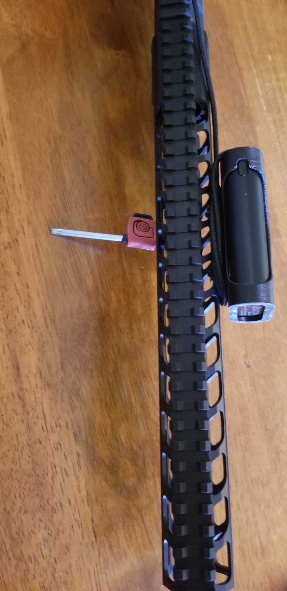

Wanted to share my new set up I’ve been working on this afternoon... the 5k Anker fits up tight against the top corner of the rail and is held in place with a Velcro strap. It will soon be replaced with a Neomag Sentry Strap that will serve a dual purpose. The right angle fitting on the thermal end is nice and low profile. Larue index clips and a ranger band make sure there’s no loose wires. This is my favorite setup yet.

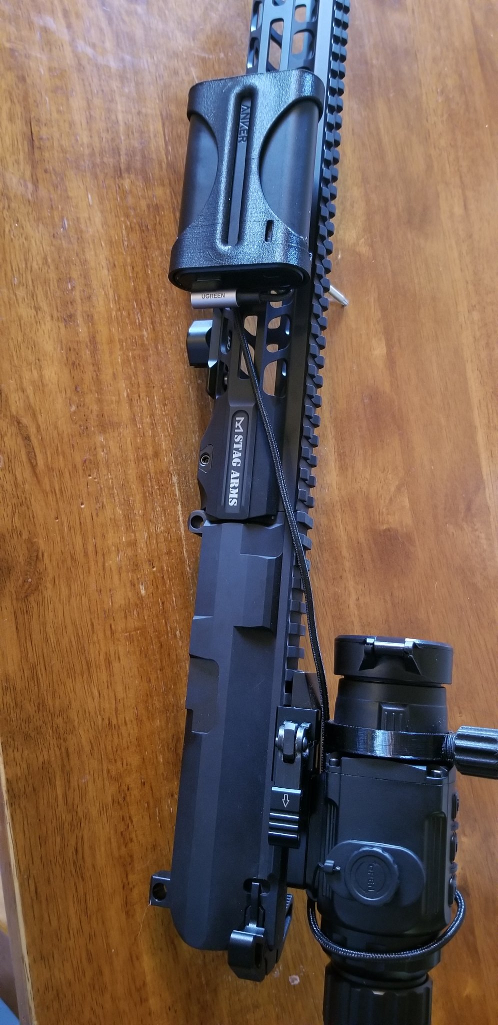

I use the Apex. Just got the my first one about 2 weeks ago. Upon reciept it looked like the gorillas at USPS dropped a heavy package on it. Broke a purely cosmetic part of the battery holder. I sent a message to Apex with pictures. They got back with me in a few minutes and said that they don't want me running around with busted gear, even after I offered to just glue it together being that its just cosmetic. I now have a new unit on the way.
I like how the Apex mounts closer to the rail than the other ones I have seen.
