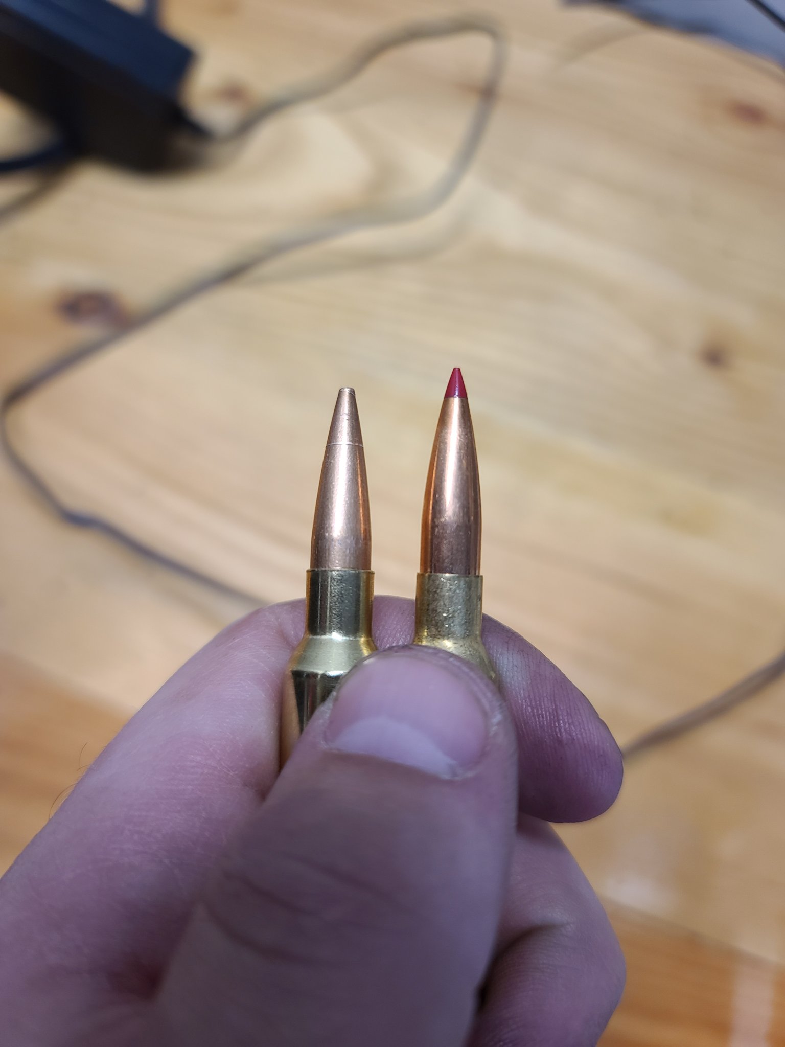

Still pretty new to reloading so hopefully this is a stupid mistake on my end with an easy fix. Just finished firing the rest of my virgin ADG 6.5 creedmoor brass. Got everything washed and was ready to resize. I noticed a flaring or bell or lip (not sure what to call it) on the outside mouth of the case. I ran it through the chamfer and deburring tool on my prep center, resized it, and seated a bullet. It will not chamber in my rifle because of the lip. I chambered the piece of brass after resizing it, and it fit fine. Once I the bullet was seated that lip on the outside of the case mouth was making contact when I tried to chamber it. I compared the lip of the mouth on my loaded round to a few factory rounds I had laying around. The factory ammo all measured 0.880 while mine measured 0.940 (those numbers are from memory, but there was definitely a noticeable difference.
I didn't take any pictures of the brass that hadn't been sized yet, only the loaded round compared to a factory round, but every piece looks the exact same. There's a very clear and noticing lip, especially when I run my fingernail over it. I didn't notice it on the brass when it was new, but I'm assuming it wouldn't have chambered when I loaded the first batch if it was there.
I deprimed the brass using a Frankford arsenal hand depriming tool, and tumbled the brass with ss pins. I've read that contact between cases in the tumbler could possibly cause this, but I did about 1,200 other cases around the same time in the same exact way with no issues.

So just a few thoughts.
1. I dont really see a debur or outer chamfer on your pics
2. What was the measured OD of the neck on the 1st firing? What is it now?
3. Have you looked in the chamber? Crud, carbon, brass
4. Same bullets?
5. Tumbling method?

I'll try to get a picture with a black background so you can see it better.

Trim the brass.
If you wet tumbled for an hour plus, that can do it. I’m sure tumbler capacity/fill can impact how much the cases bang against one another, but I haven’t tested it thoroughly. I just wet tumble for <20min with no pins now. Haven’t had that issue since.
Trim the brass.
The brass is already just under the trim length in the reloading book. Will going even shorter affect anything or ruin the brass?
