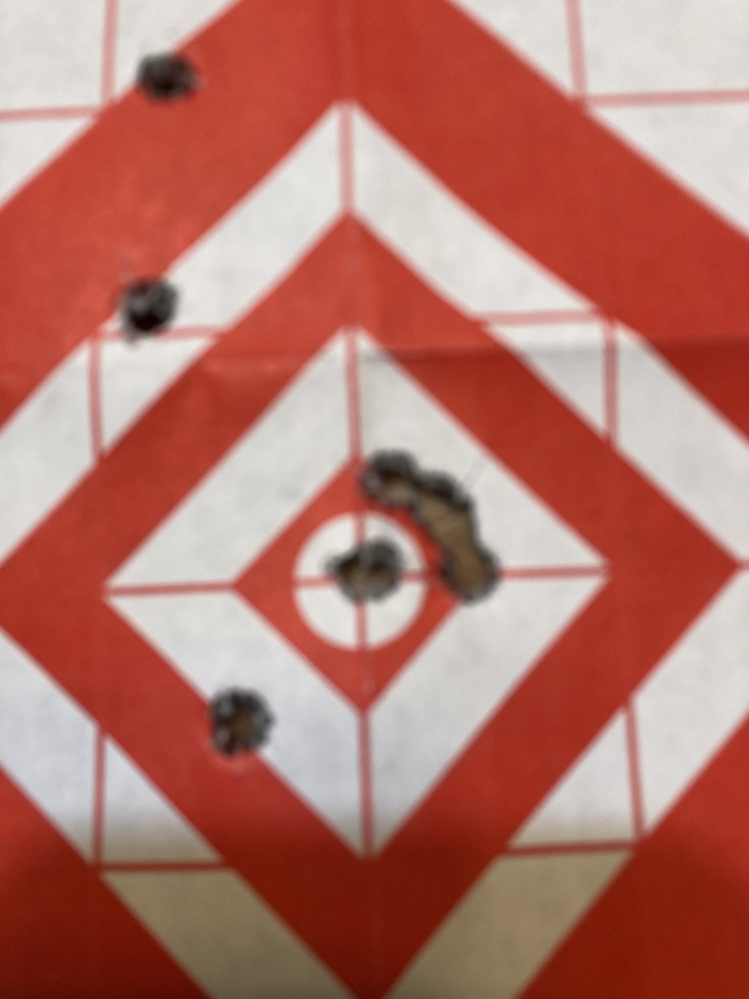

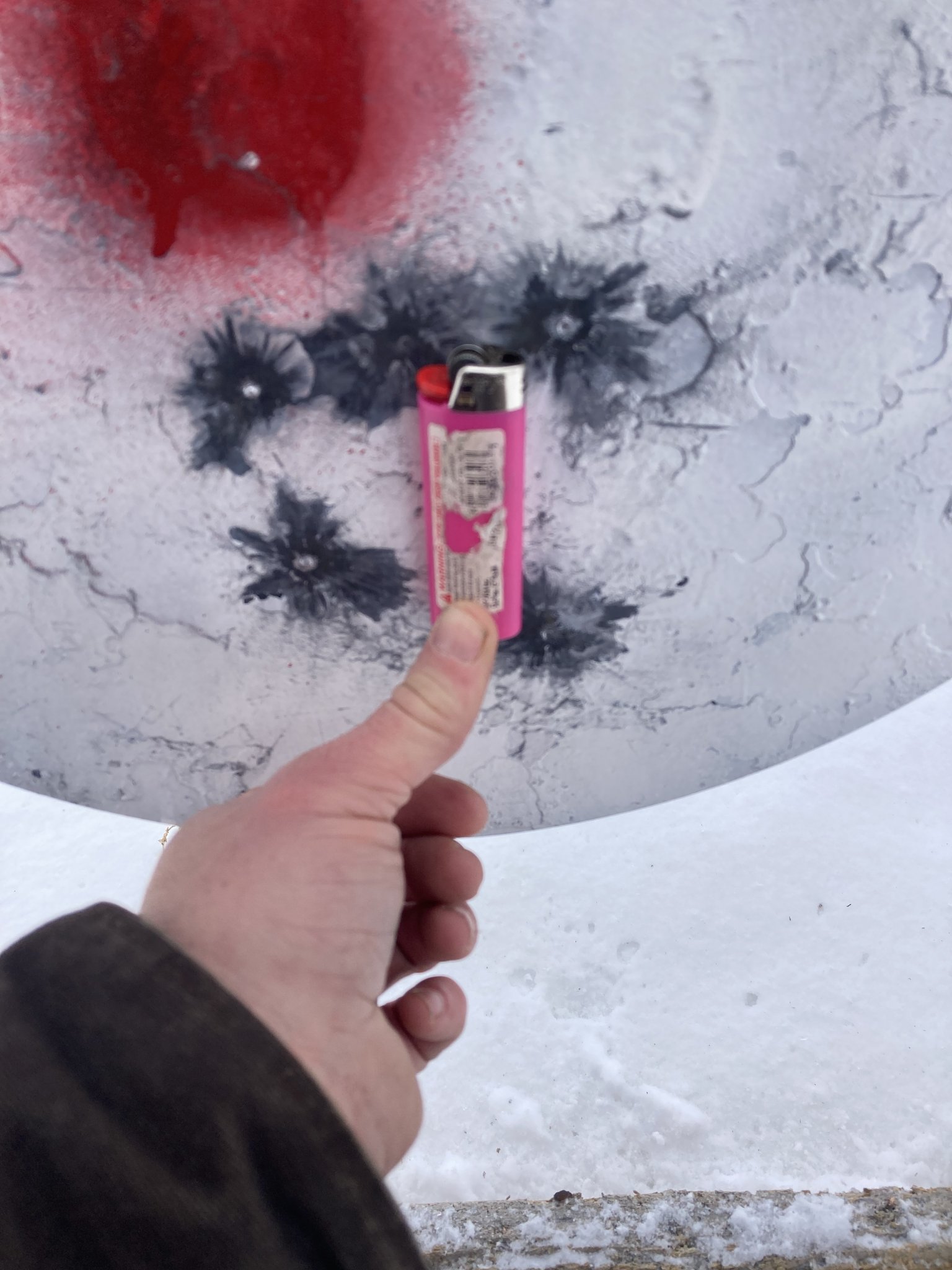

My second 6.5 G build - or rebuild traded up on the barrel and gas system .
Best group at 500.
Had some magazine issues and some gas issues got them all sorted this weekend.
Dura mags seem to feed the best after some attention is paid to feed lips .
One out of 3 ASC mags has been 100% the other two are going in the trash .
Anyhow pleased with how it tuned out .
The bic lighter is 3 inches for reference.
The two high and one low shots on the left was sighting in at 100 then the next 5 just high and right of center and then last 2 rounds in the mag dead center after a small adjustment. Still don’t have but maybe 100 rounds down the tube . Have high hopes for this Franken AR
It’s really fun to be able to take a lightweight Grendel with a nice barrel, and just stack rounds on the head of an IPSC at 500yds, while watching your own impacts and not needing anyone to spot for you.
