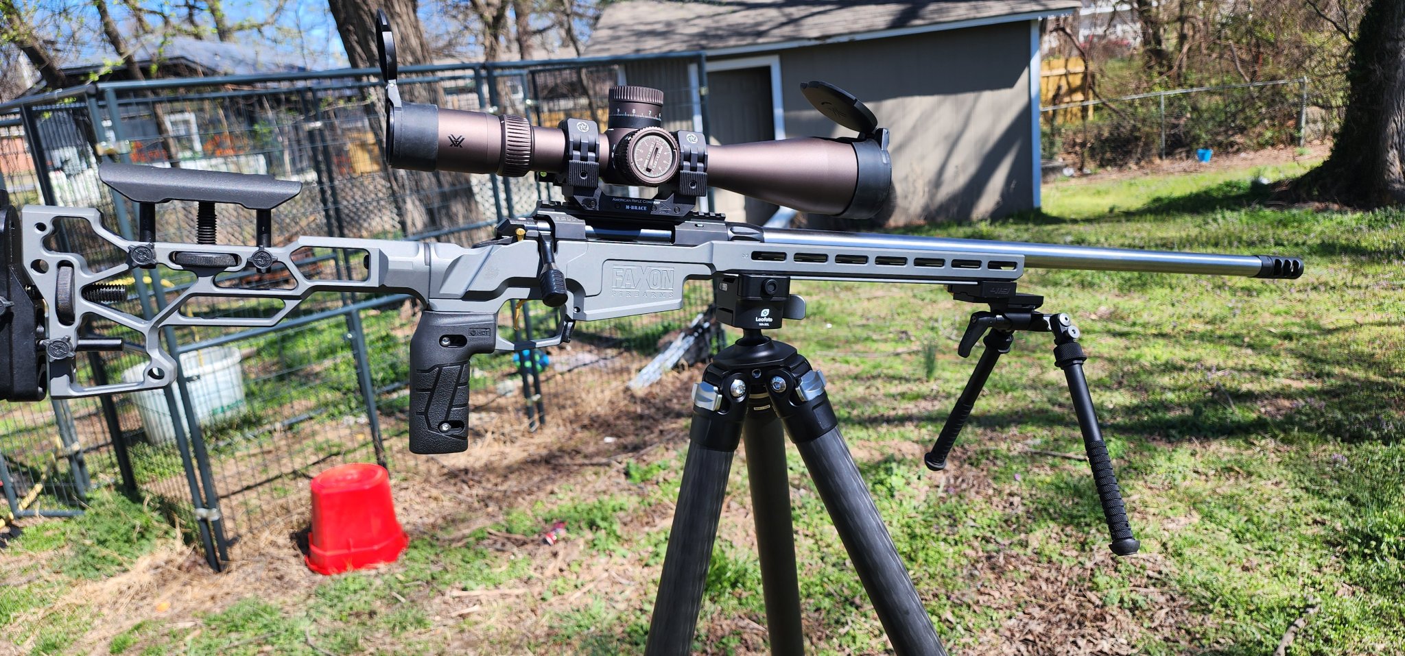

Sub 3# tripods suck to shoot off above low kneeling, it don't matter if Tricer, leofoto or RRS. I own a few rrs, few eofoto, and other Chinesium sold by PVA back in the day. Light weight is cool for packing/glassing, but not good for shooting. I have a leofoto 323C with Sunwayfoto inverted ball head, whole things 3# 11oz, and it still won't shoot at game past 400y standing, thin legs(no matter who makes em) aren't sturdy as the height gets up there.

My Leofoto so-362 is 95% the performance of my RRS 22I for half the money. I however got the RRS for a really good deal. These are both inverted 2 section tripods. Not the best for lower shooting positions, as their hight require legs splayed for seated or low kneeling shooting. However for prs/hunter stuff, they're pretty solid setups.
The above linked leofoto 403C/ma30 combo is the best you're going to do for conventional non-inverted setup, that's prob the jack of all trades, do everything well combo.

22i with anvil is near 6# yes stable. Stable to shoot off of standing? Yes if you have good lock on your anvil near natural poa. I idk if I feel better with a gamechanger atop the Apex, or clipped in with anvil. Under recoil depending on rifle, the bag has its advantages.

The larger diameter Tripod will always be more stable. I do not have a 36mm diameter leg tripod to compare unfortunately. I had a 28, still have a 32mm and variety 40mm. My 32mm setup is sub 4# with Sunwayfoto head, that what I hunt with. I'd venture to say the wobble of the 32mm VS 40mm is 50-75% more when you tap the muzzle or buttstock when clipped in. So your 36mm version is likely in between the two somewhere.

Yes, I have a 40mm 4 section, and a 40mm inverted 2 section. The 2 section is noticeably more stable at standing height.

My 323/ib-30 rig has way more wobble than my RRS33/anvil when clipped in, more than 75% IMO
But when shooting off a game changer on a table (directly mounted to the tripod - no head) I think the difference is way less. It’s more stable IMO then with a head and clipped in to the rifle. I think the ultimate rigidity of the tripod which is always a plus, is a little less critical when shooting off a bag

Agreed. Good natural poa from a bag atop the Tripod Apex has given me the least amount of wobble from high positions. If I'm shooting a lower position where I can get my elbow atop my knee, I think clipped in a slightly better.
I have the Leofoto 364 and their Anvil knockoff. It’s pretty decent, but not the most sturdy for long shots. The Warrior is much better for that.
