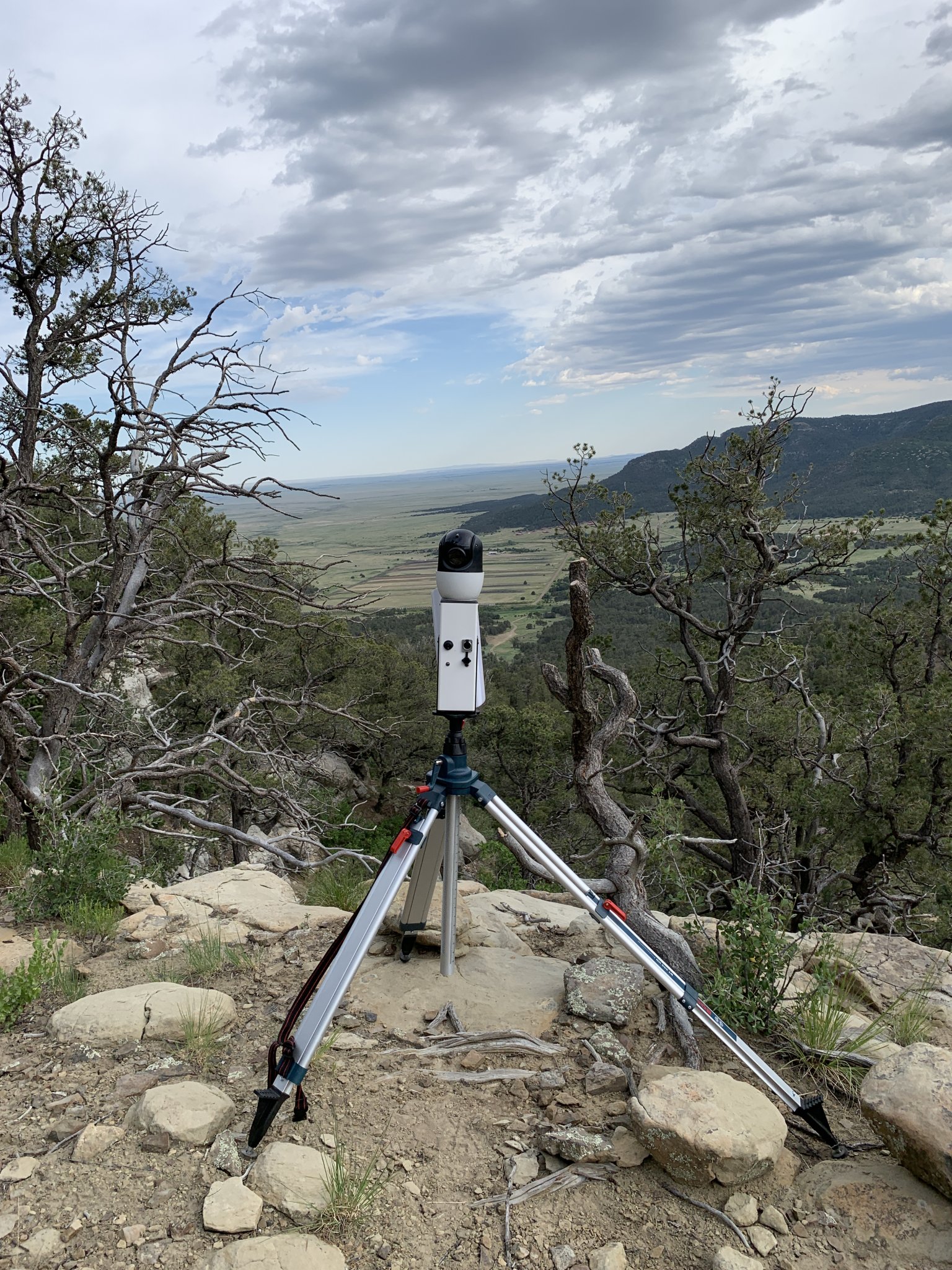

What is that?
This is a system I started building to help with logistics in King of 2 Miles. ELR matches in terrain as rough as ours is demanding and there was nothing else that can do what we need. The pic I posted is of a camera that ran for 2 days straight with an external battery to double its uptime. The PTZ camera allows it to be simply placed on a tripod and aimed from the line. 15x zoom means that it can be 100 to 150 feet away from the target and the microphone gives a satisfying clang on impact.
Been a fun project but it has taken a lot of time to refine. I'm on revision 9 currently and it has gotten a lot lighter and more rugged. The link range is theoretically out to 37Km but I've only used it to 7Km so far. We used it for Paul's 4 mile hit and it was pretty much flawless for the three days we were out there.
It isn't really user friendly enough for the average shooter but I'm working on it.
