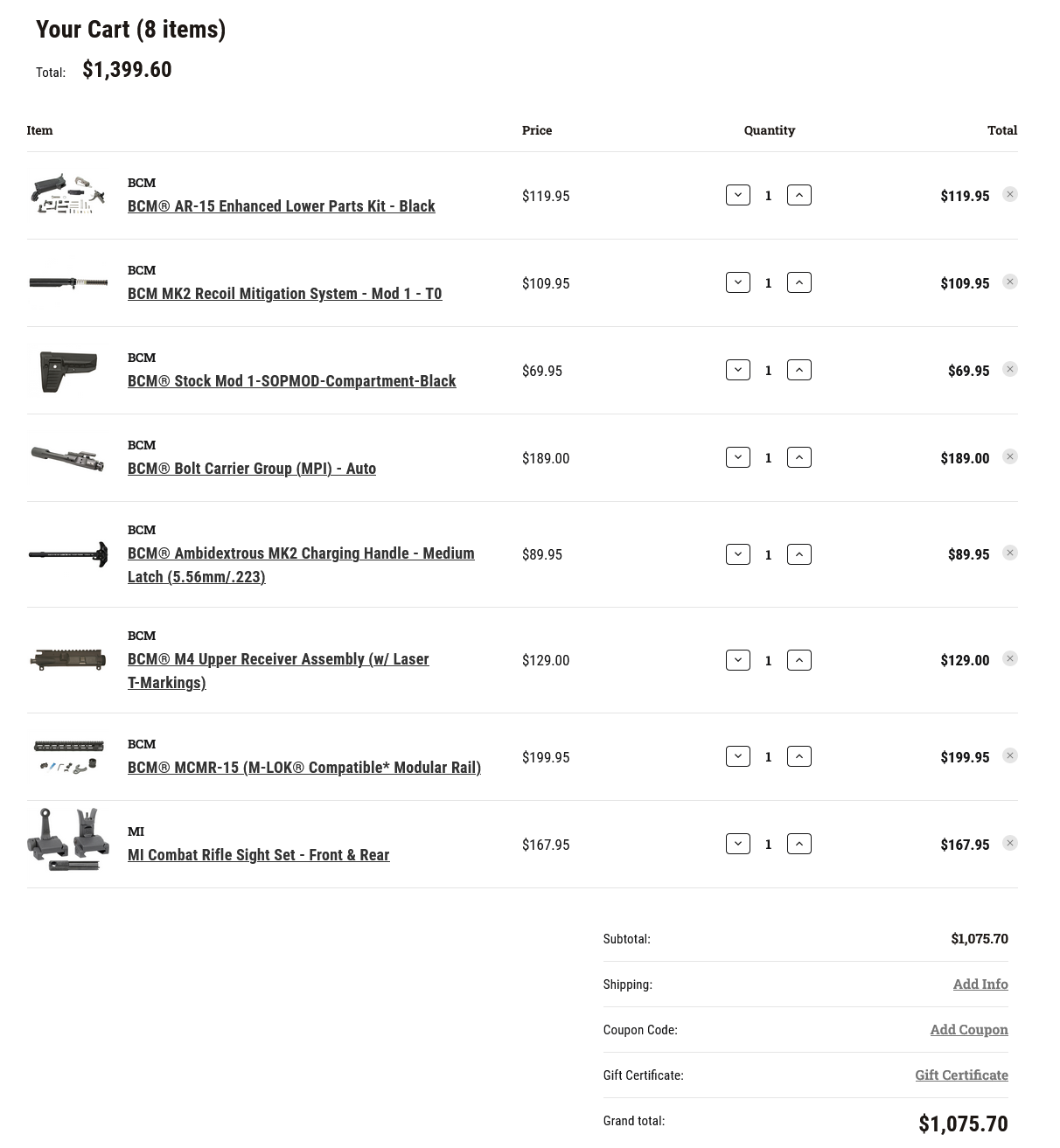

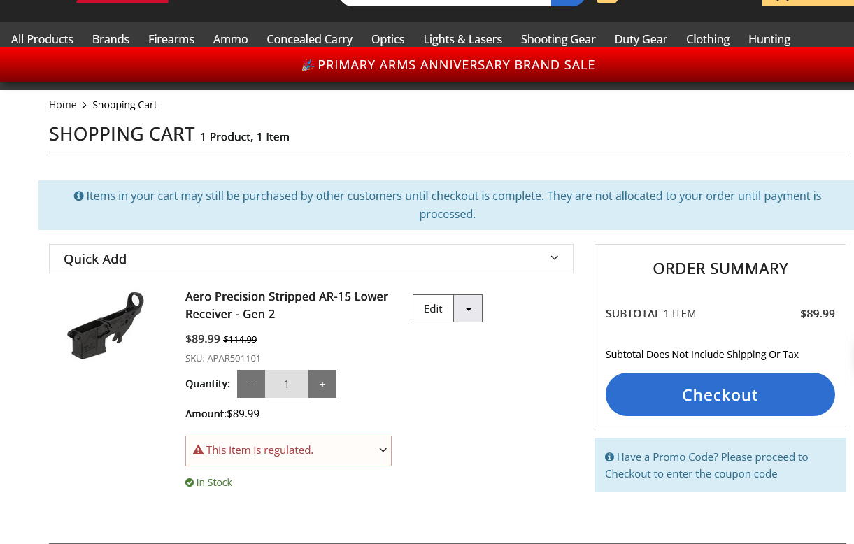

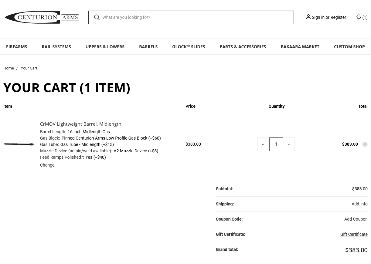

Serious note:
Get one with a good barrel, the rest is just bragging rights. You can buy "Gucci" but you are paying for a rollmark. 16" isn't really going to be a marksman rifle so make it light, slap in a good trigger and go shoot the piss outta it. Guns with no scratches suck.
I'd get a cheap lower, slap my prefered stock on it, yank the trigger for my prefered and then buy the upper with the barrel I want. If I couldn't get the upper config I want, get the parts wherever assemble and go.
Here's a decent recipe for a "hard use" rifle
Make adjustments where you want to the stock or sights or whatever but you'd be the limiting factor on a rifle assembled with the above components and it'll likely stand up to anything you'll ever do to it.
The BCM list above is as good as any for an everyday multi-use, non-precision rifle & their CFH barrels are very good, but none in a 16" intermediate gas length...........in fact I don't know of any readily available AM, 16" chrome lined barrels in intermediate, several are available in SS.
But SOLGW has comparable stuff available.
And I like the Gen 2 AERO lowers & have used several; they generally lock of tight to most uppers as well.
But I would never compromise on any specific part that I wanted to use for the expediency of one-stop shopping, like barrels, uppers/lowers, triggers, BCG's, handguards, GB?AGB's/tubes, muzzle devices & stocks.
