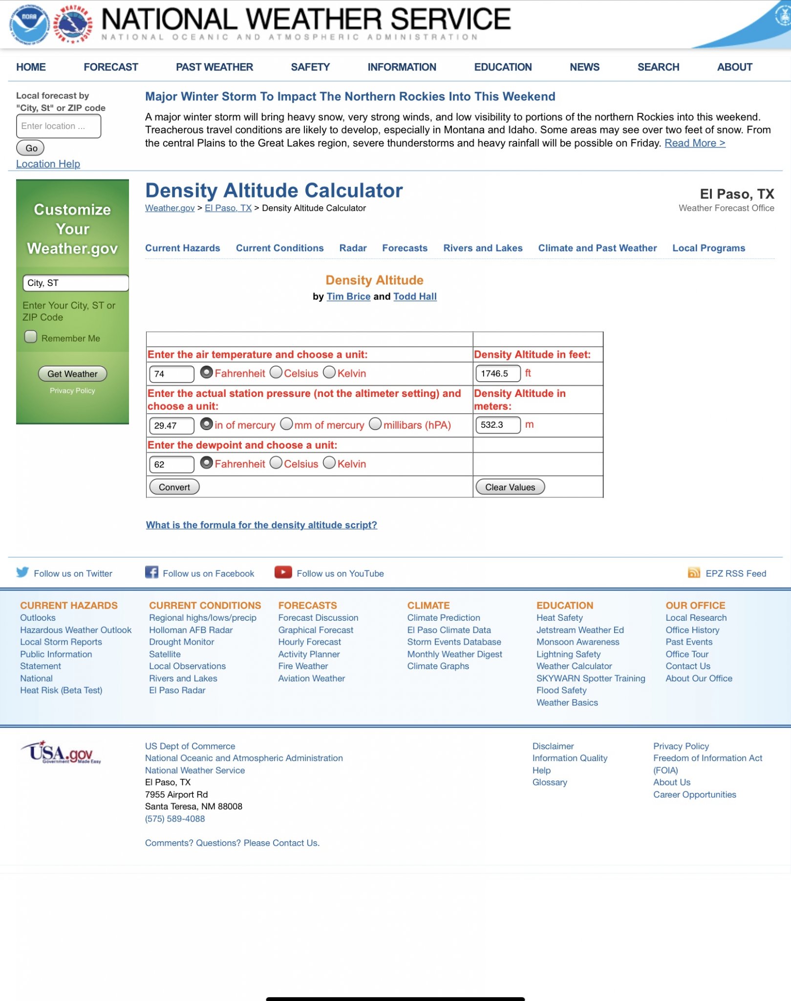

    Double check the online calculator is looking for station pressure input. If you are using an aviation based calculator it likely is looking for corrected pressure which is why you are getting the error. Use this one
    Dead on
    Dead on
