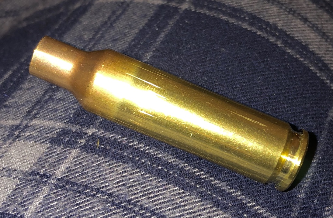

When trying to neck size virgin bagged brass (some necks dinged up), I didn't put any lube on the body of the 6.5CM cases. No resistance... then I noticed longitudinal scratches on cases. Obviously I pushed the cases too far into the FL size die and now there are "lines" of brass solidly adhered to the die wall. While I've been able to chip away a bit of the thicker "line," I need a more efficient method.
My friend & gunsmith recommended strips of 3M abrasive pads wrapped on a cleaning brush, spun with a drill. Amazon will bring the pads - but while waiting, maybe y'all have other ideas / experience.
So - any thoughts (other than "lube your @#$! brass, dimwit") on getting the brass out without trashing the die?
If it scratched the brass all all no matter how far the brass was pushed into the die then there was a problem with the die to begin with. Brass isn't going to damage 60+ Rockwell hardness dies. I can see some major gouging in the die.
To insure clarity - what appears as gouges in the wall of the die are actually "strips" of brass on the wall. As I said, I chipped a bit of one thicker line off. The underlying wall was mirror-smooth. I also wondered if the "strips" were gouges - but a gouge would not leave a fingernail-catching scratch in subsequent cases.
My gunsmith buddy essentially said the same thing as you - the die is really hard, and brass / abresive pads aren't going to hurt it. I'm skeptical that an abrasive approach is going to take out the brass without having some effect on the die, but after 30+ years of friendship and experience, I've learned to pay attention to what he tells me.
Ahh, ok. The picture is just a bit misleading from that angle I suppose. He's right though, green Scotch-Brite pads aren't going to do much to the die, but might grab onto that soft brass, enough to flake it out.
