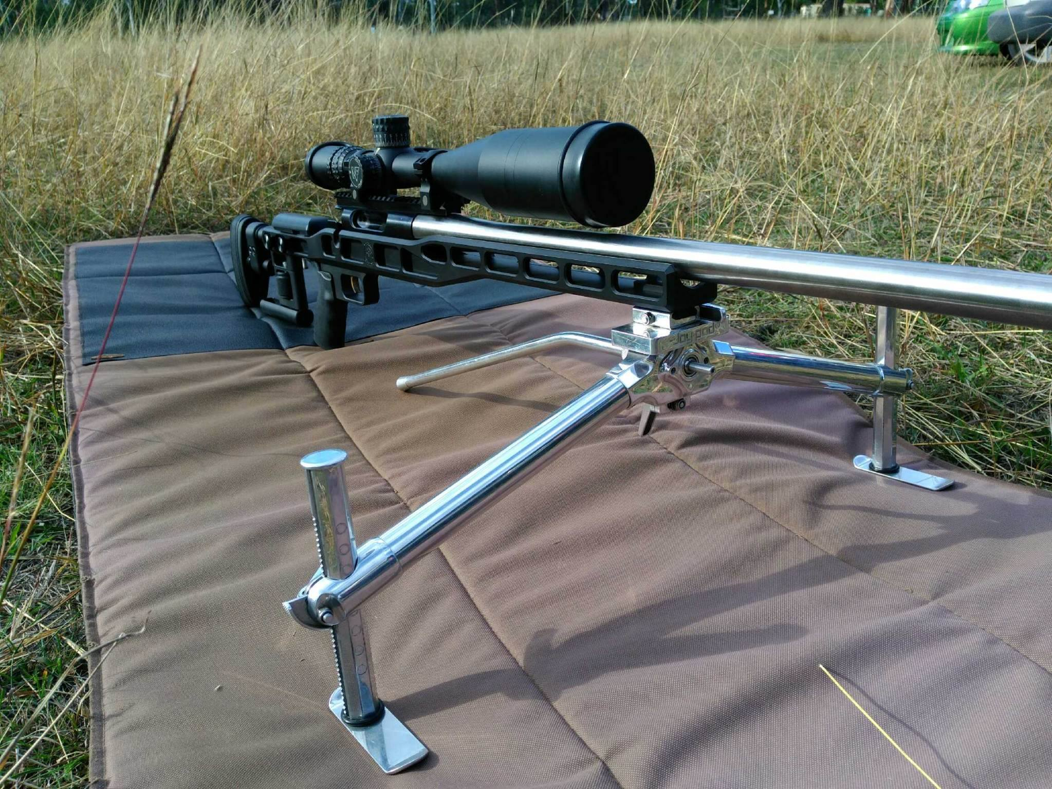

Point 5 is very valid for the F-class stock I posted the photo of above. I was given the maximum weight so weighed all the parts up and modelled the stock and the software had it come in about 100 grams underweight. When it was 90% machined I checked the rules and the weight had to include the bipod. There was a lot of retrospective pocketing involved but it came out around 20 grams under the limit. I think I made about $10 an hour by the time it was all wrapped up :unsure:. It was an interesting project though.

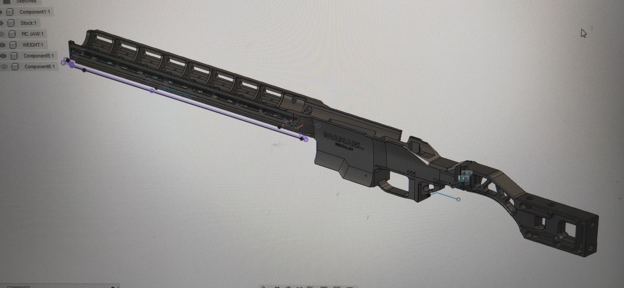

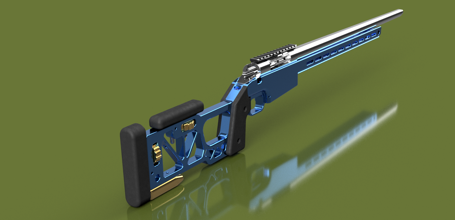

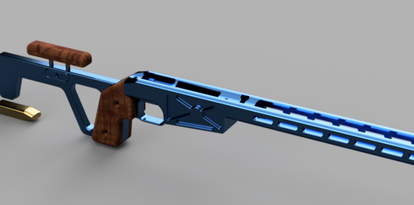

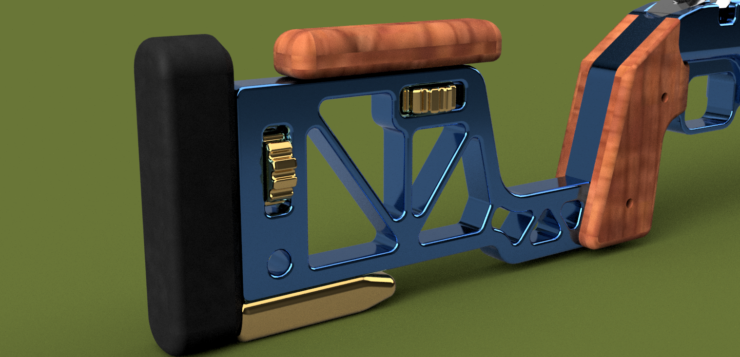

Hi,
In regards to the first 2 images.
Have you ran dynamic simulations in regards to recoil with them?
If not you may want to do that before you spend money and time with the rear buttstock interface as it sits IMO way too low for proper recoil motion.
Can you please advise as to what made you put it at the bottom, other than it only place to put it to not look exactly like Xylo rear buttstock interface?

Thanks for all the replies. To clarify, I do not intend to make a business out of this, it is simply a one-off project. I have a friend that already has a machine shop with CNC equipment making other production level items, so the machining capability is not a problem.
As for pricing, I am not based in the US and after doing a costing, not counting my time, making a one-off chassis for myself would cost less than 1/8th of buying something like an MDT. At the cost of only the material and perhaps a few milling bits, I can't really see a down side.
The idea here is to hopefully find a model and make the necessary changes, yes the main issue is the inletting and may require a few runs on a 3D printer to work out the details before running it out of metal. Fortunately the action is made of round stock so I am considering a "V" cut in the chassis and then mill out the necessary cavities for the trigger, magazine shroud/ mag port and the action holes. Similar to the AI chassis.
This project is still in its infancy, probing whether its worth the hassle. But if all goes well and I do find/or end up making my own model I shall post it here.

To be honest, it's one of a bunch of different styles to try and get away from an AR15 grip. Everything I've made to this point uses one and I wanted to get away from it. The thought behind the low mount was to make it easy to make in 2 pieces and join under the grip so there's no fasteners showing and no real square edges. My mill has 800mm of x travel so I can't machine it all in one go without an extra couple of setups.
I haven't done any simulations at all, it's one of those time-wasters at night instead of watching TV. I've got no plans of making it as a product, I was in business for myself for 20 years and I'm not interested in doing it again. My job gives me 7 days off a fortnight so this is just a hobby now.

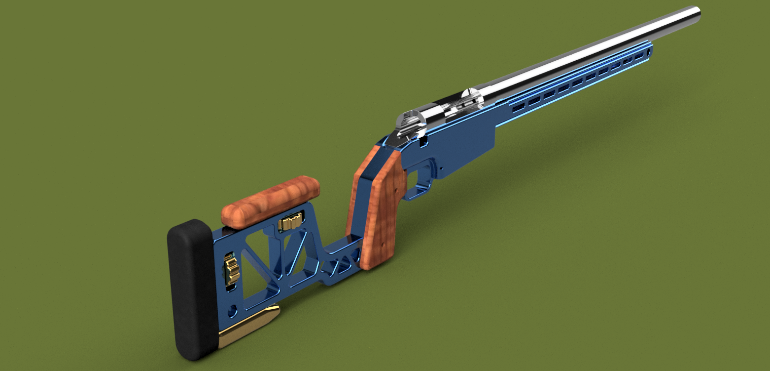

I love the look of the timber grips on the Xylo stock, the whole thing is a real piece of functional industrial art in my opinion.
Here's another version with a "brace" at the top but the "thumbhole" ended up a little low to be really practical or comfortable.

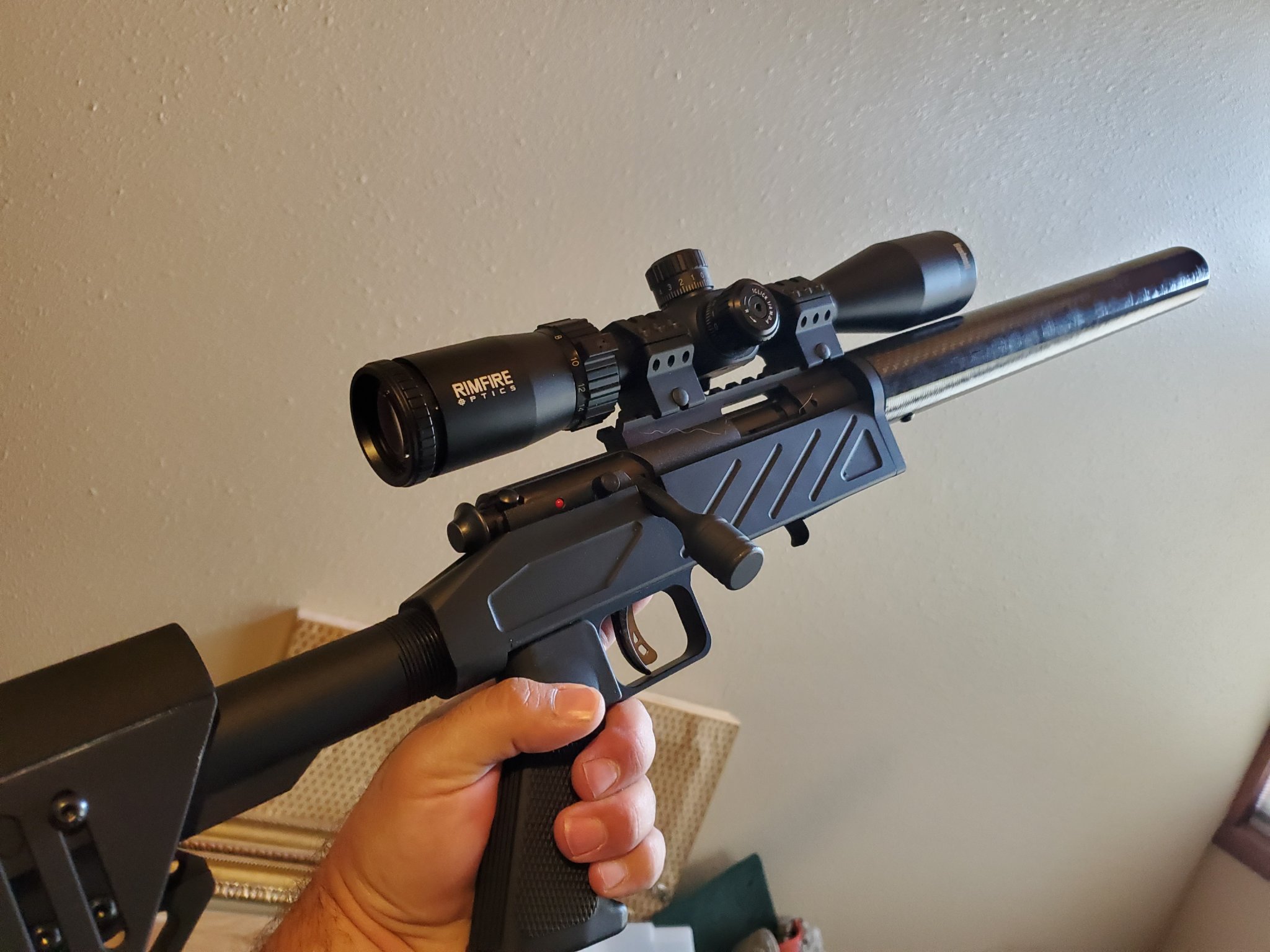

I am neither of those. I did design my own .22 chassis though. 2016-17, there weren't many .22 chassis, and I wanted one. Not too hard if it only needs to fit one gun, and make 1 person happy.
Savage FV-SR. Takes AR stuff obviously. I made another rail to work with full size AR hand guards, but I liked it better with the small diameter hand guard. Runs perfectly. Kids gun now, and it still putting smiles on faces!
I made a TC Contender forend because I wanted one with a rail, in a certain length, and there was absolutely no option out there on the market. It has worked perfectly, but I bet I had about twenty revisions before the final one - easy to do on a 3d printer, maybe harder on CNC. Remington 700 dimensions are pretty easy to run down. It would be pretty simple to design something that took an A2 or M4 buttstock, a little more involved if you want it to be a full chassis (and you need much bigger chunks of aluminum). Chassis prices are what they are because quality design is tough and the machining a few feet of aluminum is out of reach for a bunch of folks. It would be great to see more options out there, especially if it brings the overall prices down.

I love stocks that come off the bottom - been doing builds like that for decades. It’s ludicrously uninformed to think that you’ll need to run simulations to see how it manages recoil.
Provided you can draw a straight line from center muzzle to center breech thru to shoulder pad it doesn’t really matter if there isn’t always material along the way. Thats how kinetic energy works.
Will there be a couple of femto seconds where that energy uses the buttstock-to-handle joint as a fulcrum? Yes. But provided that is a sufficiently stiff joint, thats femto seconds. Then everything gets absorbed by the shooters mass.
You should be able to watch your rounds hit through the scope without needing to re-aquire the target.
