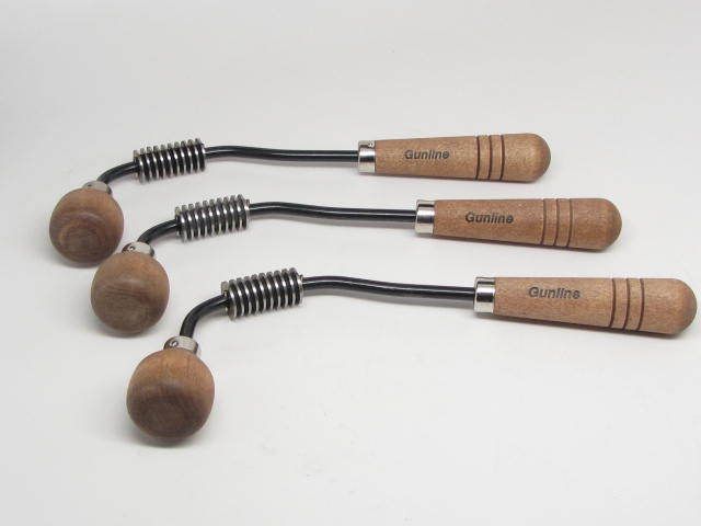

    Better yet, get a set of Gunline Barrel channel tools. They aren't that expensive, and they'll do a professional job.

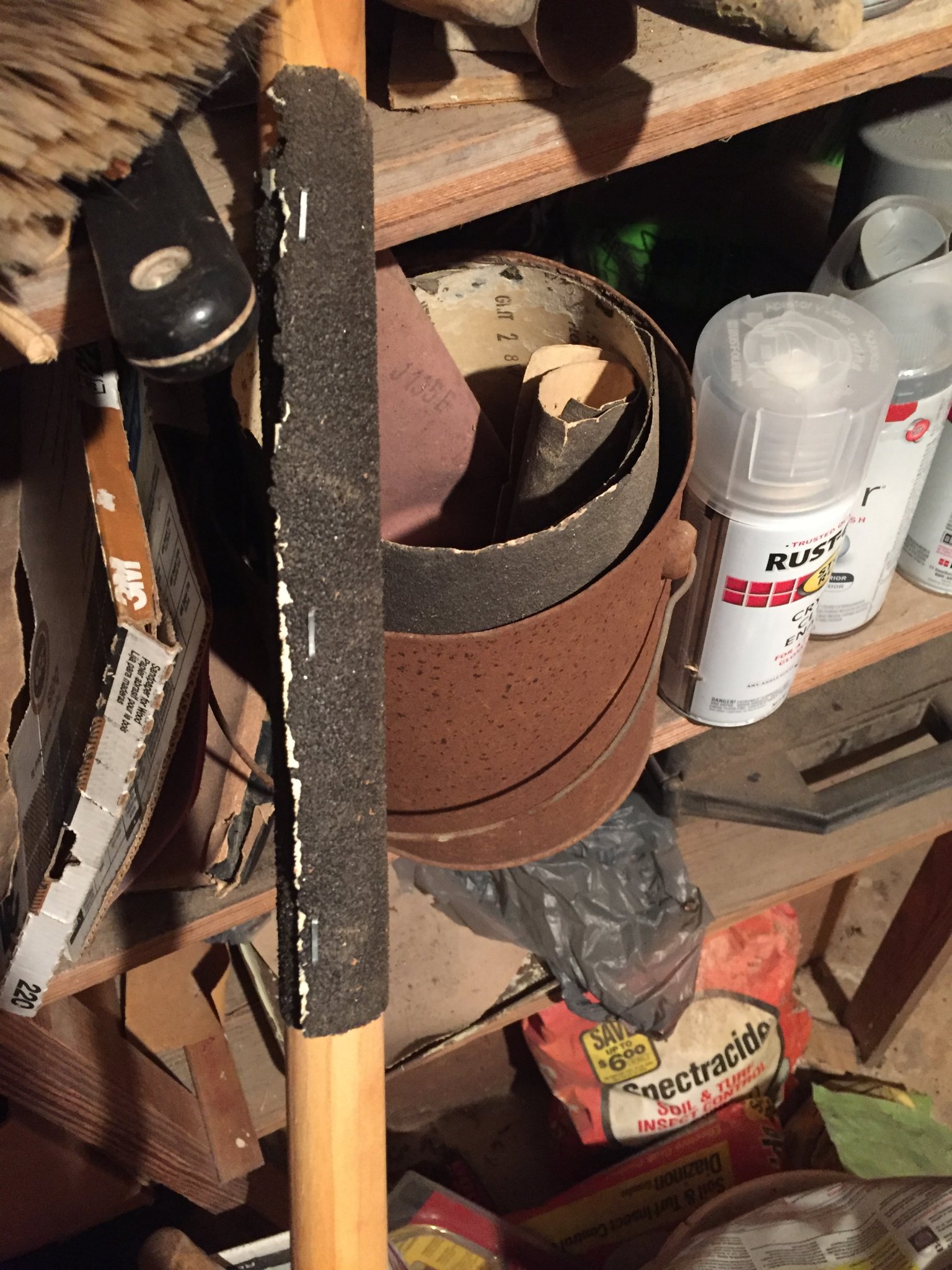

    Get some gritty sand paper and wrap it around a dowel.
    I have some 2 grit, yes single digit, from my grandfather still and it makes quicker work than a dremel.
    I lay the barreled action centered in the stock and using calipers with a layer of tape on the jaws to not scratch the stainless or bluing I will close them around the barrel and pressing down lightly into the wood I will run it the length of the stock. It scribes the exact diameter of the barrel so you know the minimum that you need to sand out.

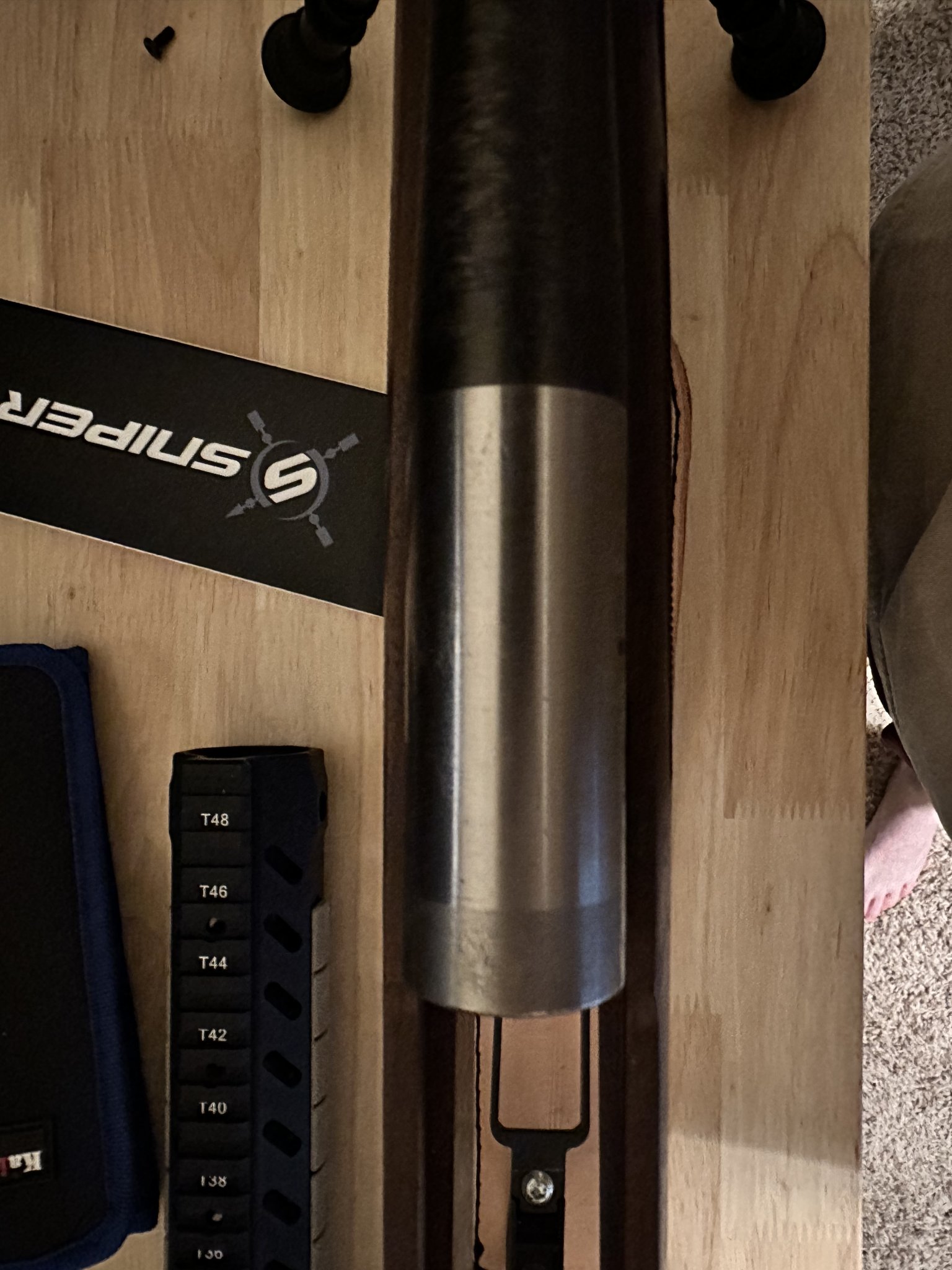

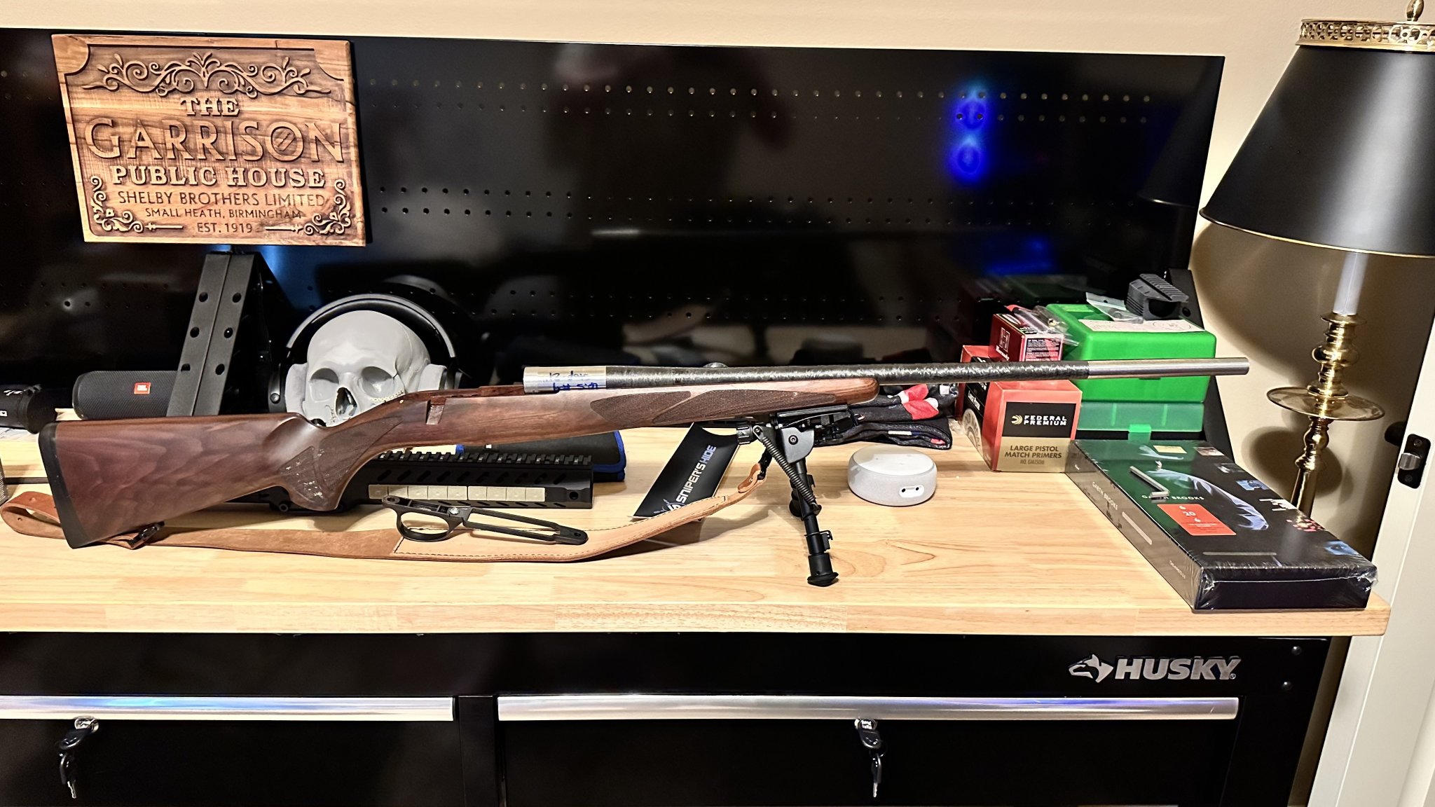

    Resurrecting this thread. Changed plans. Had LRI open up the bolt face to take a 6.5PRC. Have a ragged hole Wilson #4 carbon wrapped finished at .685 at the muzzle. Am looking to rebarrel to 6.5PRC/SI. Obviously the chamber will much more forward than i have it sitting. My question is do yall think i have to take away too much of the stock to fit it? Once the shank has been threaded and attaches to the action it should be alright i would think.
    Sure looks that way to me- but the angle of your photo makes it impossible to tell definitively as the barrel isn't placed in it's actual location.
    The cylinder looks much longer and will extend into what looks like a light sporter taper on the stock which could kill the deal right there.
    Everyone has their own level of tolerance with this- I don't like any less than 1/8" at the top line of the stock, which is typically the biggest issue at the muzzle end of the stock which you're not showing.
    Not rocket science- take calipers and measure across several areas of the barrel (shank for full length, transition, taper) then compare against the same areas on the stock. I put painters tape across the top edge of the stock, and mark the areas which correspond to the same areas where the barrel will actually sit.
    I have cheated on occasion, by lowering the stock line slightly along the barrel which obviously thickens the wood exposed at the top
    Reactions: 5RWill
    Yeah it's moved back into the action recess. If i set it where the shank would actually be it tips forward off of the stock. I've seen sever 700s rebarreled with proofs which are much much thicker. Granted it was thin and some did have to lower the forend.
