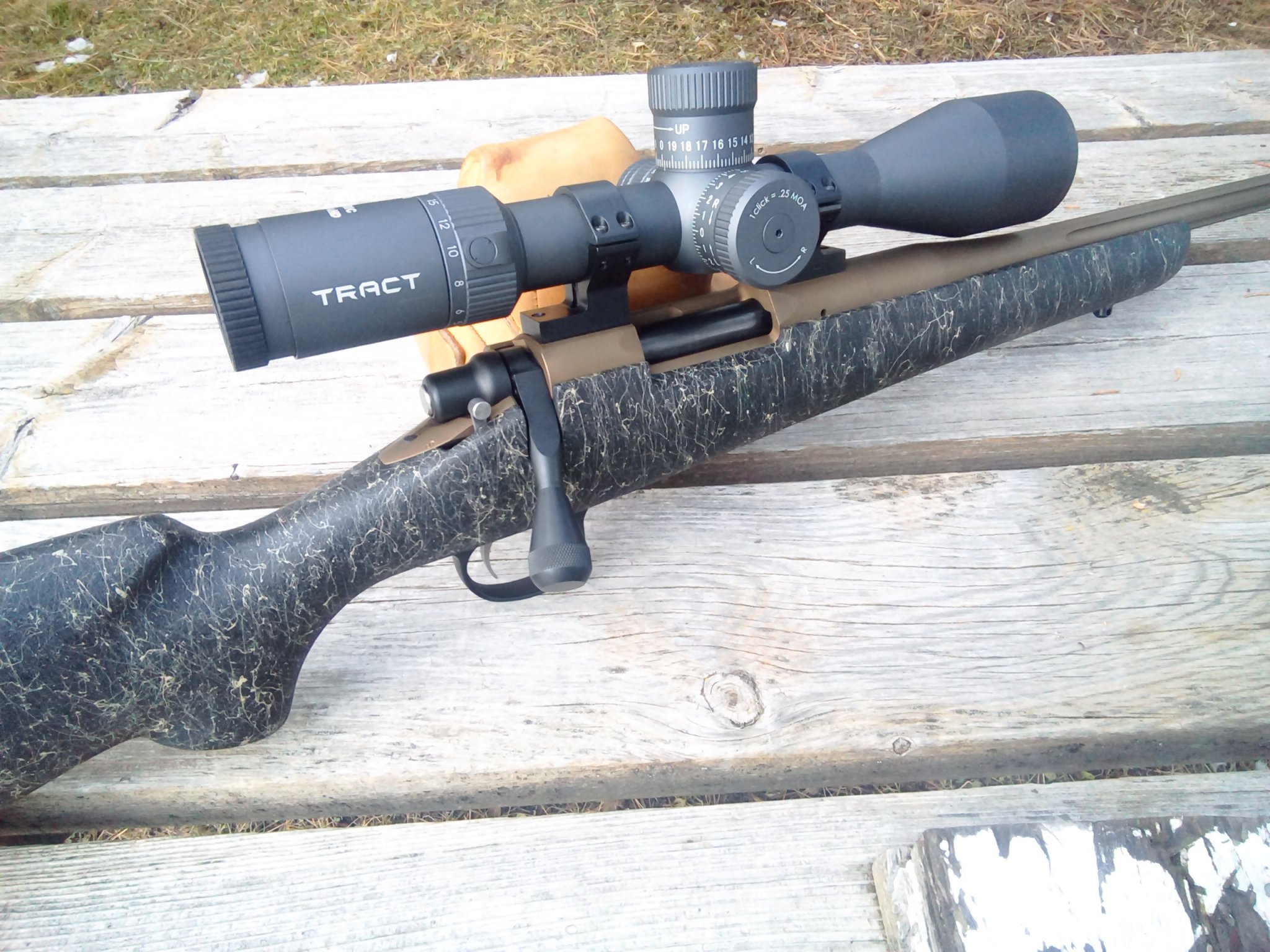

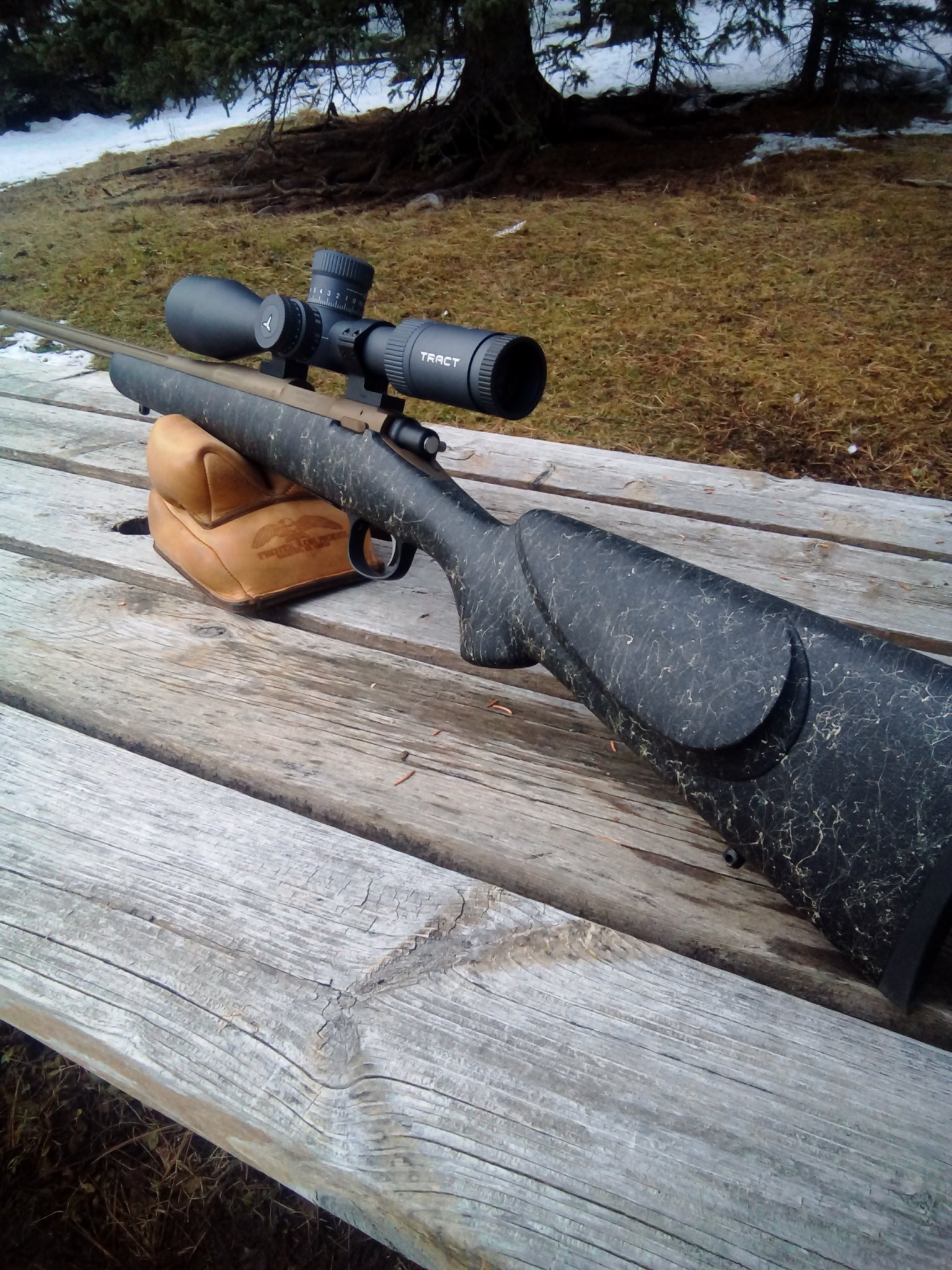

I used a Rem. 700/223 action for this Valkyrie build. Bored the bolt face out, ptg sako conversion, ptg bolt handle, time and tig. Simple enough conversion. I did end up reforming the Remington magazine box in order to get 100% reliable feeding with the Valkyrie cartridge.
As made by Remington the 223 magazine box will not feed the 224 Valkyrie 100% reliably. Perfect feeding starts with a perfect stack. In order to achieve the perfect stack and thus perfect feed I ended up opening up the box .015 per side at the shoulders of the case. This was done because the Valkyrie cases where bound up at the shoulders causing the case heads to float causing inconsistency in pick up. Spreading the stack at the shoulders of the case allows the case heads to rise properly where they can be picked up 100% with each cycle of the bolt. Properly built accurate rifles must also be 100% reliable thru feed and function.
