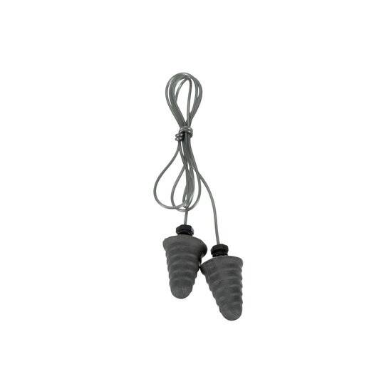

For plugs, I use Decibulls molded earplugs with the rubber in-ear thingies installed (the multi-tiered rubber like the old orange military plugs). No valve in those; they're rated at 31NRR. They're considerably more comfortable, more effective, and maintain a WAY better seal than the Surefire ones I used to use.

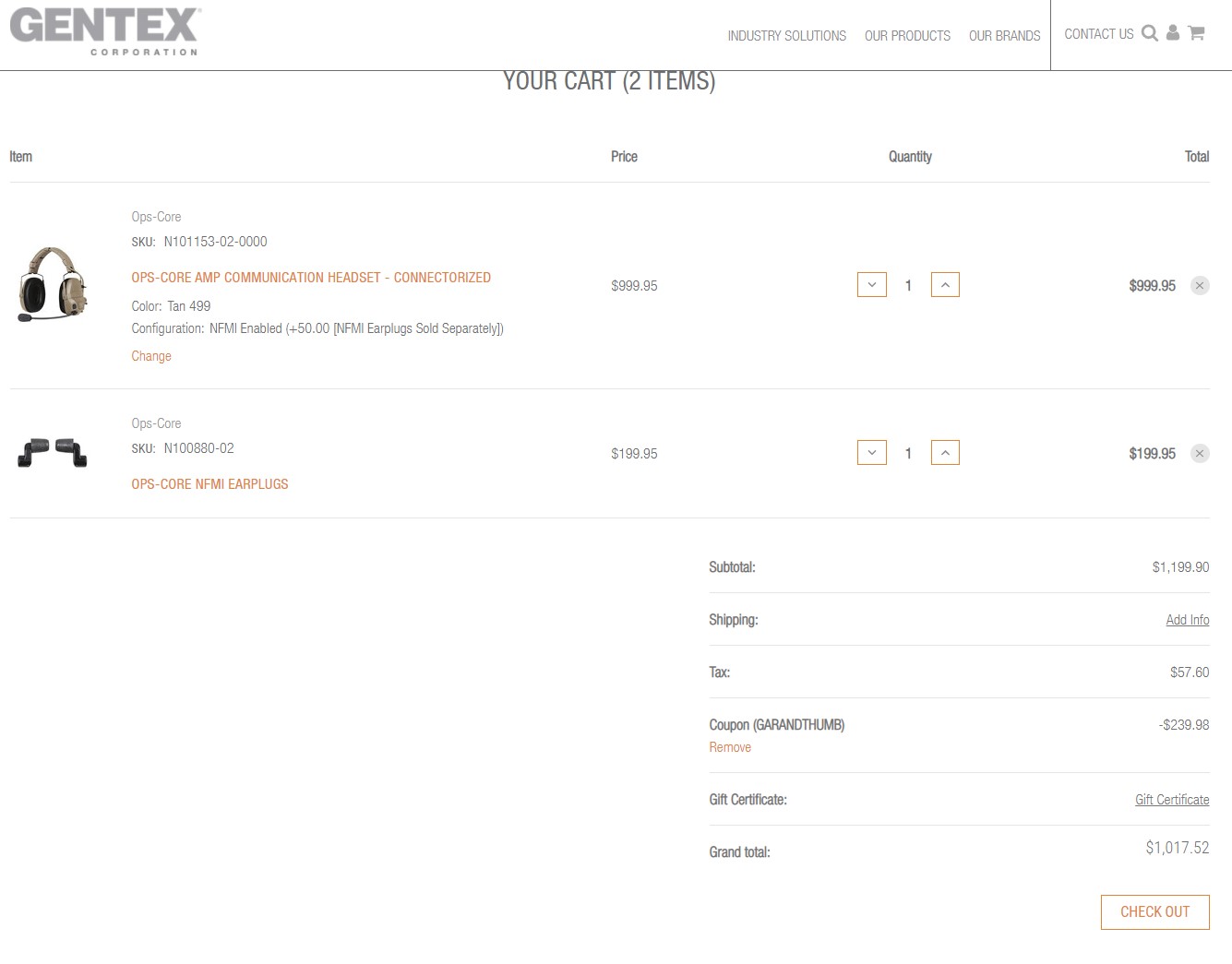

Used the code for the amps with the nfmi plugs, have shot two matches with them.
They check all of the boxes for me in providing good attenuation around brakes as well as with eerily good sound reproduction (the nfmi is almost like black magic). Basically, I wanted more noise reduction around braked guns vs my previous sordins + ear defenders.
