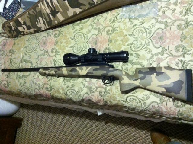

I just built a 243 off a Stevens action. I went CBI .243 Match chamber 1/8 twist Barrell, choate stock(required ALOT of work to make it right) and rifle basis trigger. I shoot 95smk's and I LOVE shooting it to 600 yards...as well as punching paper. I never thought I'd be such a fan of 243 (I bought the Barrell in that chamber primarily because it was instock) but I'm having so much fun with it I think I'll always has a .243 bull in my safe!

Big thanks to everyone, I greatly appreciate all the input.
So here is the update:
Stiller Tac30 action
Brux #5 barrel
Timney trigger
Remington BDL bottom metal
Everything will be at the gunsmith Friday except the stock.
Stock: I found two that I like and are lightweight. Manner EH-2 26 oz(I emailed Matt at Manner to determine how much the inlet will need to be milled since it a prefab stock and not a built stock) Second choice is the prefab McMillan Ultralight A3 Sporter 23oz. Spoke to Mcmillan #5 should work fine in it.
I should be shooting it in about 5 weeks!:)
Found a stock, had it cerakoted two weeks ago and I picked up the finished rifle today. I really like it and it's super light. On the bathroom scale it adds 5 LBS to my weight without the scope. I'll see how it shoots tomorrow. I'll try to post pictures soon.
Here is a picture, and it shoots great.
