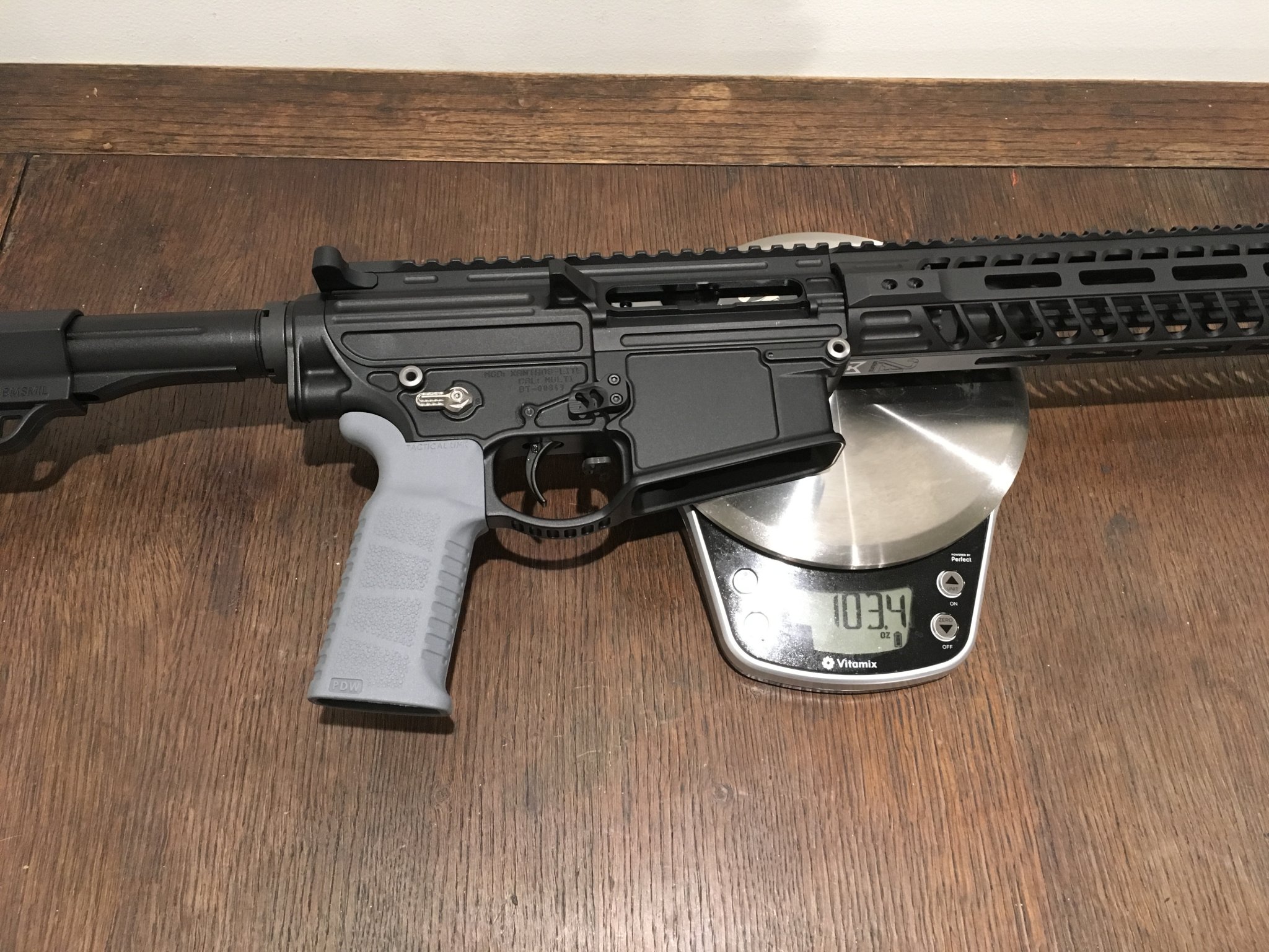

My 20” Faxon fluted match runs Barns 127 LRX at 2930 fps with RL16. 6.5# without optics. Lots of titanium in that one.
