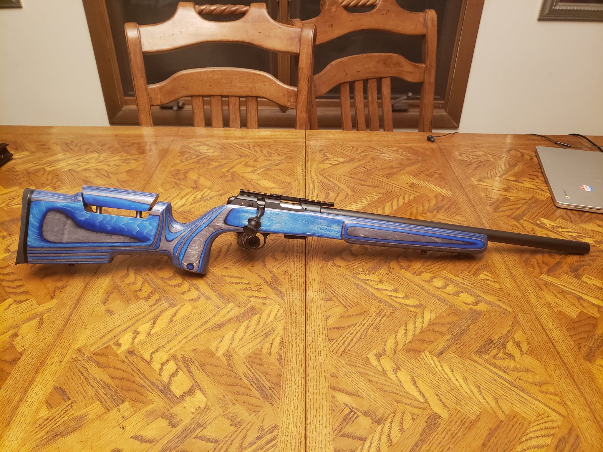

CZ 457 Varmint. I needed a higher comb for good cheek weld on an Athlon with 50 mm objective. Rather than modifying my factory stock, I went with the flashy version of the Pro Vamint. Action/barrel fit was good but barrel was slightly left of center. It's now with Alex Sitman at Master Class Stocks getting pillars and bedded.
Happy with it so far, but the proof will be how well it shoots.
