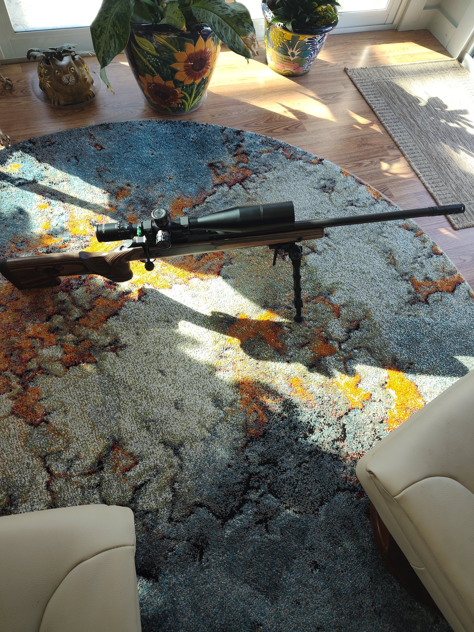

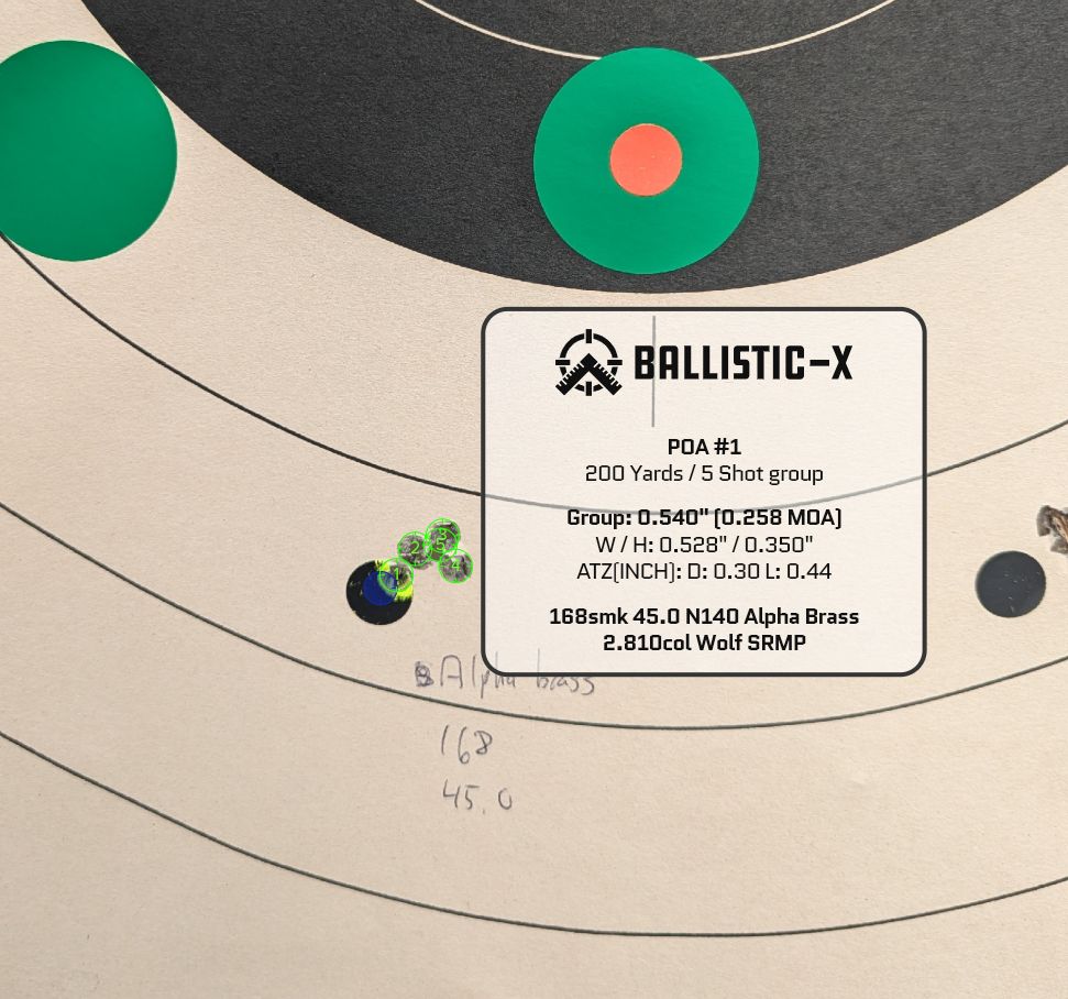

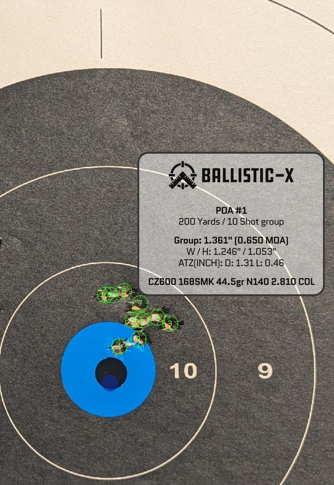

I purchased my CZ600 ST2 Range in 308 last month off of Gunbroker for $999+ shipping and tax after the CZ $100 rebate.
I was going to post my own review thread: long story short the rifle is OUTSTANDING for the money. I use this rifle for mid-range 600yd matches shooting in the F TR category.
CZ factory guarantee is 0.75 MOA. My very 1st 5shot group after I got the scope sighted in was 0.65 MOA using 168gr SMKs and 44.0gr N140.
Accuracy is exceptional. Shooting off a Harris bipod and rear bag, 10 shoot groups are routinely less than 0.75MOA. I just shot the best groups of my life last week, 0.25MOA using 168SMK and 45.0gr N140 in Alpha SRP brass with Wolf magnum primers. Numerous different loads, both factory and handloads, print sub 0.75MOA for 10 shot groups.
I have tried Norma Golden Target 175gr, FGMM 168gr, Berger 175 OTMs, 155 Palma seconds from Midway, and 178ELDMs, all giving groups in 0.75MOA or less. The only thing my rifle doesn't like so far is Hornady 168ELDM; I haven't found a consistent load yet that will stay under MOA for 10 rounds
The trigger is exceptional with zero takeup. I have mine set to 1.5lbs. The bolt is extremely fast and slick with a 60 degree throw. No issues with jamming when feeding from the magazine.
The only "downside" is zero aftermarket parts. But considering you don't need a new stock or trigger, the lack of parts isn't a issue if unless you simply like to tinker with your guns.

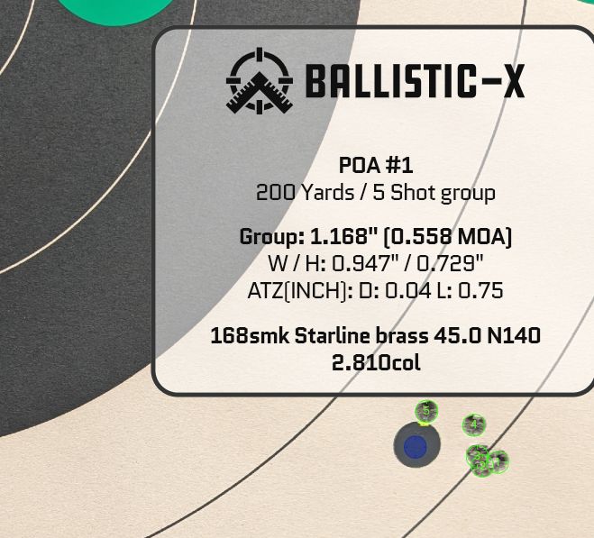

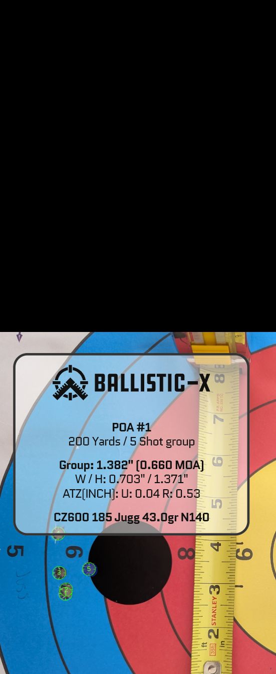

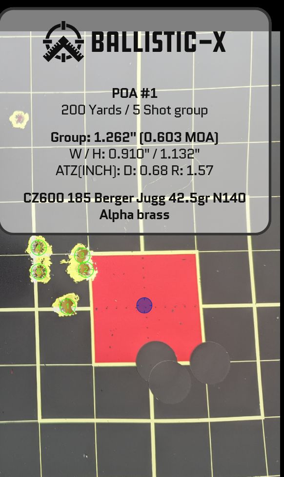

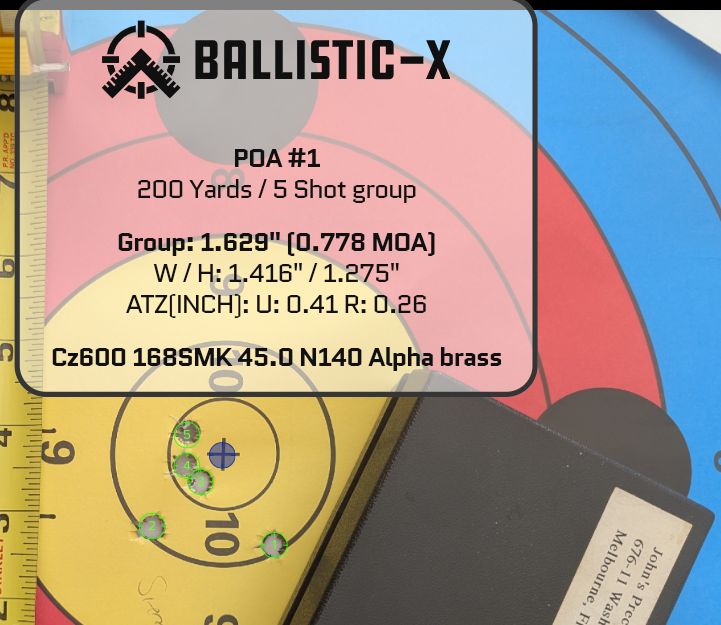

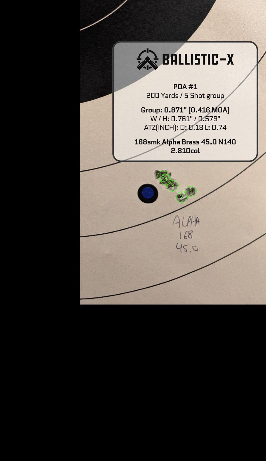

Made it to the range today with the CZ600. Only had 15 rounds to shoot. 1st group was completely cold bore - 0.778MOA with 168smks.
Moved on to 185gr Berger Juggernauts - 0.660 and 0.603moa with zero load development.
CZ600 Range has been nothing but impressive so far. The only bullet my rifle wont shoot so far is 168gr Hornady ELDM.

Good shooting buddy. Mine shoots the first shot just as good as the rest. No cold bore flyer here.
I don't reload so if you do I bet you can close them up a little more . Before you know it you'll be buying another gun because it will become to easy. Enjoy it while you can.

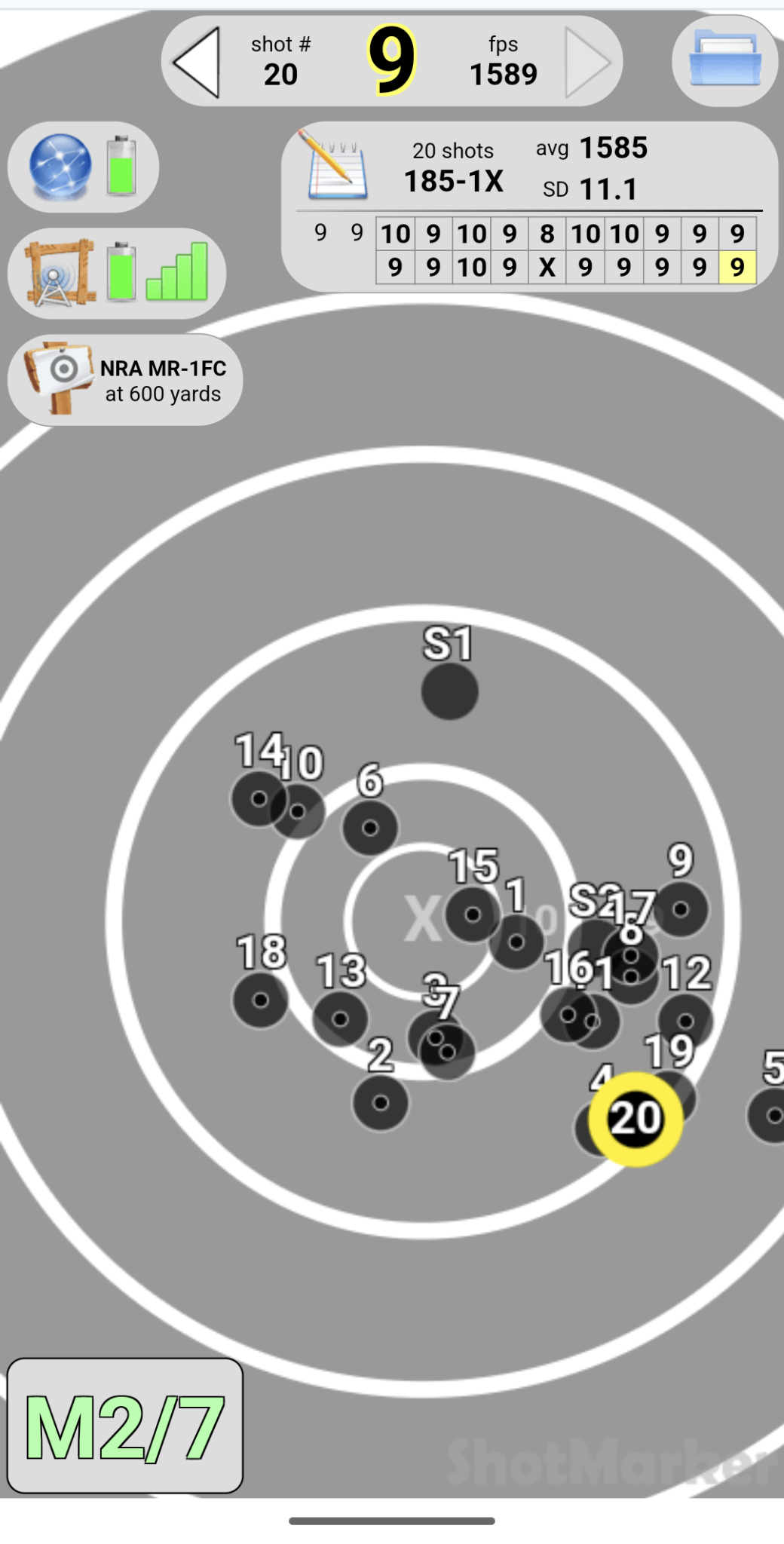

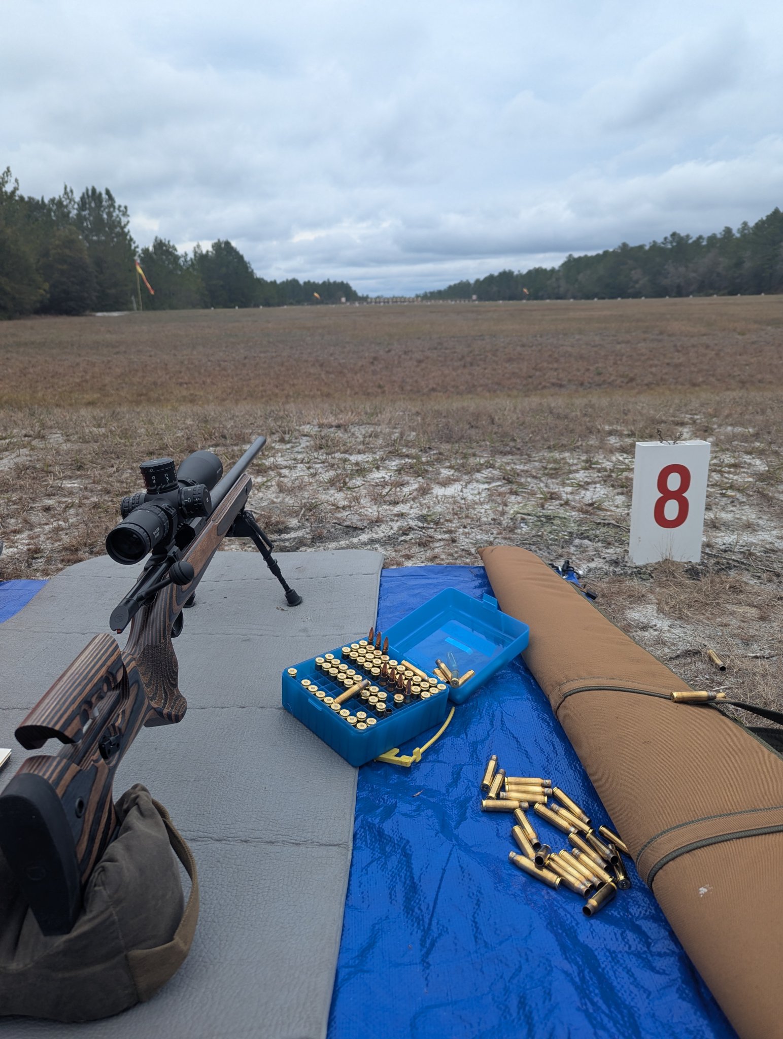

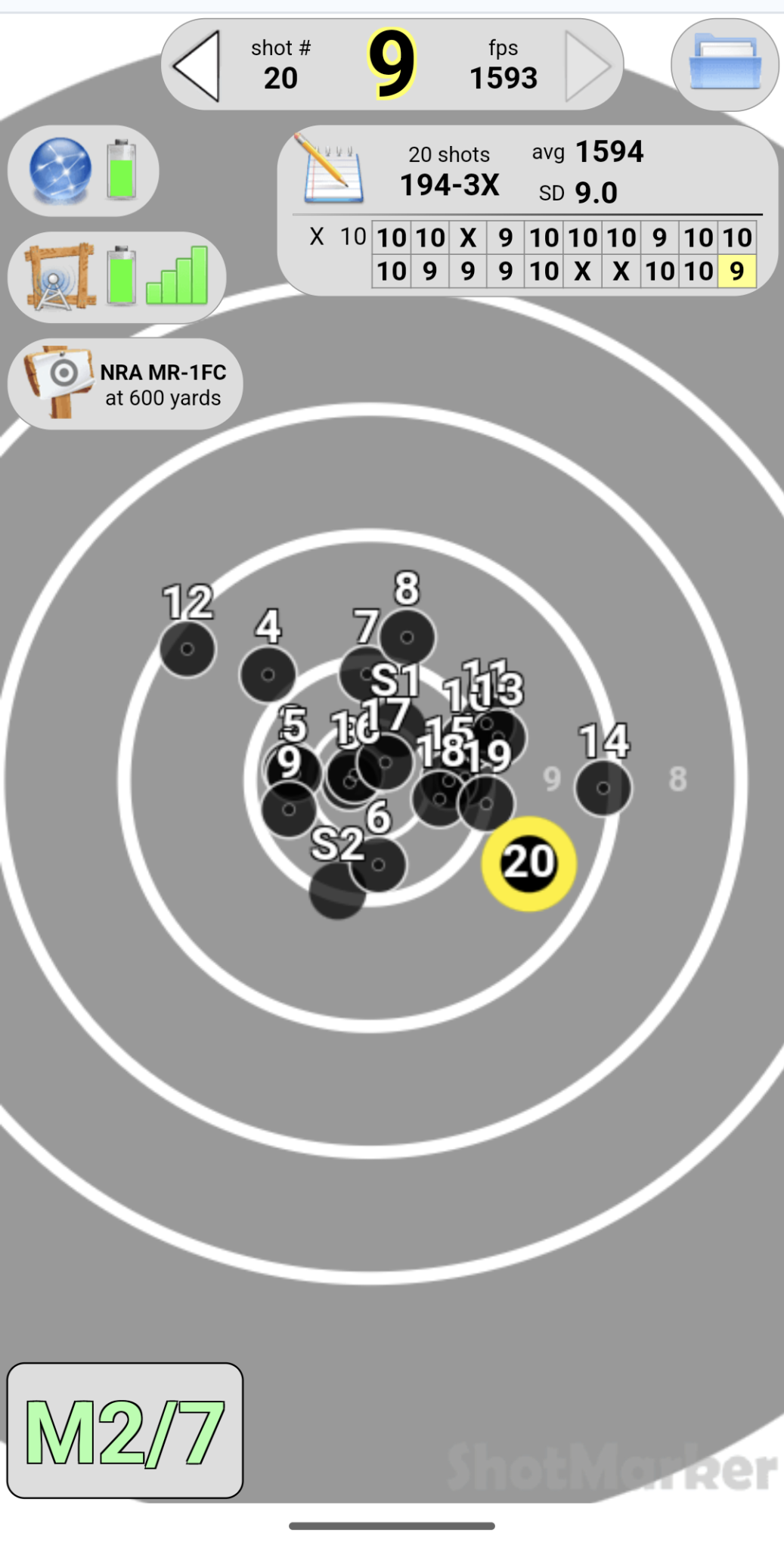

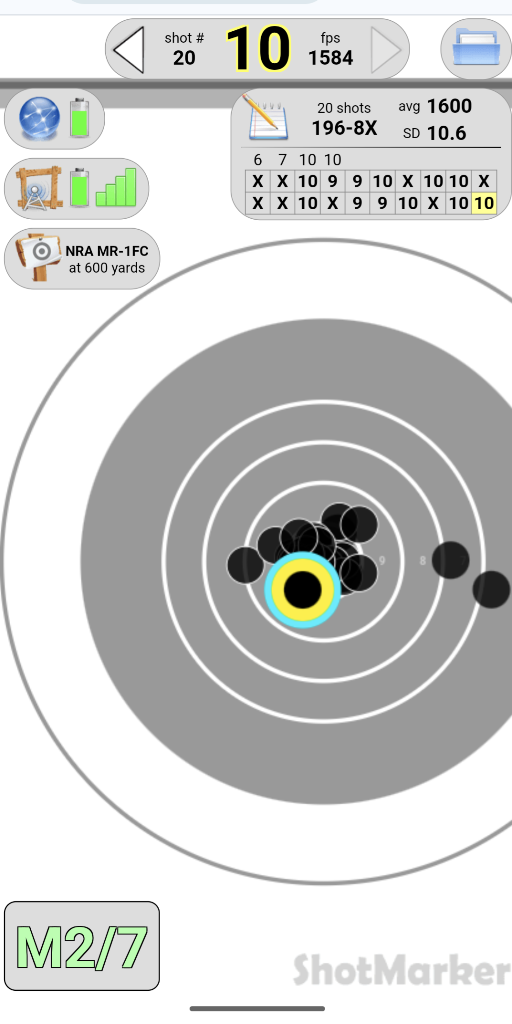

Shot the CZ600 today in a 600 yard "mid-range" 3x20 match in the FTR class using a Harris bipod and a Armageddon rear bag. 10 ring is 1MOA and X ring is 0.5MOA.
I used my match load of 168SMK, 45.0gr N140, and Alpha brass with Wolf SRPM. MV right at 2700fps.
Cold with gusty winds made it challenging. The first 2 strings were excellent. Last string dropped more points than all the others combined due to a switching wind. Good times were had by all!

Nice. What was the average group?
We shot 3 20 round strings at 600yds. 1st 20 round string only 4 shots were outside of the 1MOA 10 ring. 2nd 20 round string 6 rounds were outside the 1MOA 10 ring. 3rd 20rd string was not good and only had 6 rounds inside the 10 ring. Wind had really picked up for that third string and everyone had a tough time.

Petersons SRP brass
Federal match SR primers
N-540 powder (43.7gr @ 2,750…have to check data log to verify)
SalmonRiver solutions SS brake
Easily sub-moa… i shoot monthly steel challenge matches out to 600y, it gives nothing up to the guys with custom rifles…. I’ve finished top 3 in the last 6-8 matches…..
