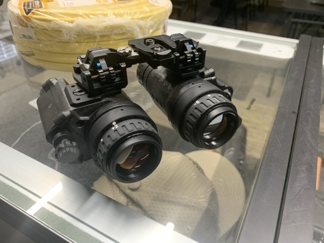

Have the wilcox bridge and have run it with one PVS14 and a IR Patrol as well as two PVS14s. Overall a good system that I generally now run with the dual 14s.
That being said, it is heavy. I run a good bit of counterweight on a bump helmet. I went with the wilcox to be able to split things up easily and because I was able to buy one extra skeet-ir arm and flip it over to move the patrol out a bit further away from the face (this lines up the ocular lenses better). If I did not want to maintain the ability to run the patrol even with a PVS14 I would consider a lighter option.

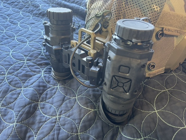

I do run the wilcox wired setup. Don't really use the buttons though. Live in somewhat rural area so no need to kill them quick. Sometimes when I'm walking out of the woods into a lit area I turn the switches on the units off and then hit the buttons just to be sure, mainly because they are there.
Different brand arms also impact how close or far the ocular sits from the face. I have never owned anything else and have no complaints about mine, but for weight/counterbalance I have wondered how much it would impact the feel of the helmet on the head if I had different ones. Ex: J arm that has ocular a bit farther away allows the G22 (in my case) to be run a bit closer in to the helmet reducing leverage. Just been too lazy/poor to try it out.
Reactions: commandernavi
Interesting. I would have assumed that the shoes they would have made for that would be able to make it sit pretty square. Is it just annoying because it's rotated slightly and the view through the thermal is a rectangle so doesn't sit parallel to the ground?
basically. Even worse than a box and a circle, you have a canted box and a circle.
