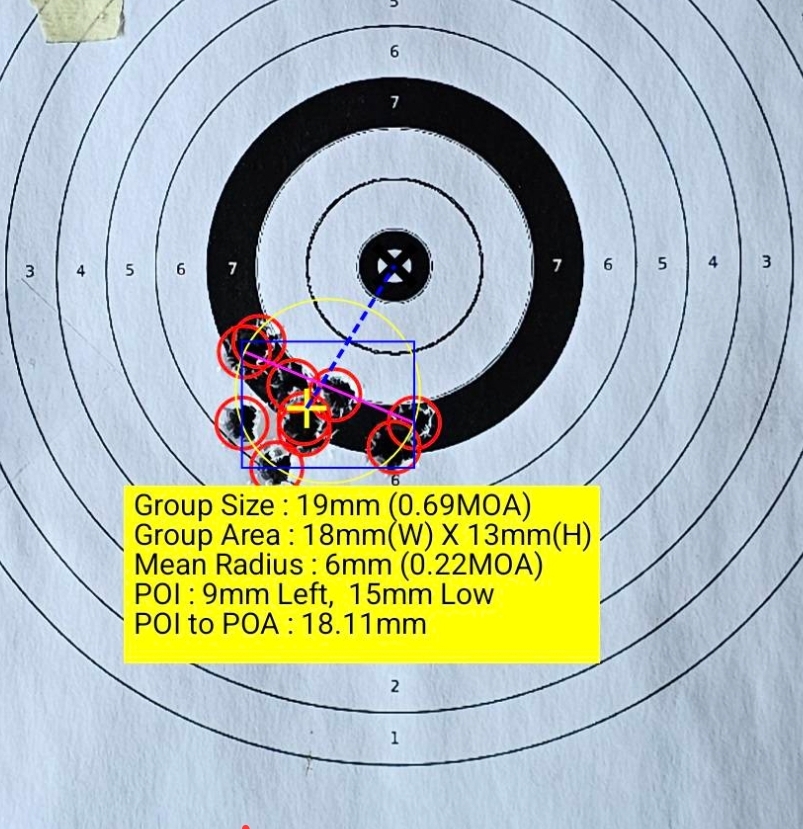

This is the latest group of 10. I have no clue why my zero is off, I certainly did not freaking rezero it "quickly" to the wrong direction by any chance..
The first 5 shots went really well, the 2 on the right are a bit of me during last rounds.
