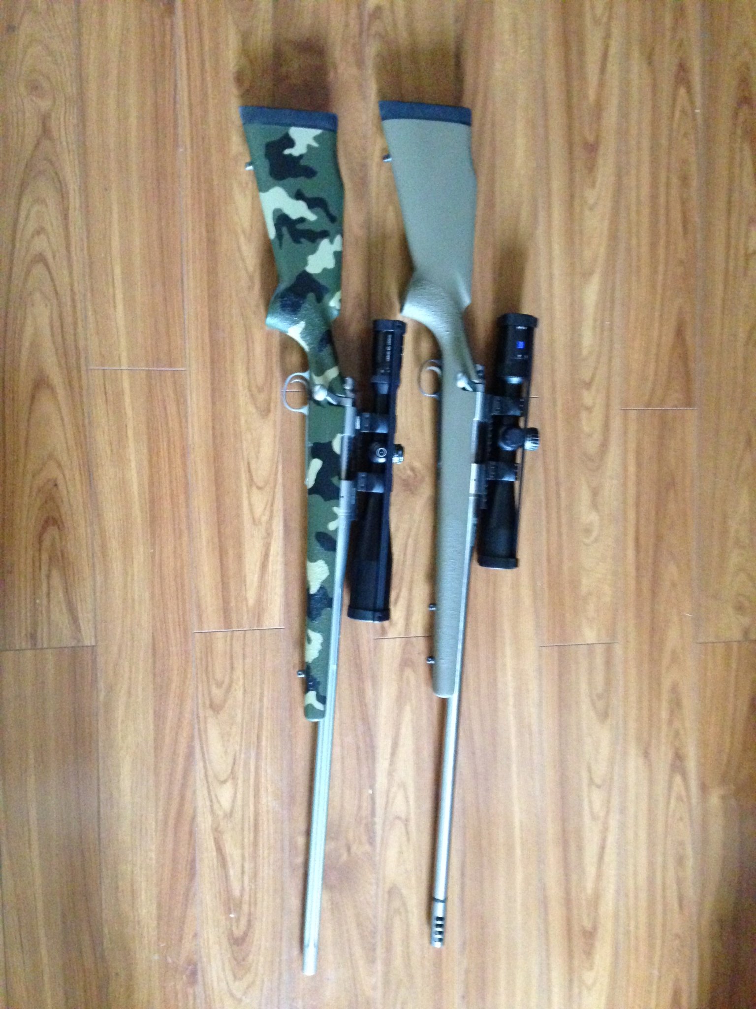

Maybe apples to oranges, but I have a 3x12 v4 and really like it so far. Mine is on a RAP 308 in warne rings. Tracking has been perfect from 100 yard zero to 500 for the first 50 rounds.
I can't comment on durability thus far, but I would think a Zeiss is going to do just fine.

I had a Zeiss COnquest V4 4-16x moa/moa ...
I picked it because it was sort of a "Tactical-Hunting" scope :D
It has zero stop ... which most "hunting" scopes do not ...but which I need if I will dial at night. And I do most of my shooting/critter control at night.
And it had parallax and illum. And it was light enough and short enuff also. So it checked all my boxes.
I lost the battery cap and Zeiss USA replaced it quickly for free, so I had one positive experience with their CS.
I found it very effective in the critter control role and took out many coons opossum and yotes with it ...
My only issue was I found the 4x on the bottom to be too much .. I really need 2.5x or below on the bottom ...as you can see the edges of the display are clipped a little by the 4x in the above pic with the thermal clipon. So I sold the Zeiss and the ATACR 4-16x I had and replaced one of them with a NF NX8 2.5-20x ... to pull in the 2.5x part ... might replace the other one with a Trijicon Credo 2-10x
But I found the Zeiss to be totally fine ... and no issues except me loose the battery cap, which again they replaced for free quickly. I was impress with the CS.
