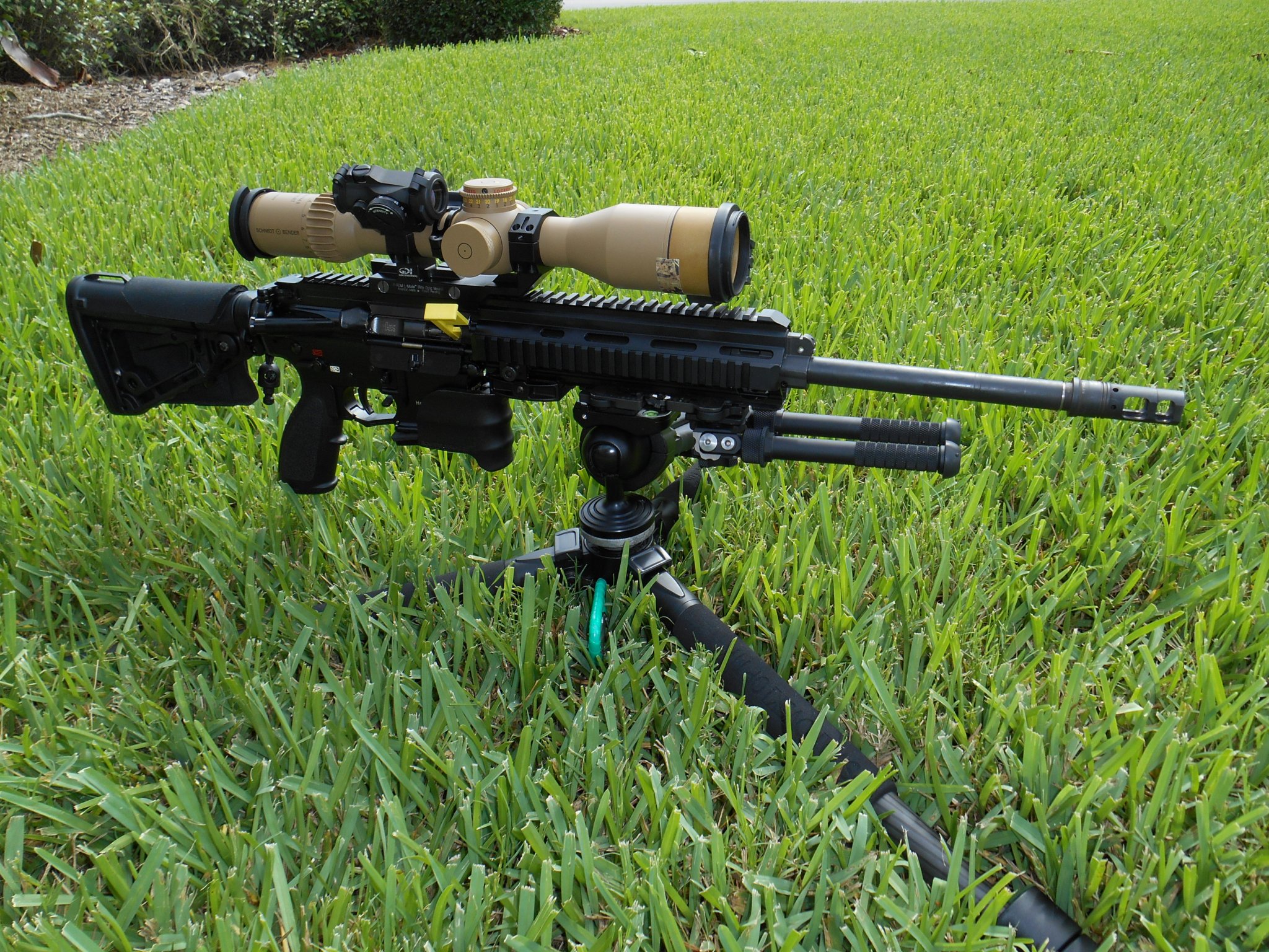

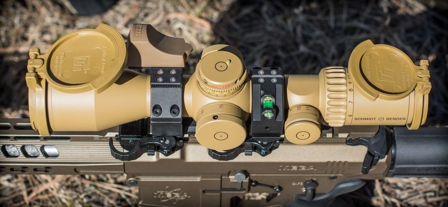

Unless I'm misunderstanding, you don't need an offset rail mount, they make RDS scope mounts that are stand alone and also ones that are incorporated in the rings. Below was my Schmidt Ultra Short with ERA-TAC mount and a Doctor optic offset from the front ring.

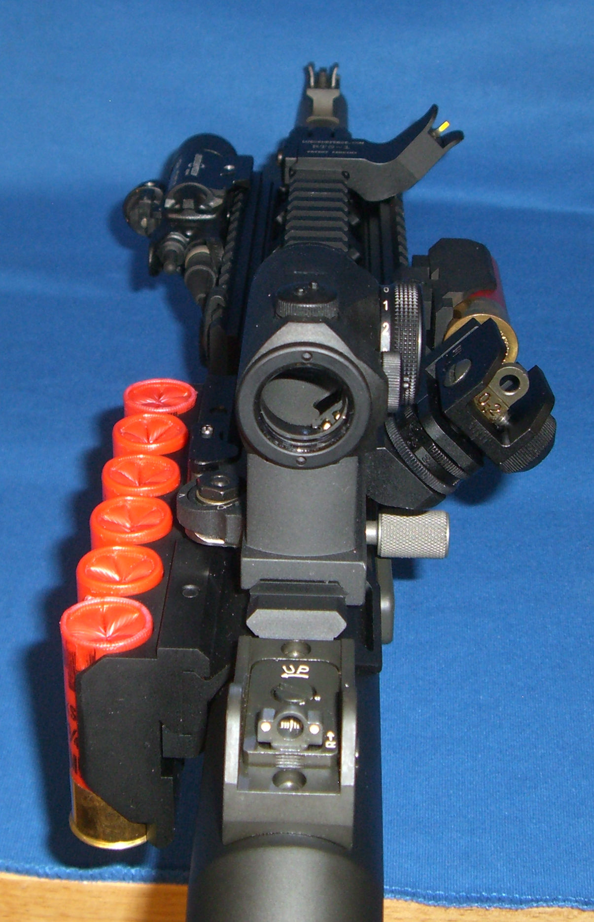

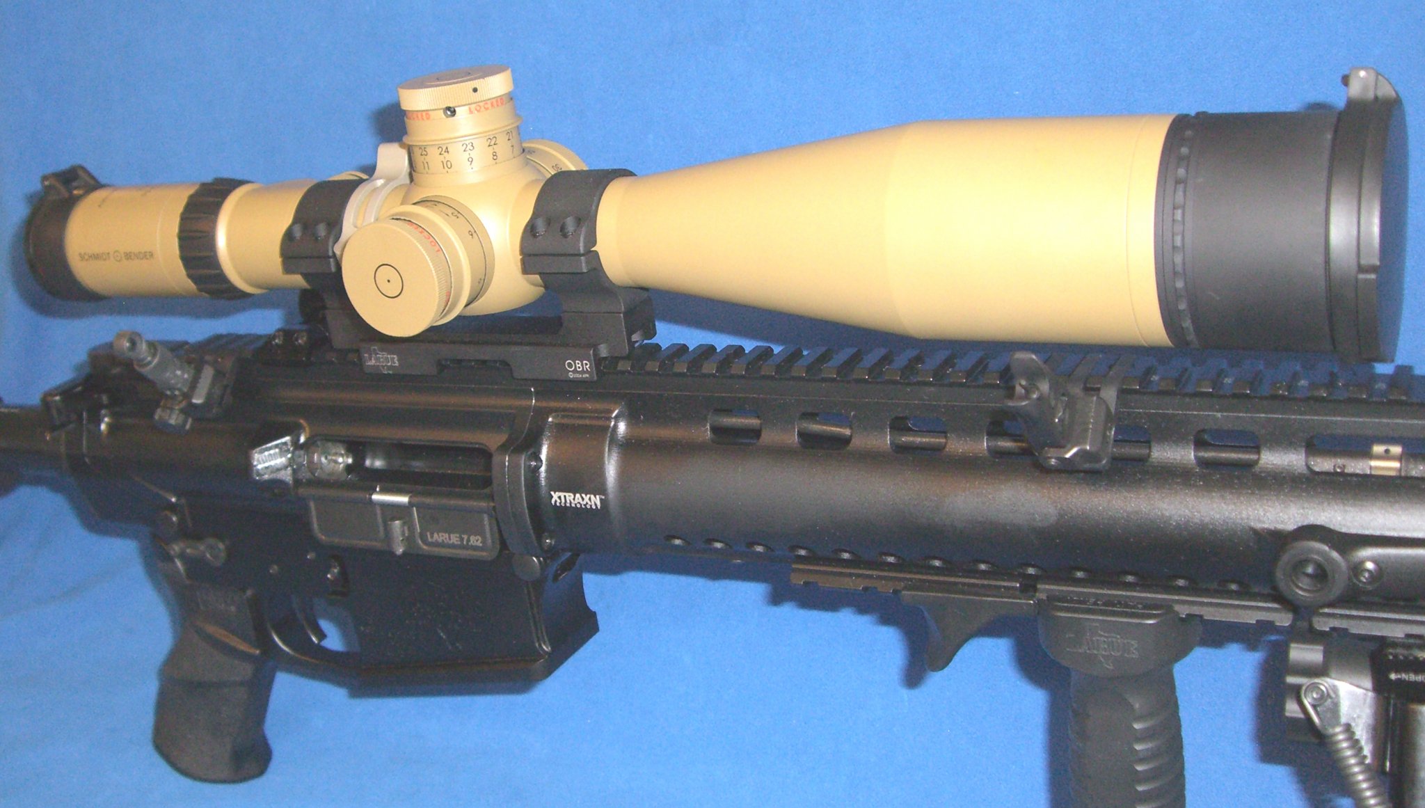

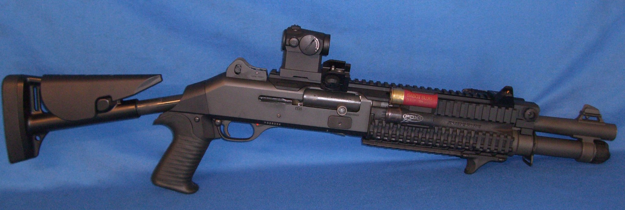

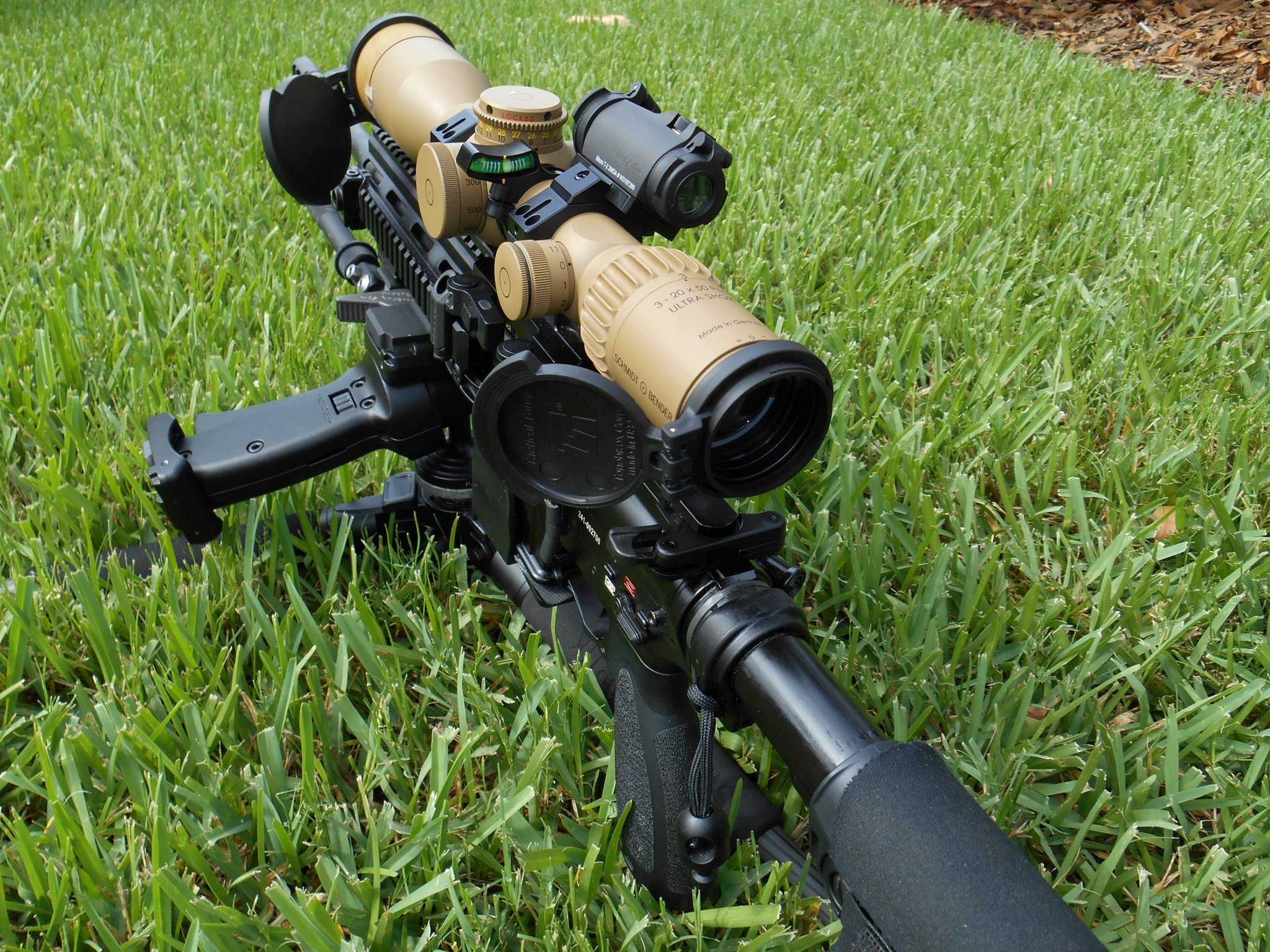

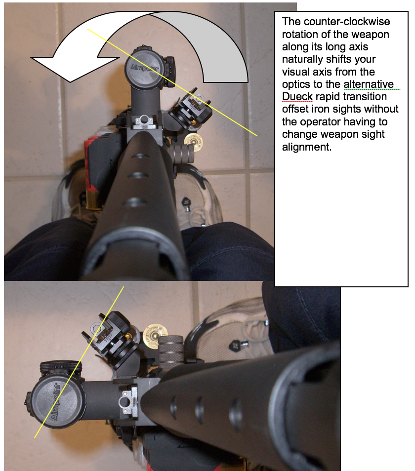

With an optic you set your desired engagement zero distance, height over bore becomes irrelevant, unless you are engaging inside the distance of your optic zero wherein you need to hold high to some degree, which is true for any sight system. For offset BUIS you could use the KAC microset or Barry Dueck's (3-gun champion) offset set by SureFire as mounted on this Benelli M4 14" entry setup. As ChitownCopper said, rotate the firearm and when set up correctly it is a natural arc of rotation to retain your sight picture.

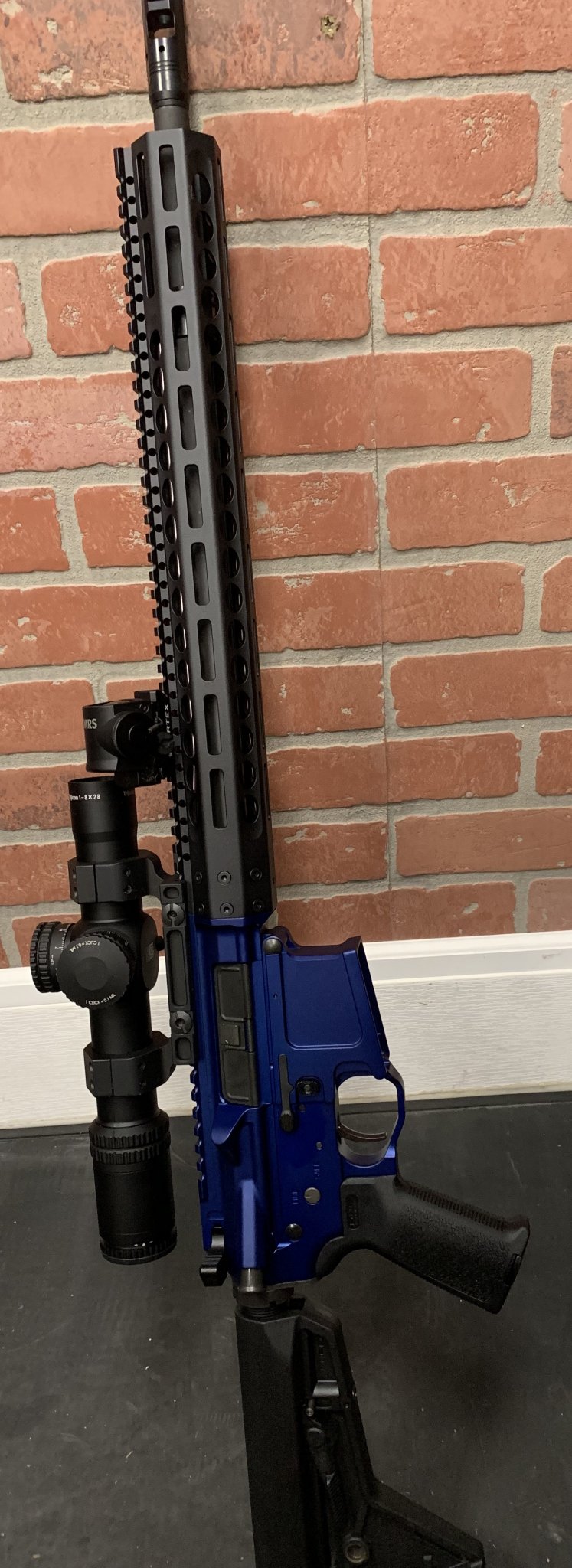

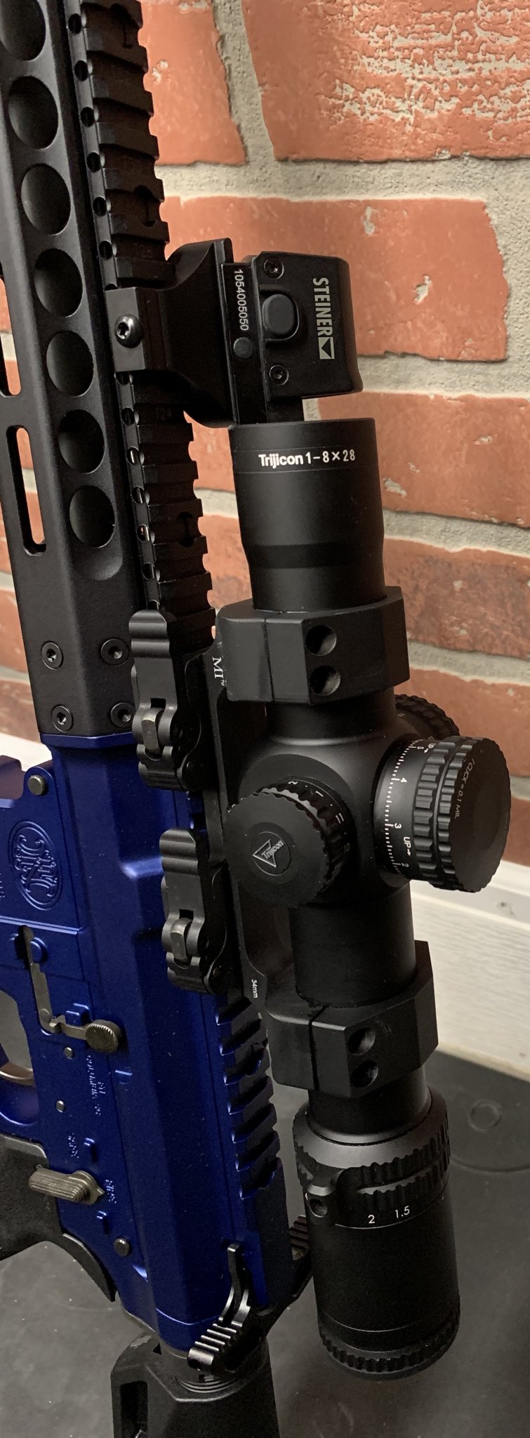

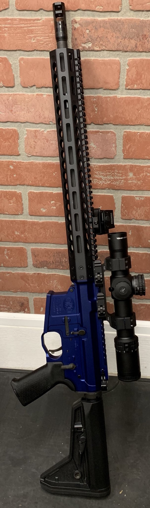

well, just ordered https://www.steiner-optics.com/battle-sights/micro-reflex-sight-mrs - snagged a brand new one for $381.74 (all in) after coupons... - will see how it performs on this rig. now off to getting a decent offset rail for it :) - gotta love this sport - spending never ends... still have to get a decent sling for it - so that will be another 80-100...
thus far:
FN15 Competition (thank God it needs NOTHING as far as trigger/furniture/etc.)
Midwest Industries MI-QD34SMHD-BLK 34mm Heavy Duty Quick Detach Scope Mount
Trijicon AccuPower 1-8x28 Riflescope MIL Segmented-Circle Crosshair w/ Red LED, 34mm Tube, Black, 1900028
Steiner Micro Reflex Sight 8700
it will be a different experience for me with this new gun, kind of got used to running my SIG556 and LOVE side charging handle - so that part will be some practice time retraining myself for charging/malfunctions/etc....

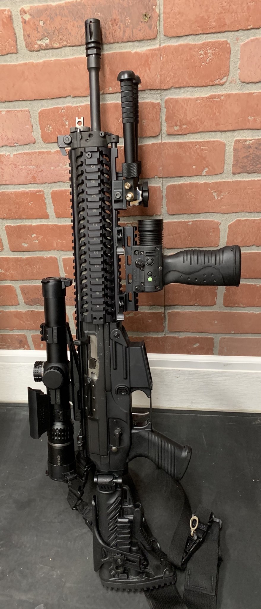

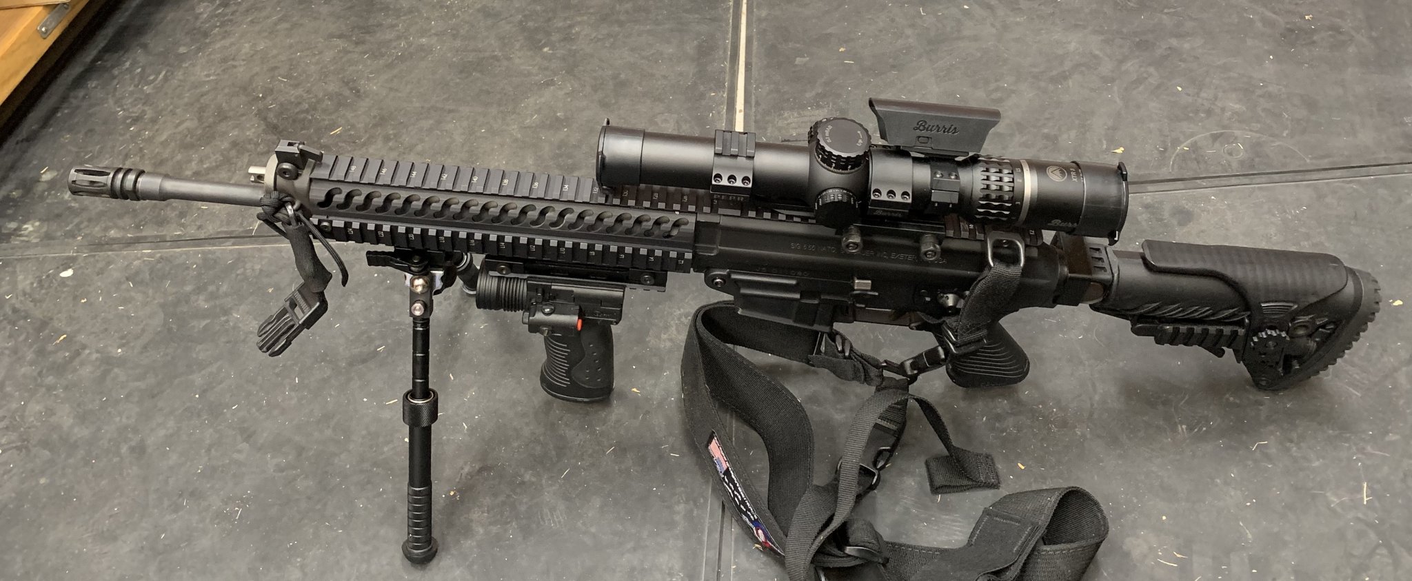

well, a few local SWAT team members were very impressed during my last tactical class/certification when they saw my Burris set up on the SIG... after they tried (scope zerod at 50 and fastfire at 25) my weapon, they were writing down information. while I LOVE my Burris set up (and purchased 4 more sets (first one, however, ran me a grand :) ) when Natchez was blowing em off for $475ish each)- it is HEAVY, it is 1.5-8 AND FastFire is scope tube mounted vs rail (perhaps an OK for a side charging handle weapon) thus NOT as desirable angle/position for around the corner shooting... Now, I am also training/practicing for a a left hand operation of my weapons (pistol/rifle alike) with use of a non-dominant eye - I mounted, for practice, iron off sets on the left side (because I had no way of mounting my Sig reflex due to a lack of proper off set mount (longer than most as far as number of slots)) - and its usable too. So, I might be actually looking into a second Steiner on the left side if one I just ordered works as well as I hope it does...

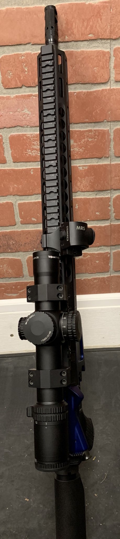

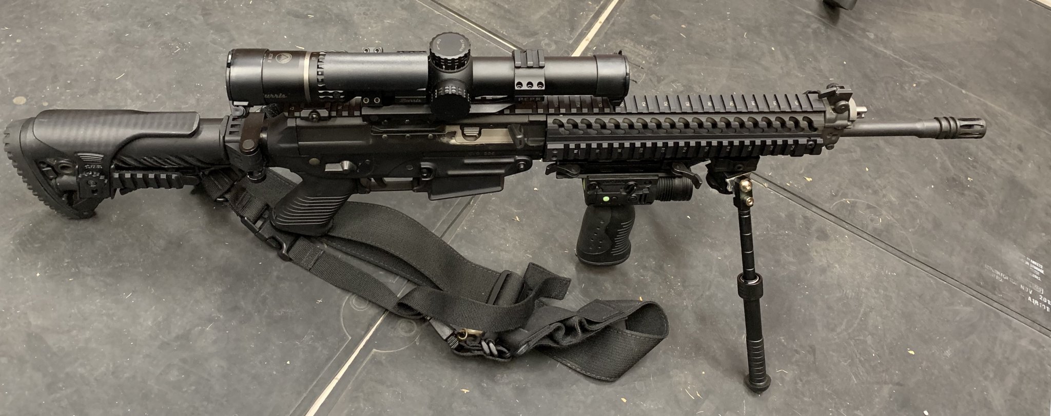

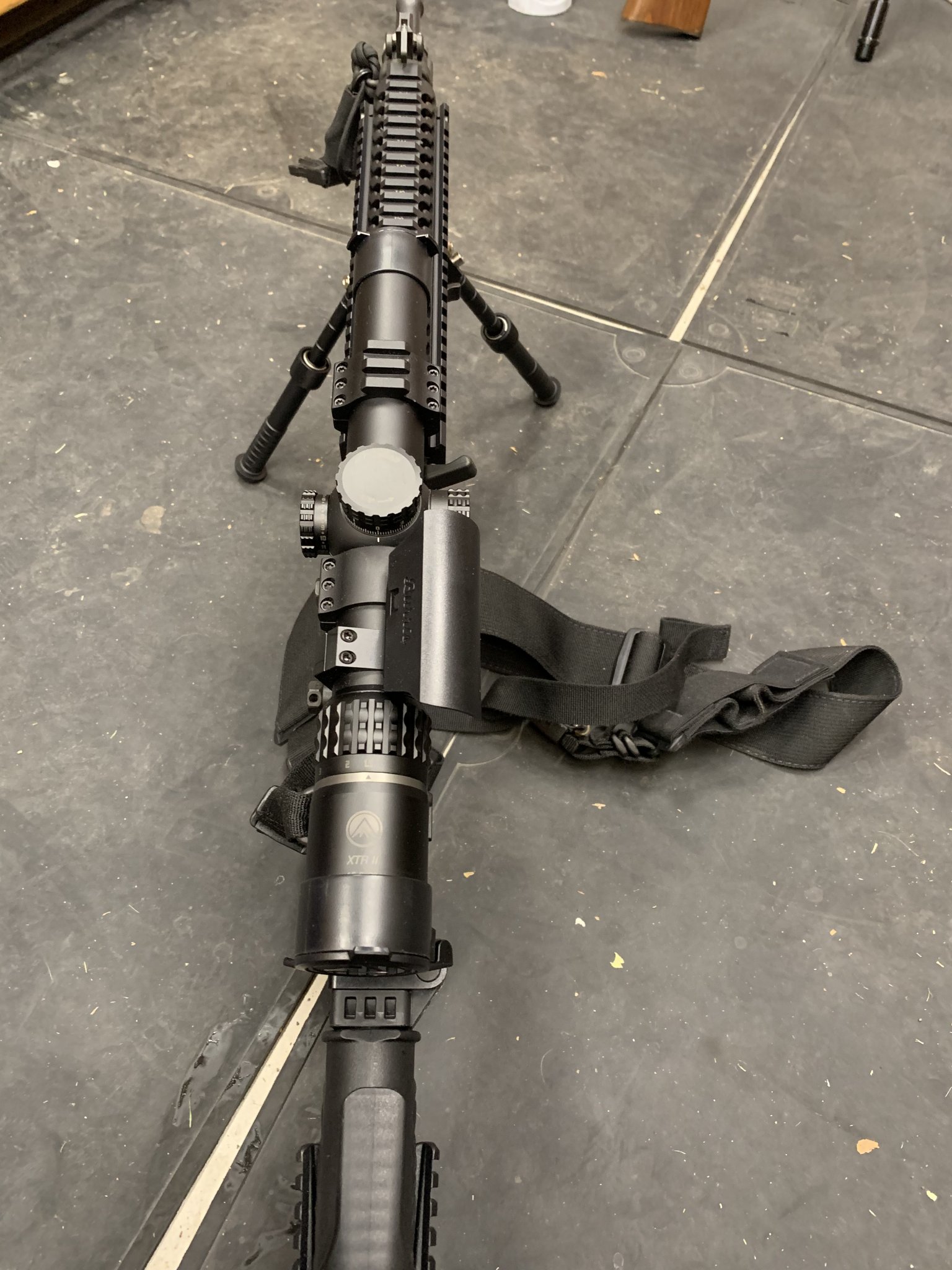

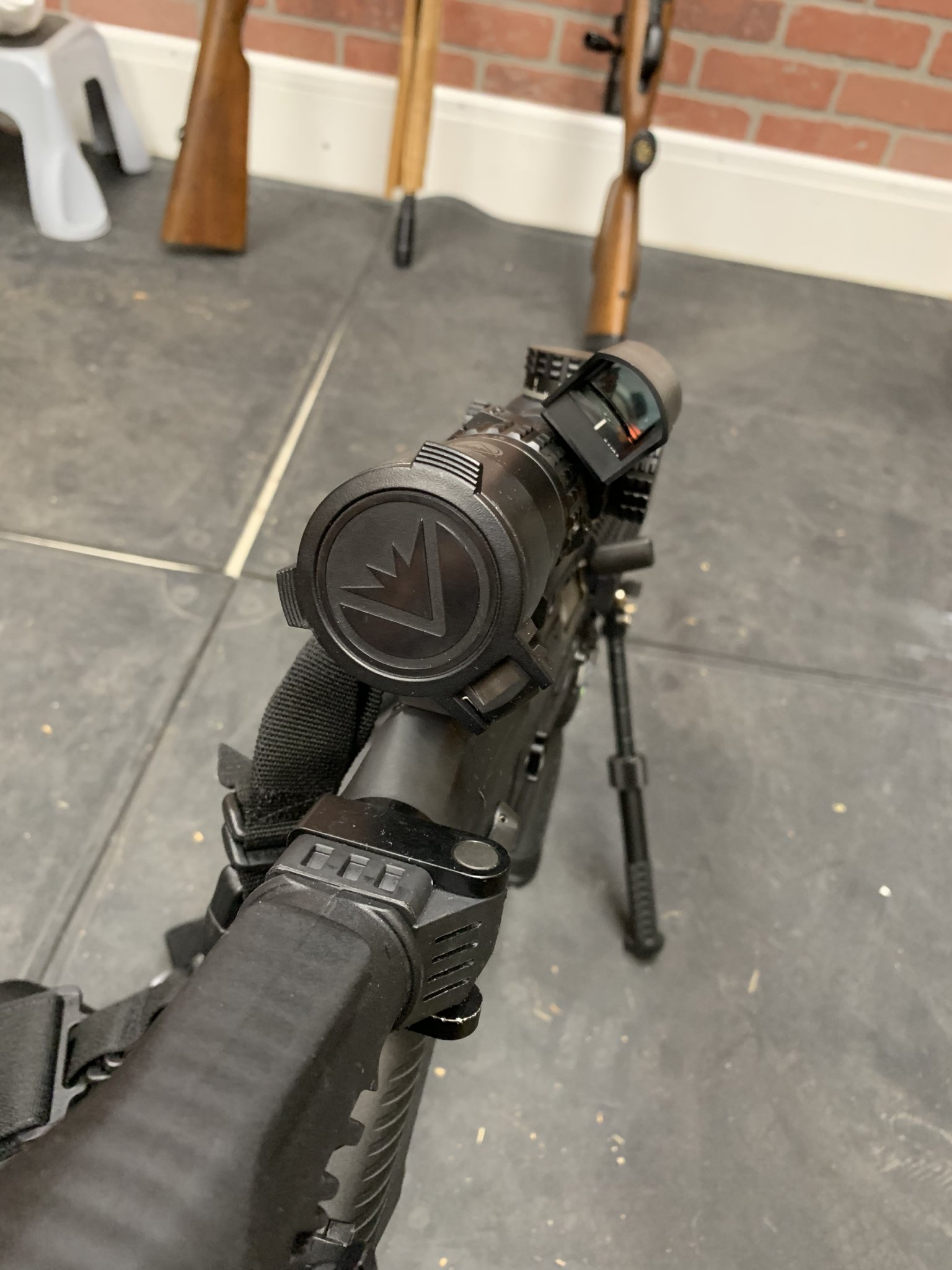

Not sure how happy I am with this set-up... Trijicon knobs are so big -“window” for a Steiner is quite limited... i guess I will take her our this weekend and see how she performs in real life as far as rapid target acquisition...
I will also try to move offset to the rear of the scope and see if that will be better...
