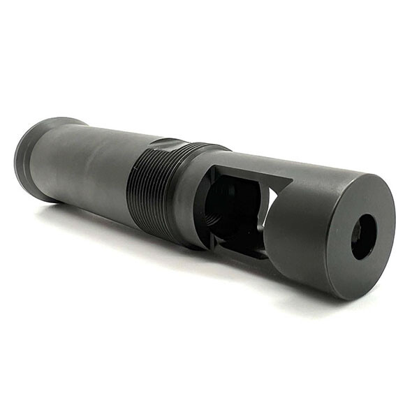

SubscribeHave Adco contour the barrel for a collar. The extensions are trouble and should not be used.I have a sps tactical 223 18" 5/8x24 threaded barrel and want to run a ops inc type can eventually. What's the best route for this? D. Wilson MFG doesnt do this contour anymore.

Yes. I worked with Ron Allen on one in '06. He made a couple for other people too. He eventually asked for it back because they were destroying silencers. The system is not designed, or intended, for an extension. The best way to adapt your gun for an OPS/AE can is to have your barrel machined for a collar.

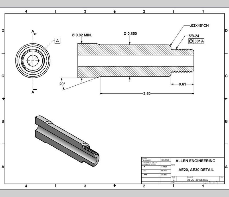

You should have enough to profile the barrel. Search aem5 ocm5 profile on this forum to get prints.Its only .865 after the muzzle threads. This one was cut from 20" i believe.
Yes. The same holds true for thread adapters and extensions for all silencers. Blowing out the end of your irreplaceable silencer doesn't sound appealing.Im guessing alignment issues with the barrel threads to the adpater ?
I dont have enough meat on the barrel for this style contour. I would have to do the spr contour with the collar.
