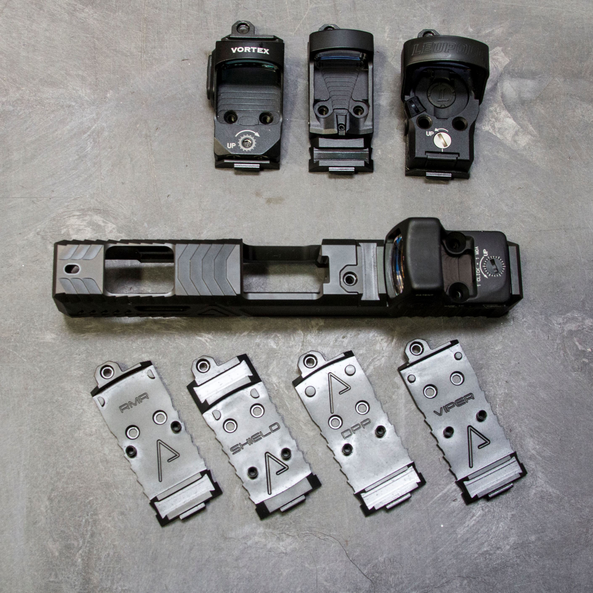

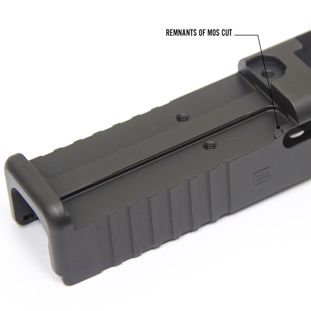

Is there a mounting solution that will mill the MOS clean out kn a large frame glock?
Ryan-
I'm not sure I follow?
There is a finite amount of material one can mill off of a slide before you interfere with the internals.
Many Glock set ups use different length screws to mount the RMR as the threads can go into internal springs for the Extractor
Same reason why you get to pony up another $80-$200 for suppressor/ silencer/ muffler height Iron Sights.
Ryan-
Since the MOS is junk and you can mill deeper does anyone make anything like the AOS system for small frame glocks that can clean up the MOS cut?
