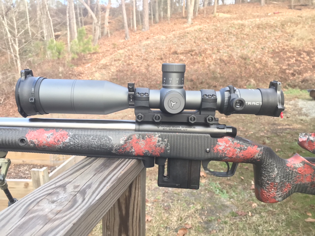

Tell your buddy to get in with Tract mil/vet program and get a Tract Toric ELR 4-25x50. It will be in your price area and one of the nicer scopes you will find in that price range. Has a great reticle and nice glass. It will do everything you need. Also get it in Mil and not moa.
