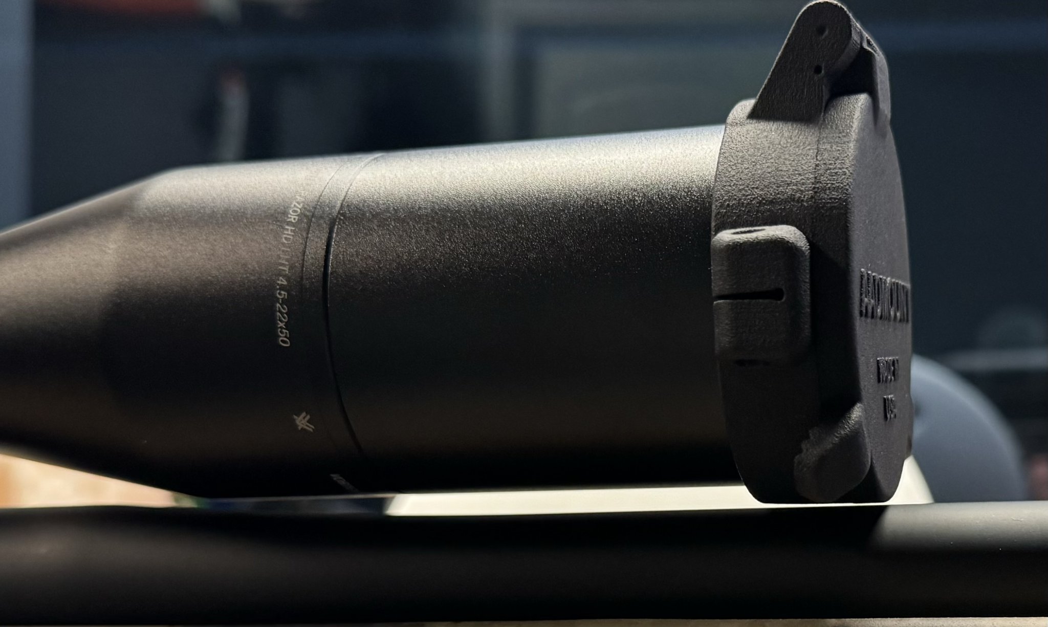

Wondering if this height will be a problem, such as recoil causing contact between barrel and optic?
I like these lens caps and would prefer to keep them. Obviously my clearance would be better without them. I’m running low rings because it gets the optic line-of-sight to perfect cheek weld height for me. I can slide 4 stacked pieces of computer paper in there (between barrel and optic).
See attached photo. Thanks

It’s 4 pieces of paper between the cap and barrel.
So that's. 016" . It's closer than I'd have it but it won't necessarily effect anything. If it touches under recoil it can effect it. If you can put your hand on the optic and push it down into the barrel, then I'd rethink this. Jmo

Thanks guys. I’ll try pushing it down a bit to see if contact occurs. Also will try the play doh idea. I’ll also shave a bit off bottom of lens cap. Maybe with a belt sander.
I’m a little resistant to getting higher rings because my cheek weld is perfection right now. And cheek comb height is maxed out on this Grayboe Phoenix.

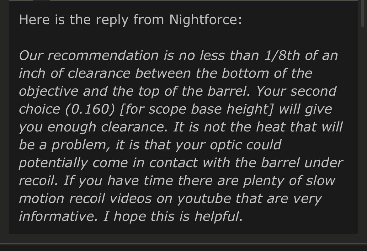

I guess my real question is:
Have any of you personally known anyone who has had damage to their optic (other than cosmetic) from close proximity to barrel?

Just kidding, that gap between the scope cap and barrel is not even 1/16".
And the bell end is also less than 1/8" on the barrel chamber area.
So i would put one step higher mount, so it would not get busted.

This was a timely post because I was having a similar issue due to the Vortex cap. I chose to cut a small section of rubber out as a relief. I tape them on with Goon Tape anyway, so it works perfectly.
I only chose to do this out of an abundance of caution, since I’m getting ready to test fire this rifle for the first time I don’t want any thing interfering with the barrel harmony harmonics. I saw no possibility in my case it would’ve moved enough to cause any damage.
That said, your caps are hard, which is why the recommendation to grind them down actually makes good sense. I have to agree that 1/8” sounds like a solid “science based” recommendation to me. Especially with unforgiving hard material.

Update: using about 20+ pounds of manual pressure using my hand, there was a minute amount of flexion. Not enough to make contact with barrel. I used a belt sander to give me an extra mm of clearance lol. I’ll take a close up slow motion video and update you guys. I’m also going to use some pressure sensitive film to determine if any contact is made during any flexion. I’m determined to measure what type of voodoo we’re dealing with. MC!
