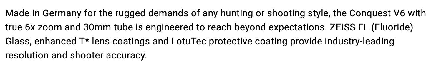

Zeiss V6 will have amazing glass. It's built in Germany. It gets my vote.
