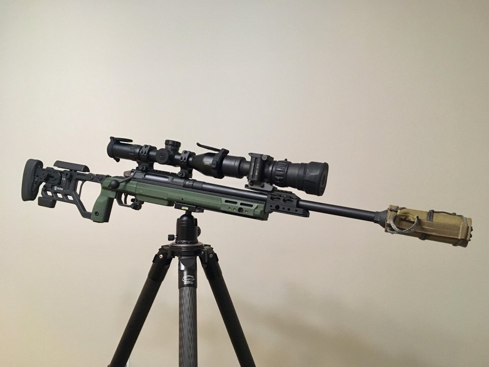

I got an ARC M10 rings in extra-high (1.42"), installed on 20MOA rail and here's how it looks like:
Thinking about getting Badger 1.49" ring for the other rifle and see how well it works.
