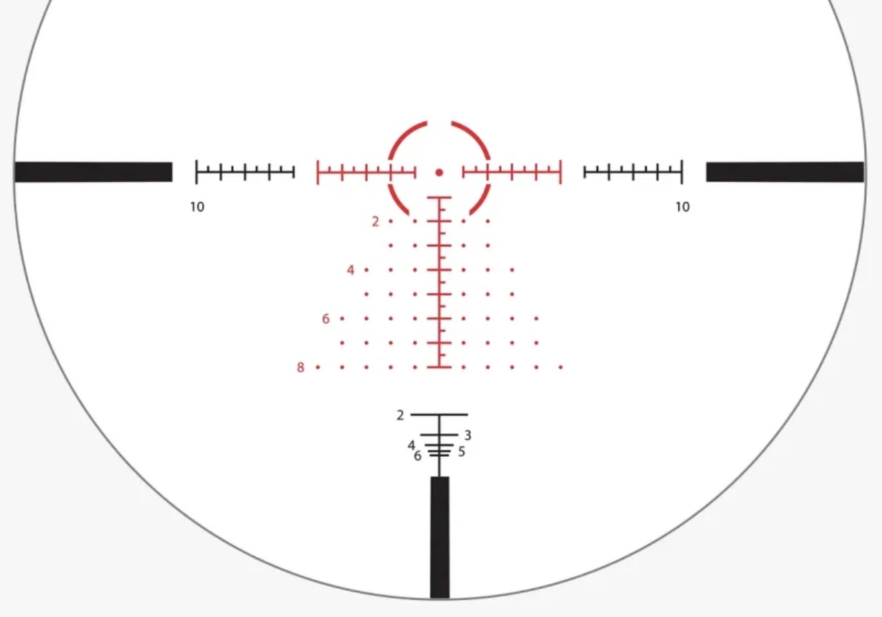

@OP, if you really want an LPVO, what I'd be looking at is the 1-6x credo with the etched segmented circle bdc reticle. Its a very nice scope. Still, an LPVO isn't the best choice for precision shooting from a bench or prone. A $1000 2-10x will beat out a $2000 LPVO in terms of usability.
