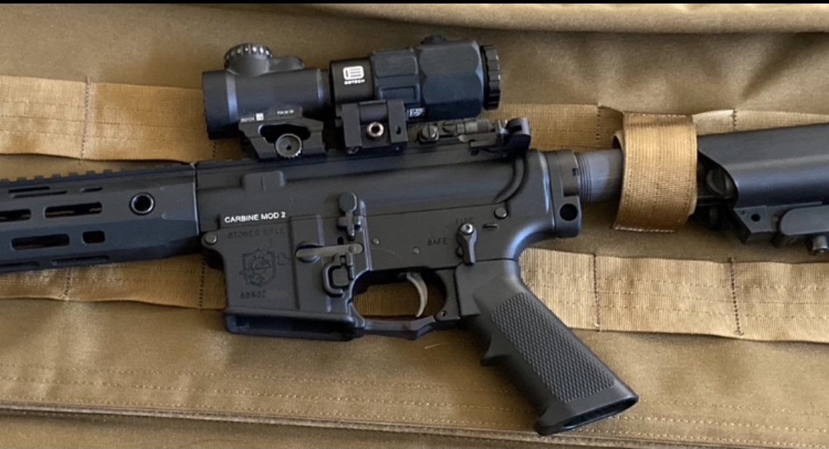

What do you consider "close in" and what kind of shooting? My "close in AR" wears an Eotech exps-2.
QD EoTech G45 and whatever red dot in front that you prefer.
