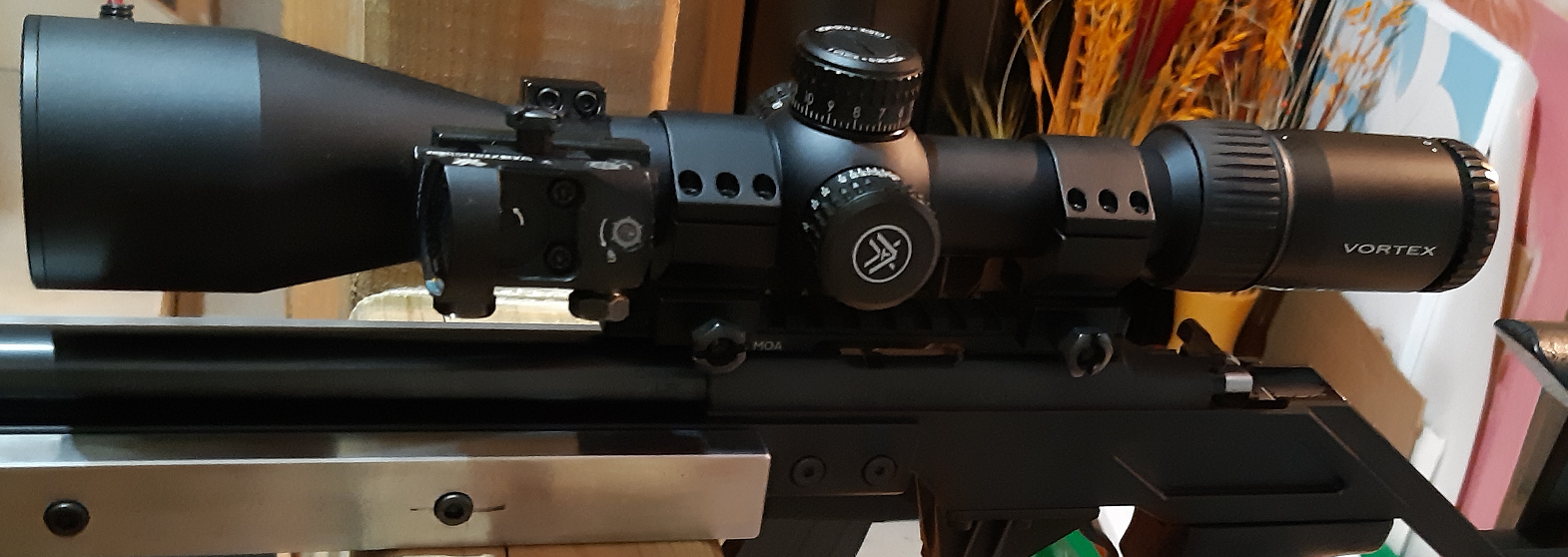

I can and do shoot an entire PRS match at 20 x and never reduce the magnification to assist with finding a target and I can acquire the target faster than anyone on the range. Not that I'm superman or anything its just how I use the red dot.
I'm surprised this has not caught on. All I do differently is mount the red dot on the front part of the scope tube at a 9:30 position and offset so it aligns perfectly with my left eye. This allows me to look through either the scope or the red dot alternatively without changing head position.
For F Class I use a Nightforce NXS SFP with a reticle that is dimensionally correct at full magnification. I've never used that scope for PRS, but set up with a red dot like this, there's no reason it could not be used.
As far as target acquisition speed goes, I would never reduce magnification for that purpose alone, but there may be other advantages to reducing magnification such as spotting shots in the air under recoil. That to me is the real reason to go with an FFP optic. Another reason might be to expose more of the reticle for hold overs.

I think that is a pretty cool idea - especially for multiple target engagements. Which red dot scope is that? How did you mount it to the scope tube?
These are the components bax
The trick is to get the spacing just right to match the distance between your eyes. It doesn't need to be perfect, but should be within the field of view of the red dot.
Things like scope tube diameter can affect the spacing.
It would be nice if someone made something for this purpose so we would not have to cobble together a bunch of bits that can be hard to find on the internet.

Have you heard of Spuhr mounts? I'm not sure if this answers your question about someone making a product that allows you to mount other components to or not, but I figure I'd throw it out there to see what you say.
Reactions: PracticalTactical
Yes I have Ramblin Man, thanks for the suggestion,,, Cadex also makes something that is probably a little closer to my needs, but none of them position the red dot directly in front of the left eye while the right eye is looking through the scope.
I originally mounted the red dot on top of the front ring, then I had to turkey neck up and down. That was slower and lead to jostling the rifle around while moving stock weld.
AR15 guys put the red dot at 1:30 and that works for CQB, but we have to reposition the entire rifle to transition from red dot to scope.
Placing the red dot directly in front of the left eye is simply the fastest and most efficient position.
