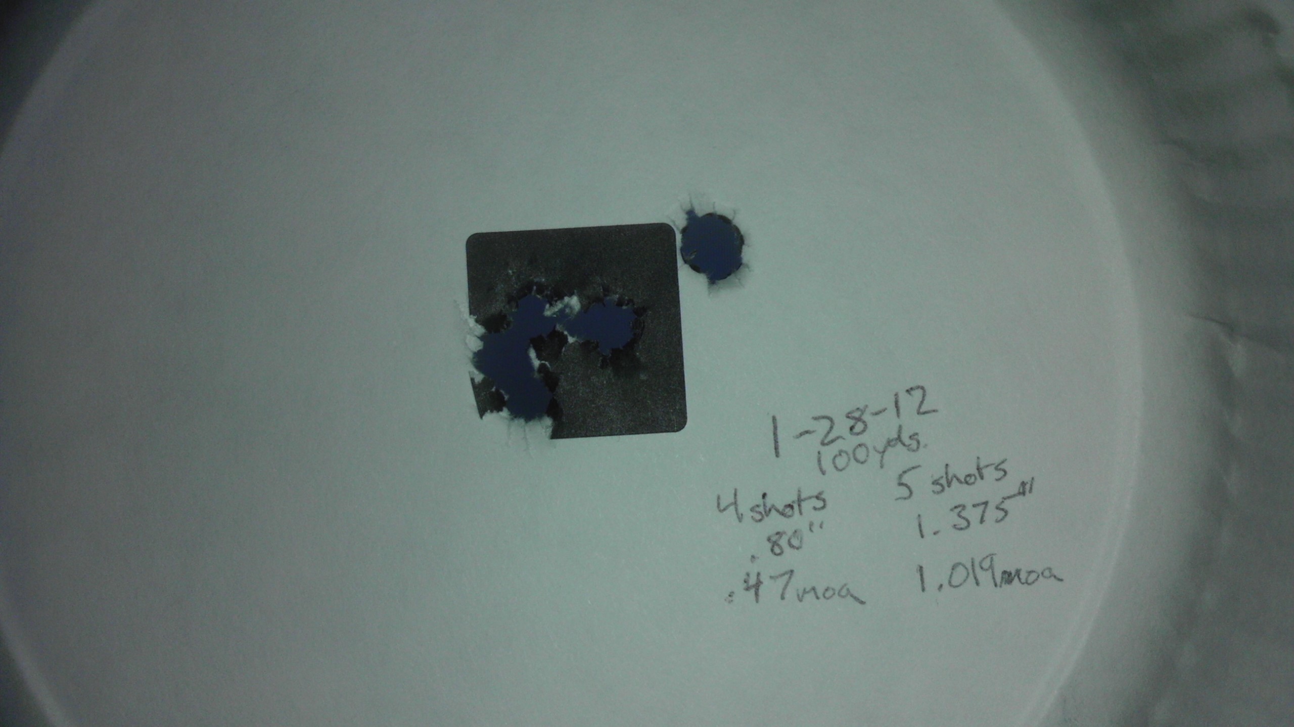

    Here is a target shot with Black Hills 190 gr. Match.

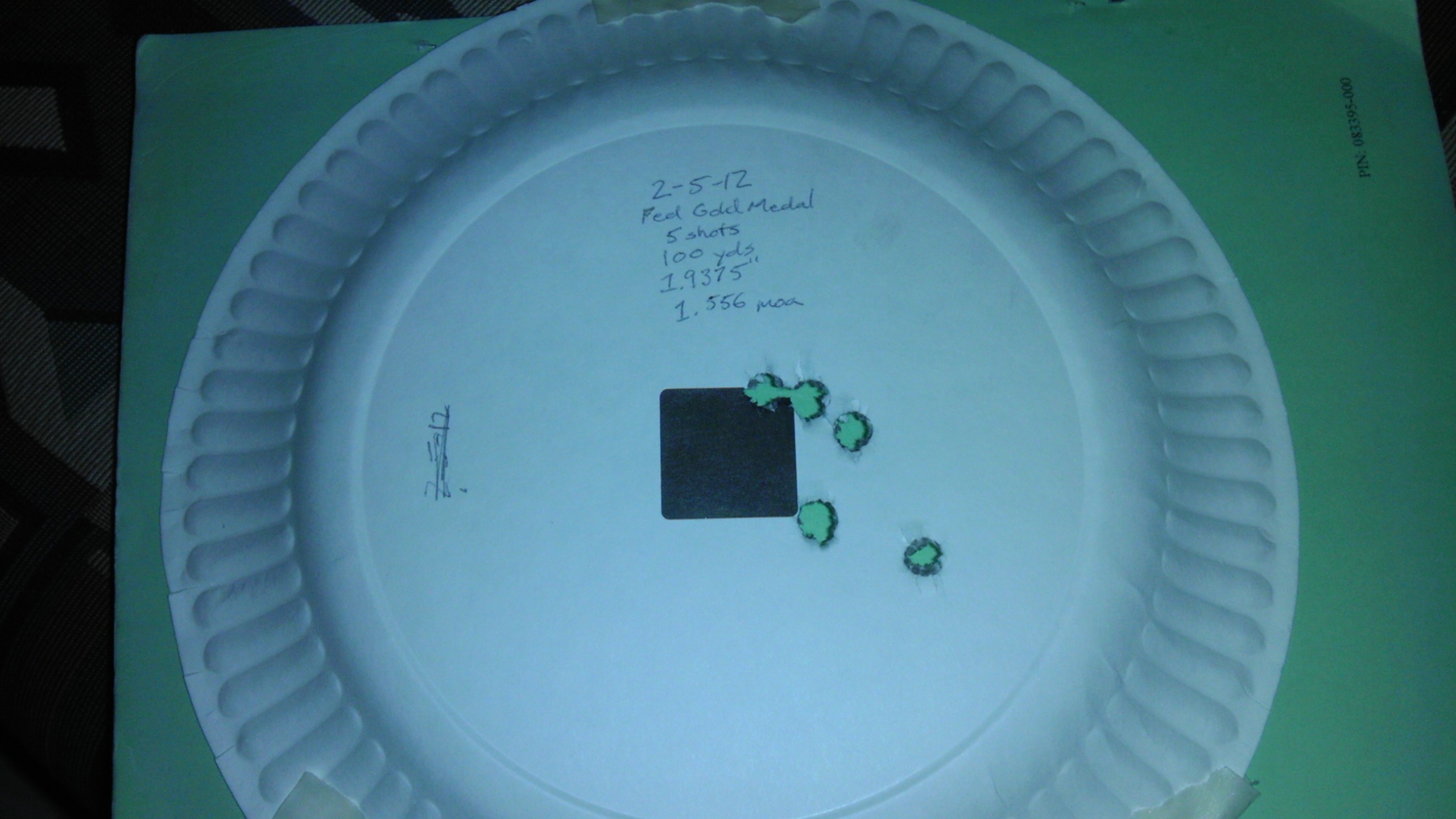

    Then a target shot with FGMM.
    So.... In the effort to find best factory loads for various rifles, is there a resource for what barrel lengths are best for different factory loads....?
