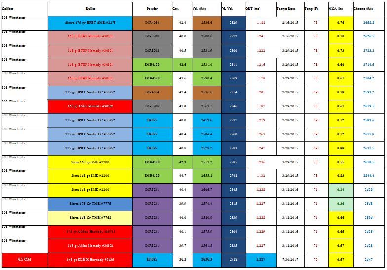

I appreciate each of your responses. I have a excel file with each load I have reloaded and chronograph data for the days I took that equipment to the range. I reload for 25-06, 308 Win, 5.56 Nato, 300 Blackout, 6.5 Creedmoor, 458 SoCom, 12 GA shotgun and 9mm, 45 ACP, 40 S&W, 357 Magnum. It has developed into quite a hobbie!
Here is a sample of the data I have collected

How many decimal places on the OBT is important. Chart goes to four and the obt calculator goes to three. Seems like two should be adequate because it sort of starts to fall apart at the lower and higher ambient temperature range when compared to the temperature on the day you gathered your data and called it.
Think in terms of significant figures. It's not trivial getting better than 2 sig figs in many real world measurements. Getting to 4 typically means there is quite a bit of control in the system. In terms of a calculator, there's no harm in using one or two more digits than the data variability supports as long as you understand the last one or two may be insignificant.
We'll, .001 is one millisecond. In QL they show it as 1.000 m/s. So, that third spot is thousands of a m/s. A fourth place would be ten-thousands of a m/s. What is the confidence level of the OBT calculation, 90%? If so, they overlap. There needs to be some sort of +/- of it. Even the creator says it is a calculated estimate but doesn't give an estimated error rate.
I forgot to state that both the 308 & 6.5 CM data is being shot from 24" long barrels. As shown on the sample data, not all of the OBT are aligned to the natural barrel frequencies. I started searching for accurate loads by reading and then loading load ladders. I found this to use up a great deal of components, without much success. So I read some more, learned about the OCW approach and the OBT approach. I decided to buy a copy of Quickload and pursue the OBT approach. I have yet to investigate seating depth variations, while using OBT loads, to see if that kind of minor adjustment can improve a group size for me. I will admit that I still have much to learn, but I am enjoying the journey.
