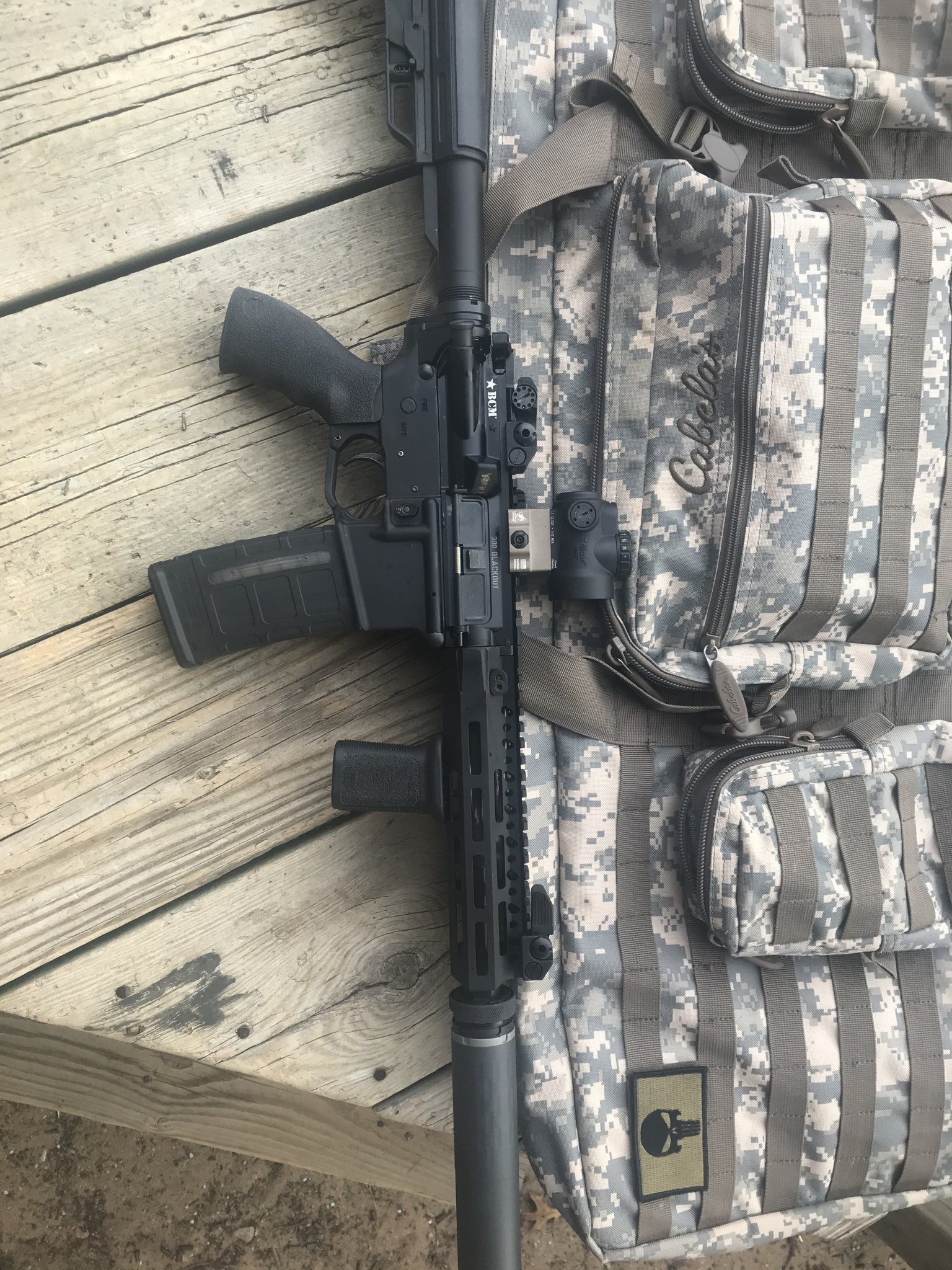

9” is the way to go. Here is mine. Quiestest hun I own aside from a suppressed .22.

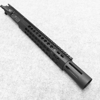

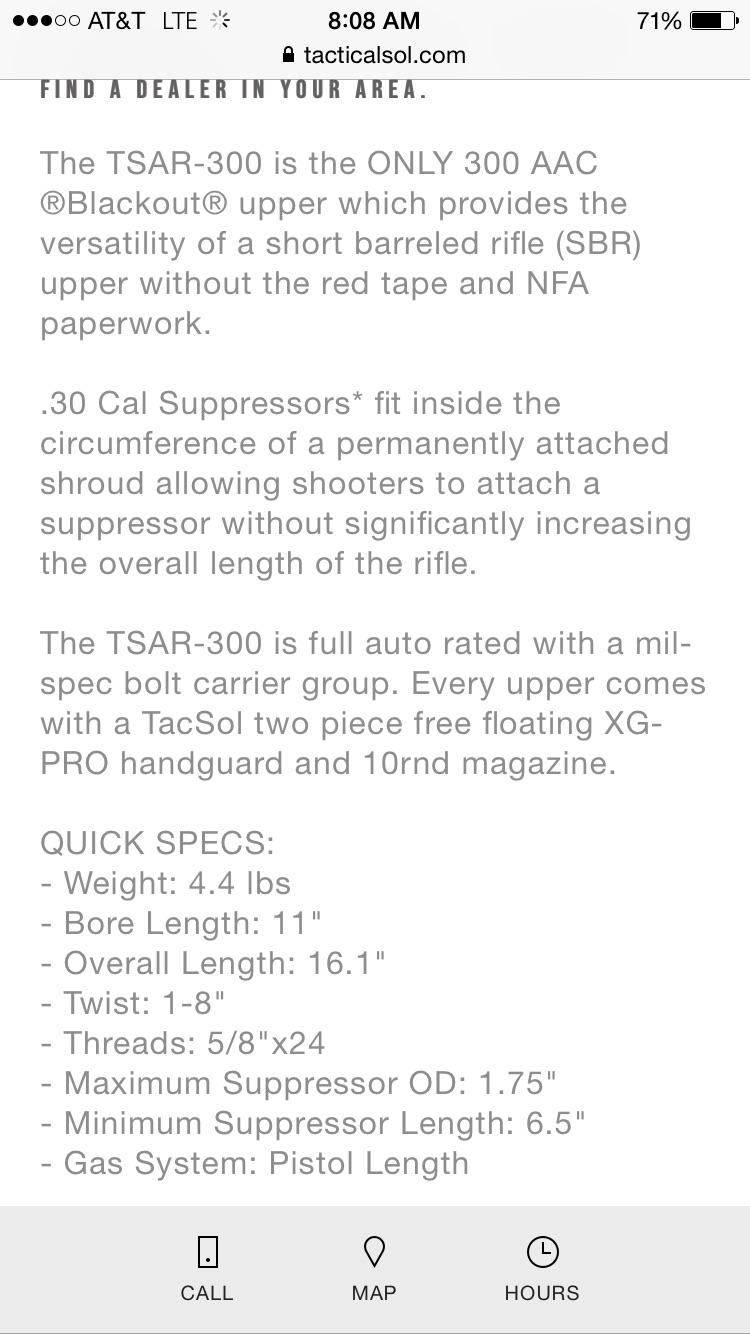

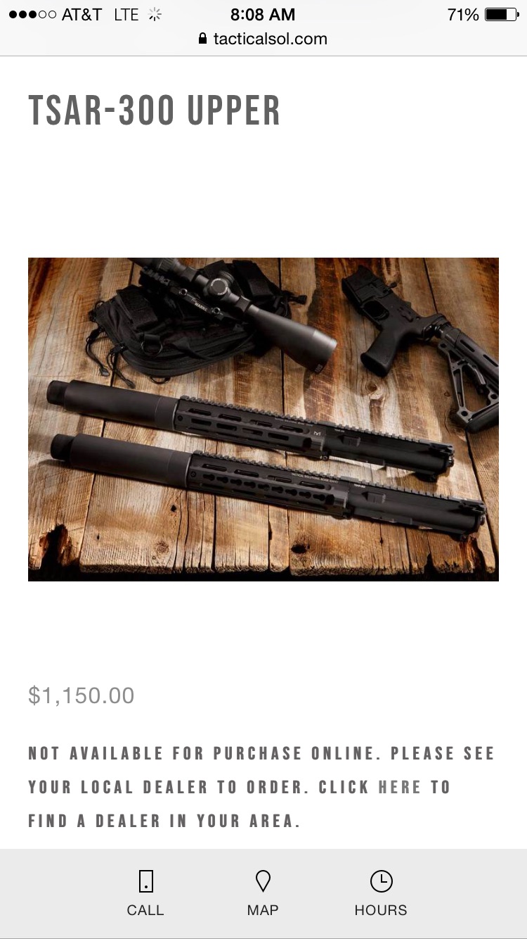

A pictorial for people.
Yes, some people need pictures...
Same concept as what I am talking about except I will attach the shroud to the barrel, not the upper. I don't want a dedicated upper as the host is a Sig MPX. I do not want to give up the interchangeable barrel capability. In addition, I have to believe that the hand guard and barrel need to be permanently attached to comply w/ the ATF. With one of these uppers if something happens to the barrel, or it just gets shot out, the entire dedicated upper will now have to be replaced.
