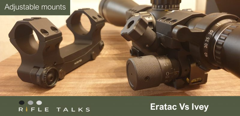

I dunno -- Charlie TARAC is going to start at least $1500. There are other options besides the ERA-TAC (Ivey and Cold Shot come to mind), but they're going to do the same thing mechanically for you without having to buy another scope. Just how far are you trying to engage?
I saw that vid. It looks like a good explanation of options. I don't think he had the Ivey base in there though.
The Ivey does add a bit to the height as well. Just yesterday I took off the cheek riser completely and just put some mousepad and tape directly on the tube of the stock, right where the buttplate attaches. This lowers my head, but I'm left eye dominant s I just roll my head over crooked and shoot that way it works good so far. Before that, with the cheek riser completely raised, my right eye was GTG in the eyebox for about 20MOA elevation, any farther and there's no adjustment on the cheek riser.
I'm looking to get more time from 100-1250 with the Ivey/Sightron setup. Having a single base MOA in one unit makes the calculations super easy. dial base / hold reticle.
