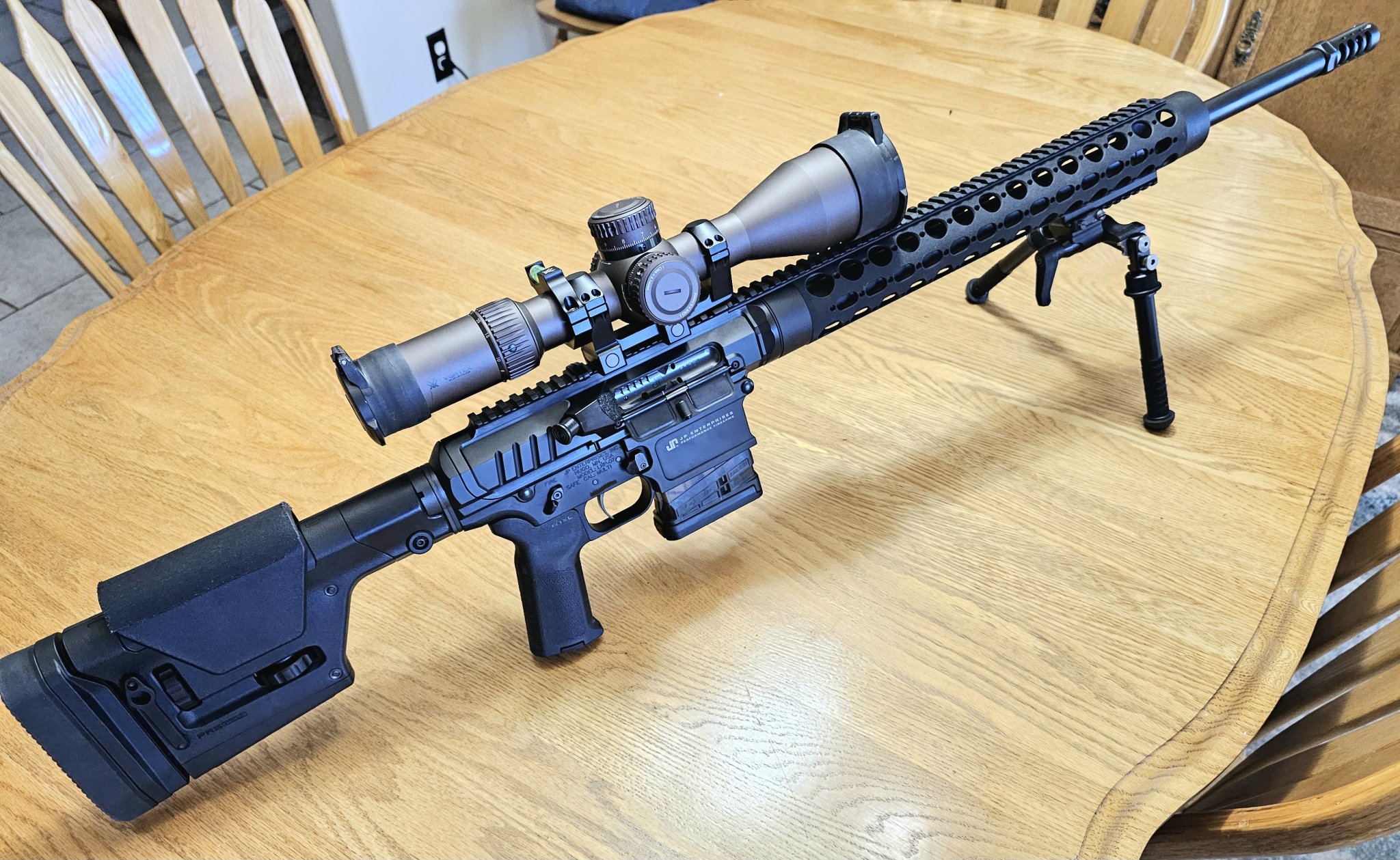

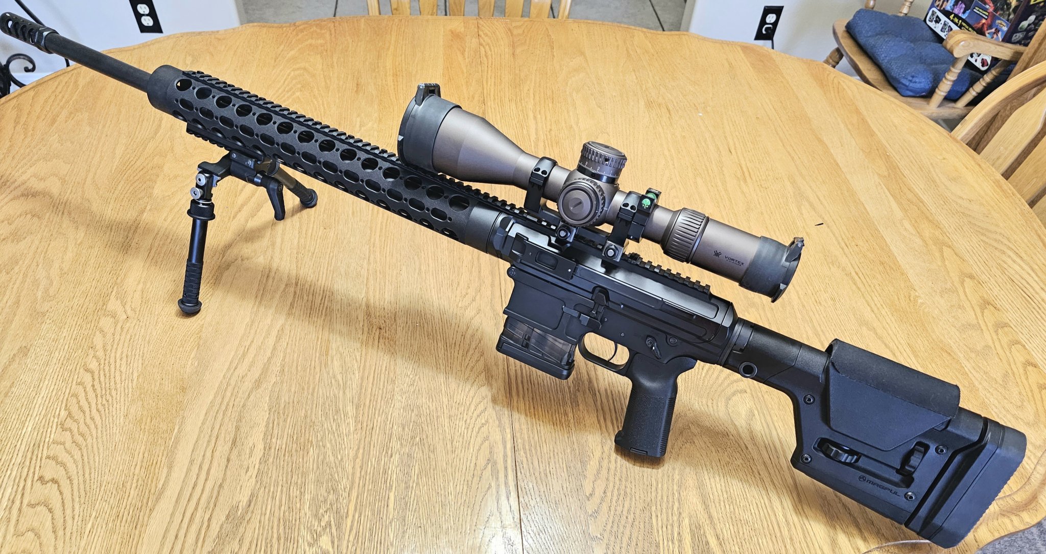

You can order the JP LRI-20 as a builders kit, I recently finished one myself. The Barrel is a 24" Bartlein 1-8 Twist with Rifle Length +2 Gas System from CLE. The only ambi feature that couldn't be added was a right side bolt release, but the JP requires a true thermo fit so the rigidity is outstanding and noticeably stiffer than the SP10.
If you prefer a Top Charger they have the LTI-23 that you can use any large frame handguard you prefer if you're not a fan of the round handguards. The JP Build kits are about as good as it gets.
Here's a side by side of the two.

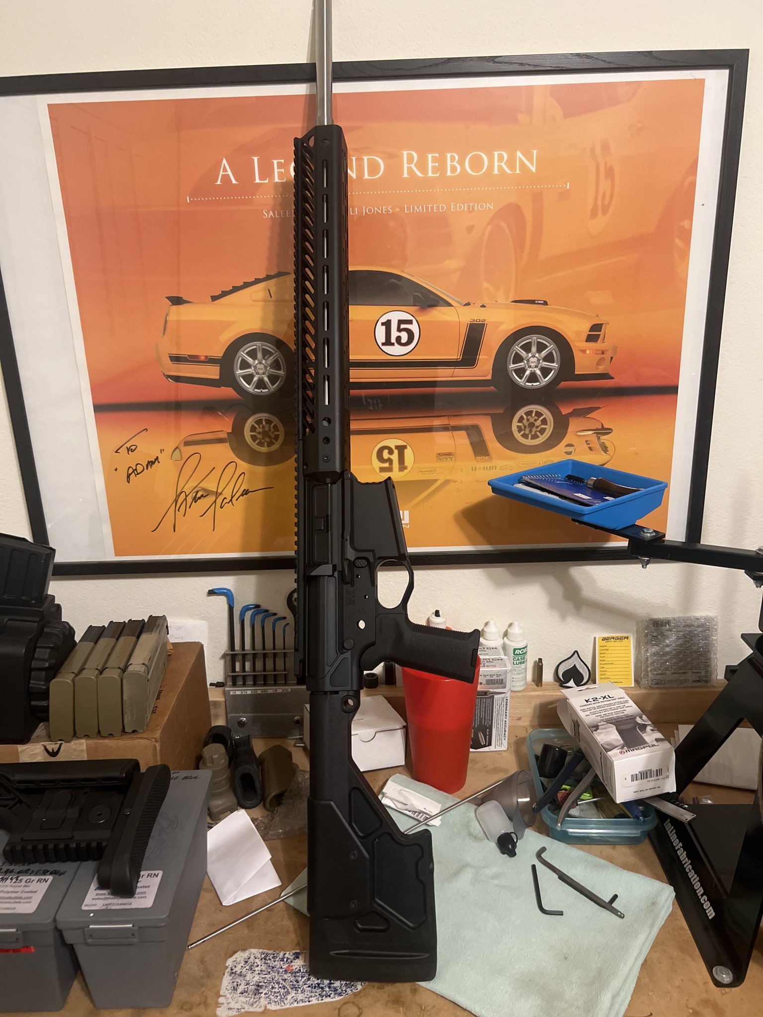

Second vote for the Xanthos… Especially if you’re going for a light(ish) weight rig. Here’s my 8.25# pig sticker in .308:
Not the tool I’d pick to use in a fight for my life, but sure is nice carrying a lot less weight when pushing through deep cedar and mesquite, up and down the hills for a few miles in the middle of summer.
How did you find the barrel fit on that zev upper? I got one and was expecting it to be a thermal fit… but it wasn’t… if anything, it was a bit loose. I used a Noveske barrel and haven’t had a chance to shoot it yet.
It was tight, I heated it up anyway but it probably wasn't necessary. So not a true thermal fit but definitely didn't just slide in.
