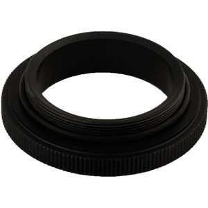

8mm is the closest I see, which would put it at 56x:
This is the astro eyepiece adapter:

Last week I bought a second hand Optolyth TBS 100 APO with fluorite glass off an 81 yo ornithologist who wanted to finally get a Swarovski. The old man was in a very generous mood so I got scope and eyepiece for just € 200,- Although its probably pretty old it still felt like an extreme bargain. It’s in very good condition, except for the eyecup. My eyepiece is the fixed 20ww (60/80) 30ww (100), which requires the 42mm eyecup.
I ordered a new one here:
In that list you can also see the zoom eyecup, which is probably the one you need.
Must say that my first impression of this scope is very good, and especially in low light. It’s my first scope, so my opinion is of little value i guess, but in low light it feels like it even adds light to whatever you observe, rather than just bring it closer...
EDIT
Got my 42mm eyecup today so no complaints about astroshop.eu
