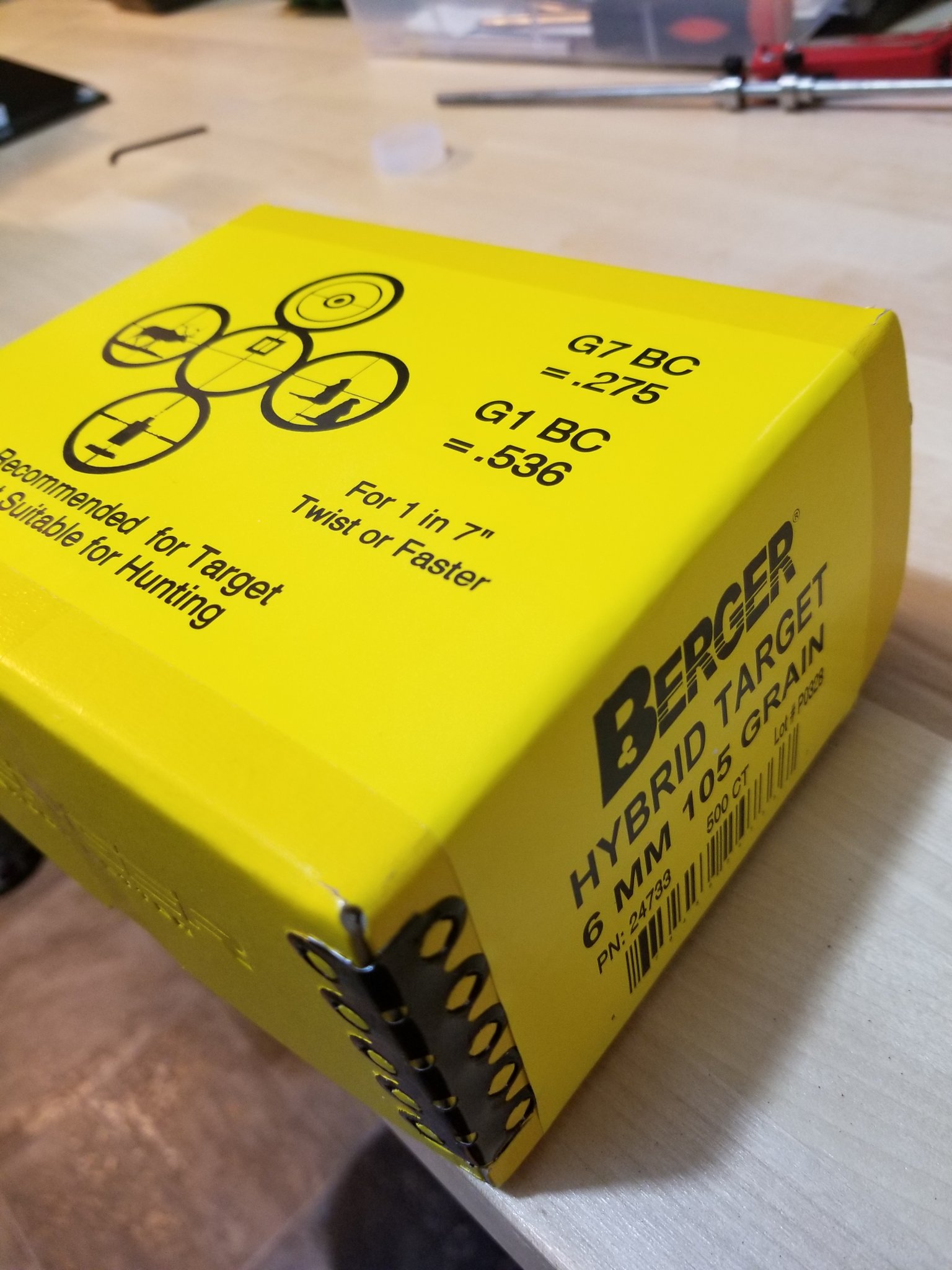

Berger says 1:7

Berger says 1:7
Is that a recent box? Because Berger says 1-8 on their website
Yes, sometime last summer. Their website lists the 'minimum' twist for proper stability.. box indicates 'optimal' twist.
