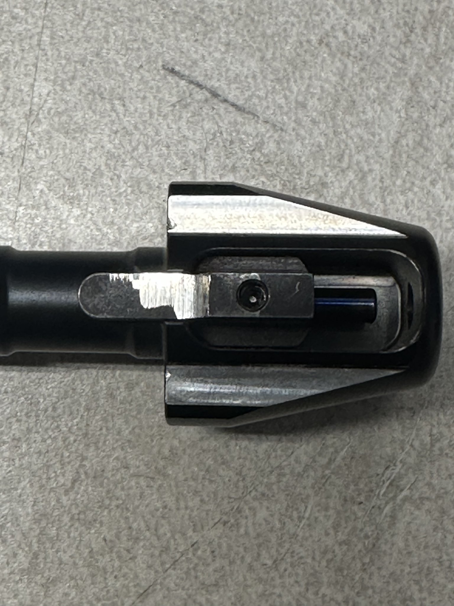

I did a search but didn’t see anything also emailed Zermatt but didn’t get a response. So I have an origin action and wanted to know how the firing pin and spring are disassembled? Like if I need to replace those parts how do I disassemble the firing pin from the spring? I know how to do it on a standard rem700, but obviously the Origin is a little different.
Thanks
What happens if the firing pin breaks or spring needs to be replaced? That’s why I was asking, I just want to know how to repair it if it becomes a problem.
There are two set screws on the cocking piece. One is on top of the other. Unscrew them and then unscrew the firing pin from the cocking piece.
