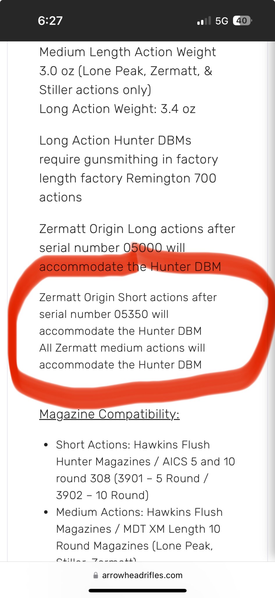

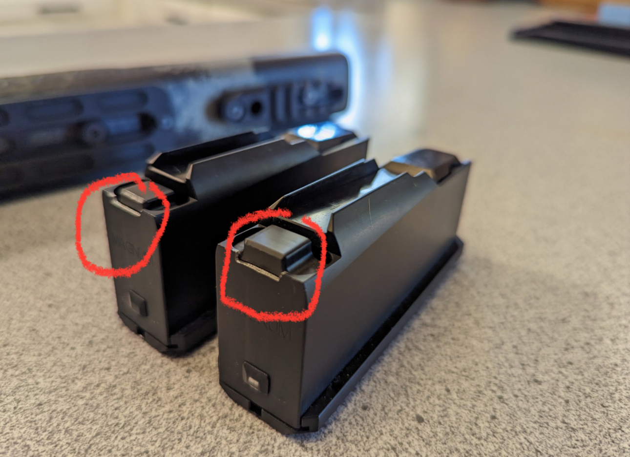

    I have a Bighorn Origin short action that I want to put in a Peak 44 carbon stock that takes M5 bottom metal. I’m interested in using the Hawkins Hunter DBM, but ran across this comment below on a website. My SN is in the 2400 range. I emailed the company that had it for sale and they had no idea.
    Do any of you know if Hawkins Hunter short action DBM bottom metal only fits Origins in a SN range above 5350? And if so, why?
    Reactions: Billdoe708
    The issue is not with bottom metal but with the hunter magazines hit the action on earlier versions. Later version they extend bottom cut a little bit to clear. When I talked to Zermatt, they advise taking the action to a gunsmith. After looking at the pieces in hand, you can just notch the back of the hunter magazines. Without the notch, the mags would not lock in.
    The issue is not with bottom metal but with the hunter magazines hit the action on earlier versions. Later version they extend bottom cut a little bit to clear. When I talked to Zermatt, they advise taking the action to a gunsmith. After looking at the pieces in hand, you can just notch the back of the hunter magazines. Without the notch, the mags would not lock in.View attachment 8557949
    Well that looks easy enough. Is it only an issue with Hawkins mags then? Do normal AICS mags like MDT mags still fit or would they need to be notched as well?
    I have the action in a KRG-b right now and I’ve not had any issues with the MDT mags.
    They should fit without issue. The Hunter are billet and thicker for a tighter fit. FYI, mine is a LA and they don’t work with AICS mags so the SA may be a little different.

    This is correct. It's only a fitment issue with the Hawkins Hunter magazine system in those older Origin receivers. All other AICS magazine systems have been good to go to our knowledge.

    Thanks, I appreciate the information straight from the horses mouth! Looks like an easy fix too. I picked up the Hunter bottom metal in a BF sale for $146. I’m putting together a stock and lighter barrel set up for my Origin so I can hunt with it.

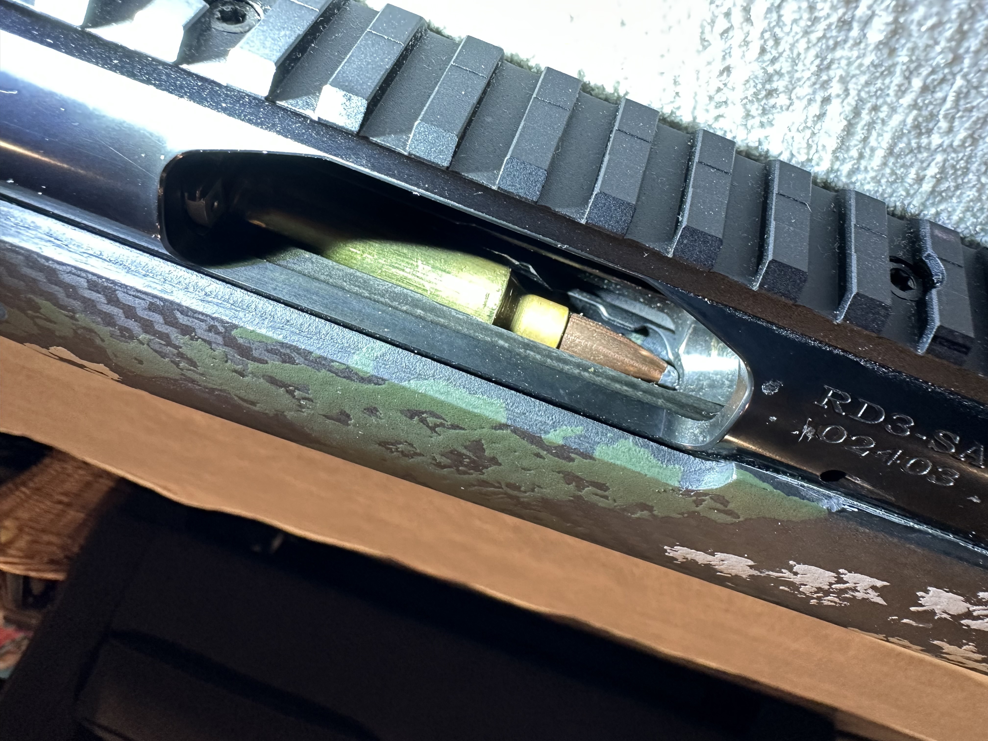

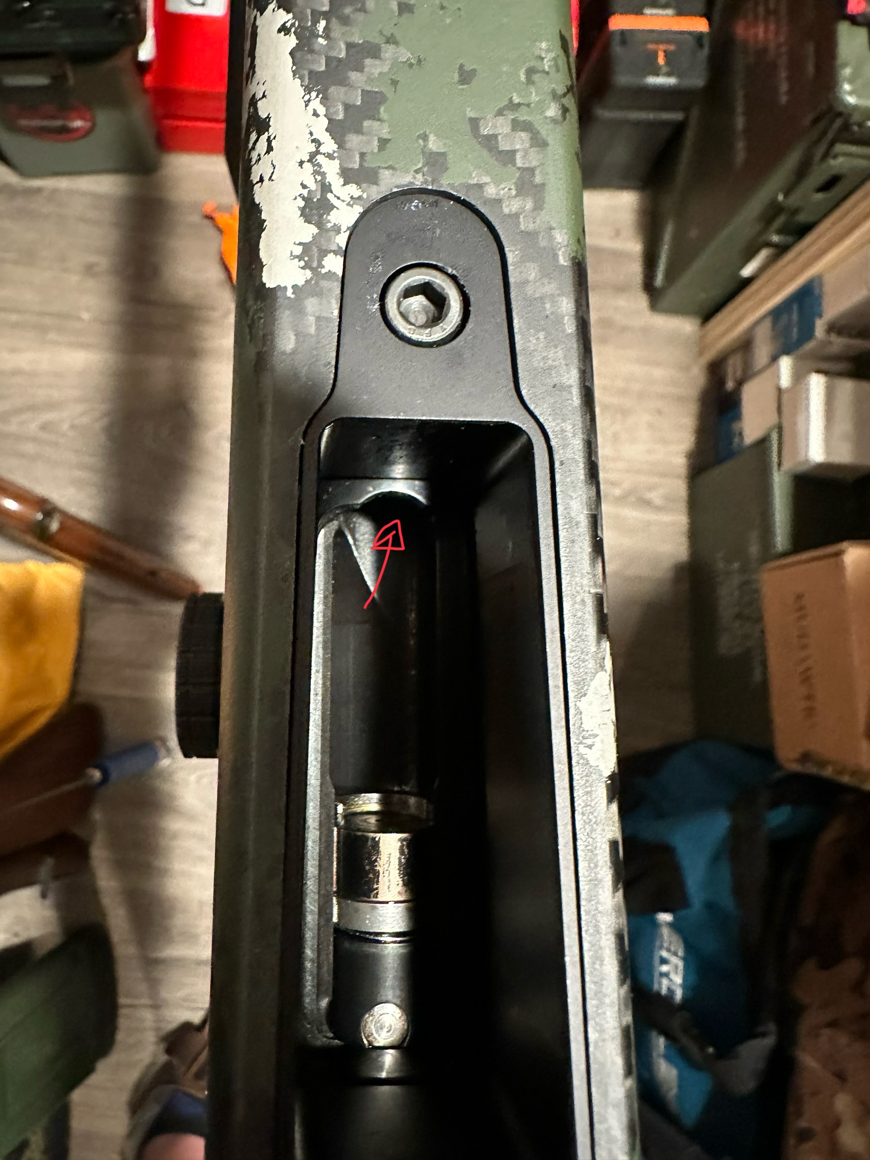

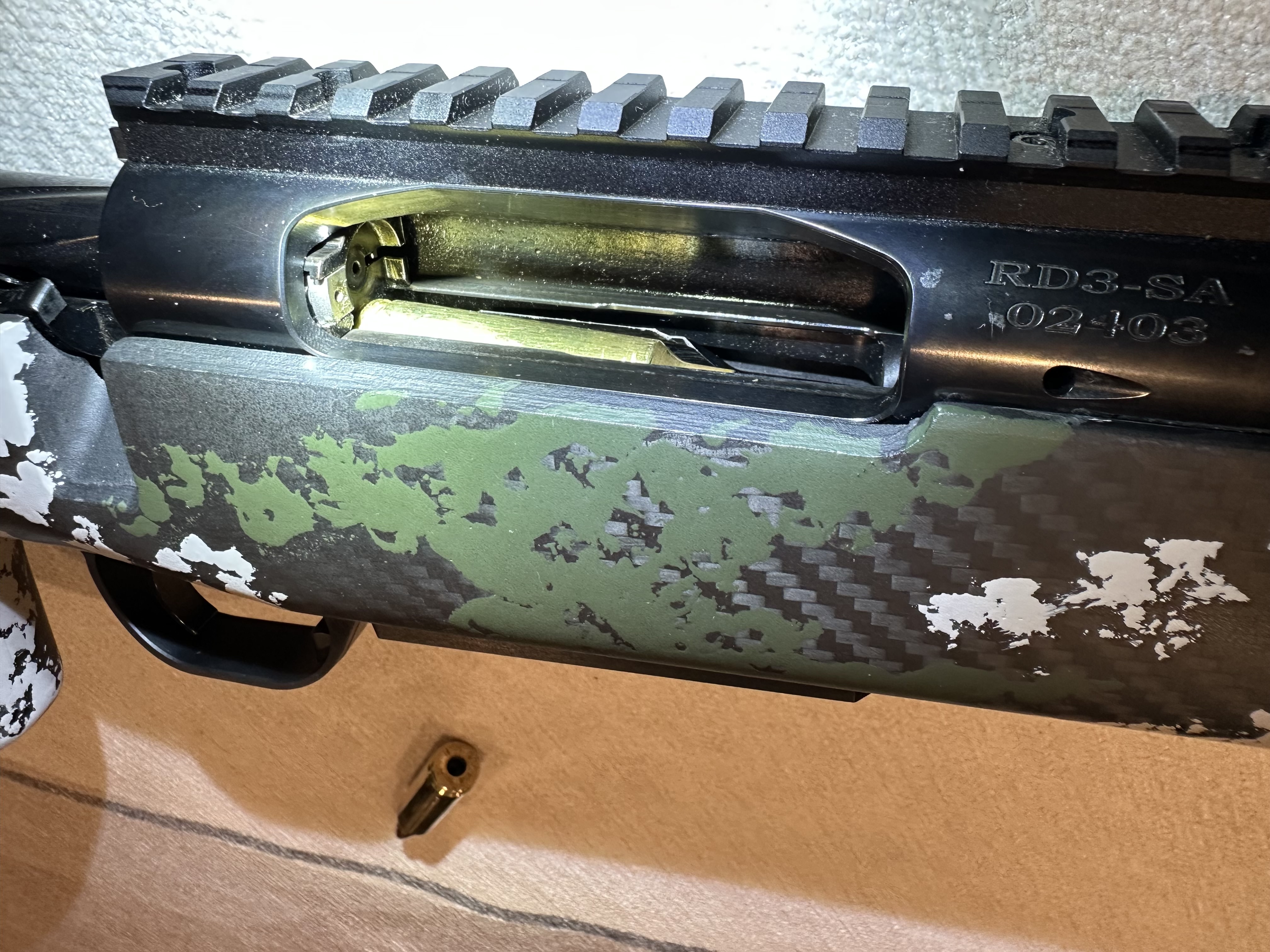

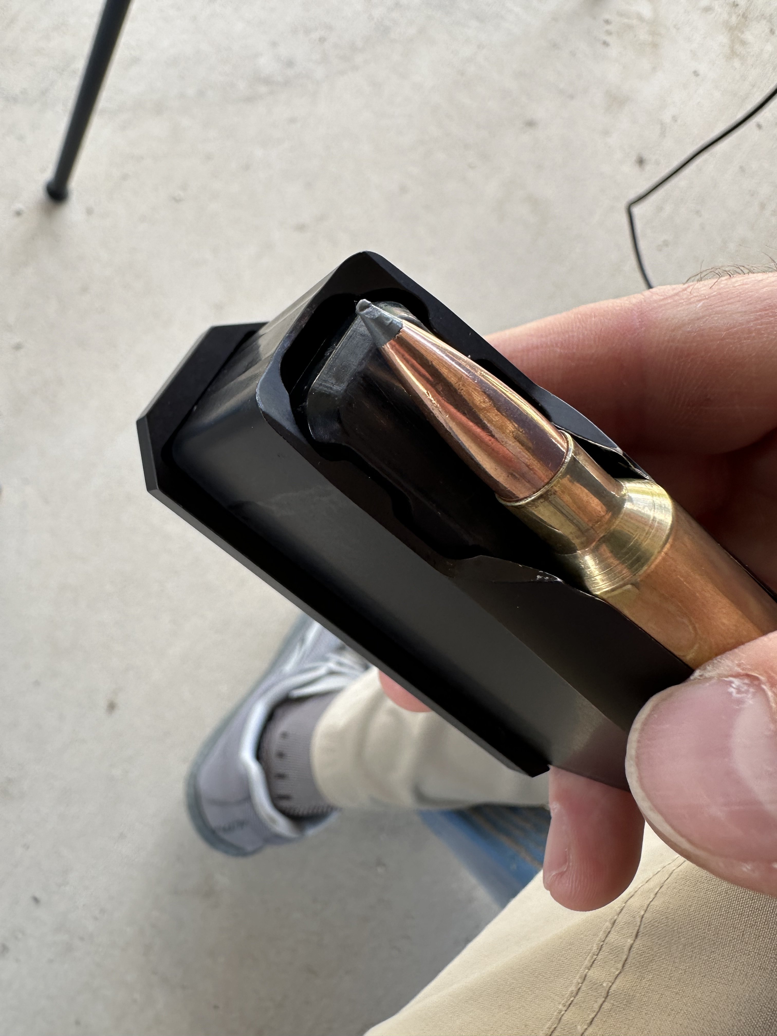

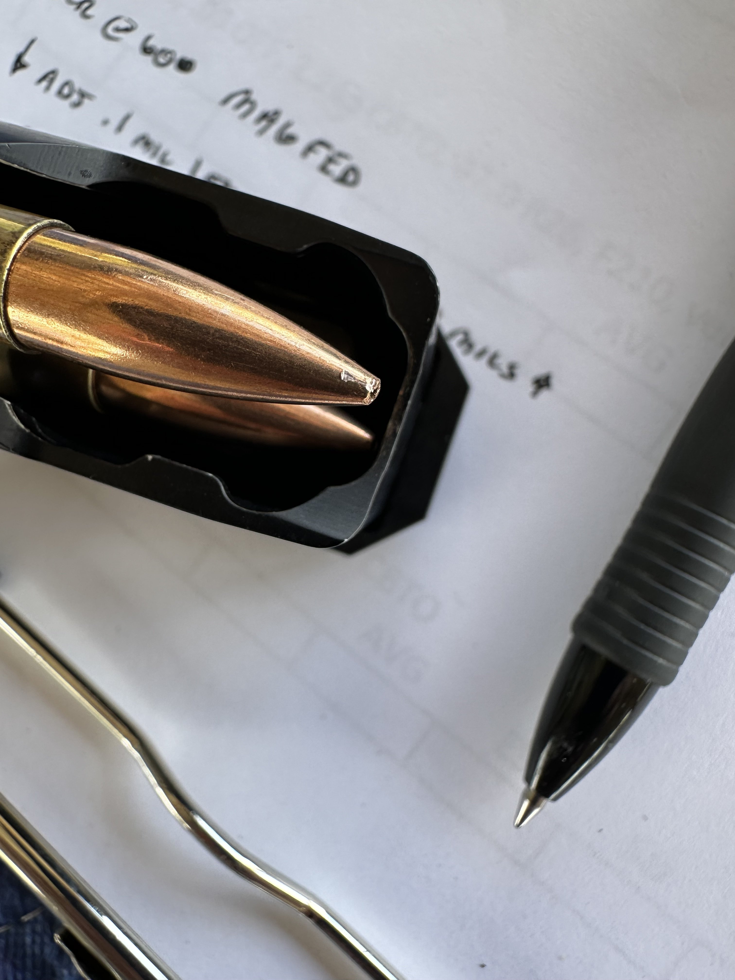

    Follow on question for you all who have run Hawkins mags in your short action Origin with a 300wsm or a 6.5 prc. I have a 300 wsm and the tips of round 2 and 3 are hanging up on the bottom of the feed ramp on my Origin causing failure to feed. I already have the bullets seated .1 off the lands, so I don’t want to go deeper. Look at the pictures below, am I looking at a milling job? Interestingly, the mags click in just fine even though my action is an earlier SN. I have also sent Zermatt an email with these pics and I’m sure they will respond quickly; they have always been very helpful. I just wanted to see if any of you have seen this.
    Havent had that issue with mine.
    (Manners EH1, Hawkins hunter DBM and mag, 200 gr eldx in Norma 300 wsm brass)
    What bullet is that with the grey tip?

    That’s a Nosler 210ABLR. They are going 2725 fps out of that 20” barrel with R26. I sent that one at 600 yards and it hit just right of the center, so I guess bullet tip deformation doesn’t really matter 😭. Case study of one round.
