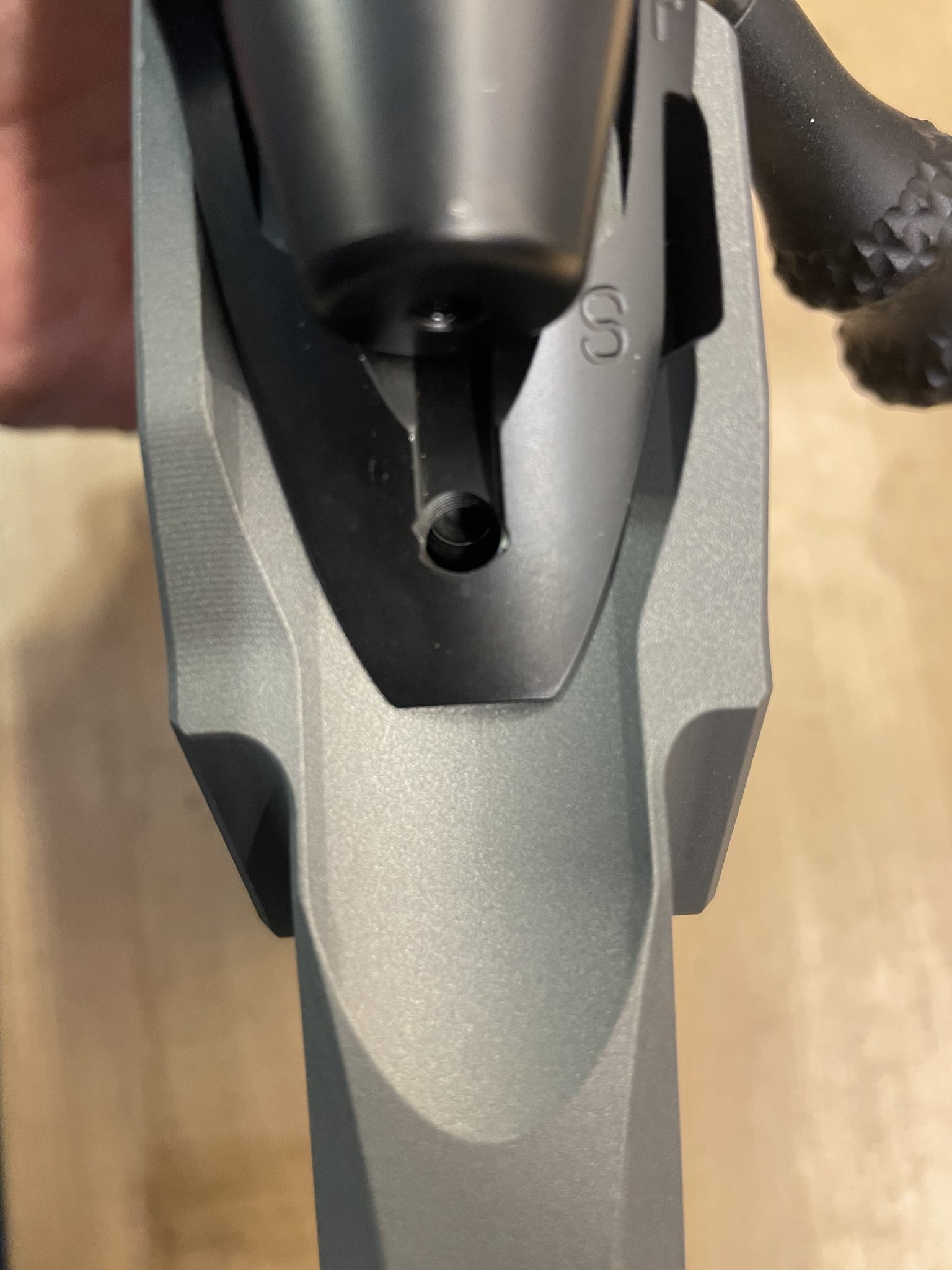

Origin xm mdt acc xm compatibility
Dragn’up
Jul 23, 2017
73
62
I have an Origin XM action and an MDt ACC XM chassis. They are both new and just took delivery of the chassis Wednesday. I asked MDT prior to ordering, if the two where compatible. The answer I got was, they weren’t sure. Zermatt wasn’t sure. So I called a few distributors, they verified that the new ACC’s would fit the Origin XM action. So I ordered one.
Unfortunately the rear action screw is of by about an 1/8”. Called MDT thinking there was a problem. They said it wouldn’t fit.
So my question is, has anyone milled the action screw out on an ACC XM to accommodate a Lone Peak or Zermatt XM action?
Once I receive a MDT XM magazine, I will confirm fit and consider milling the rear screw hole to fit the action.

Update, I finally received an MDT XM mag to check the fit with the action. I milled the back action screw hole on the chassis 3/32” using a 9/32 end mill towards the rear of the stock. It was successful. The lug is against the stop and both action screws secure it down like it was a factory fit. I’m satisfied. I will try and post pictures in a few days.
