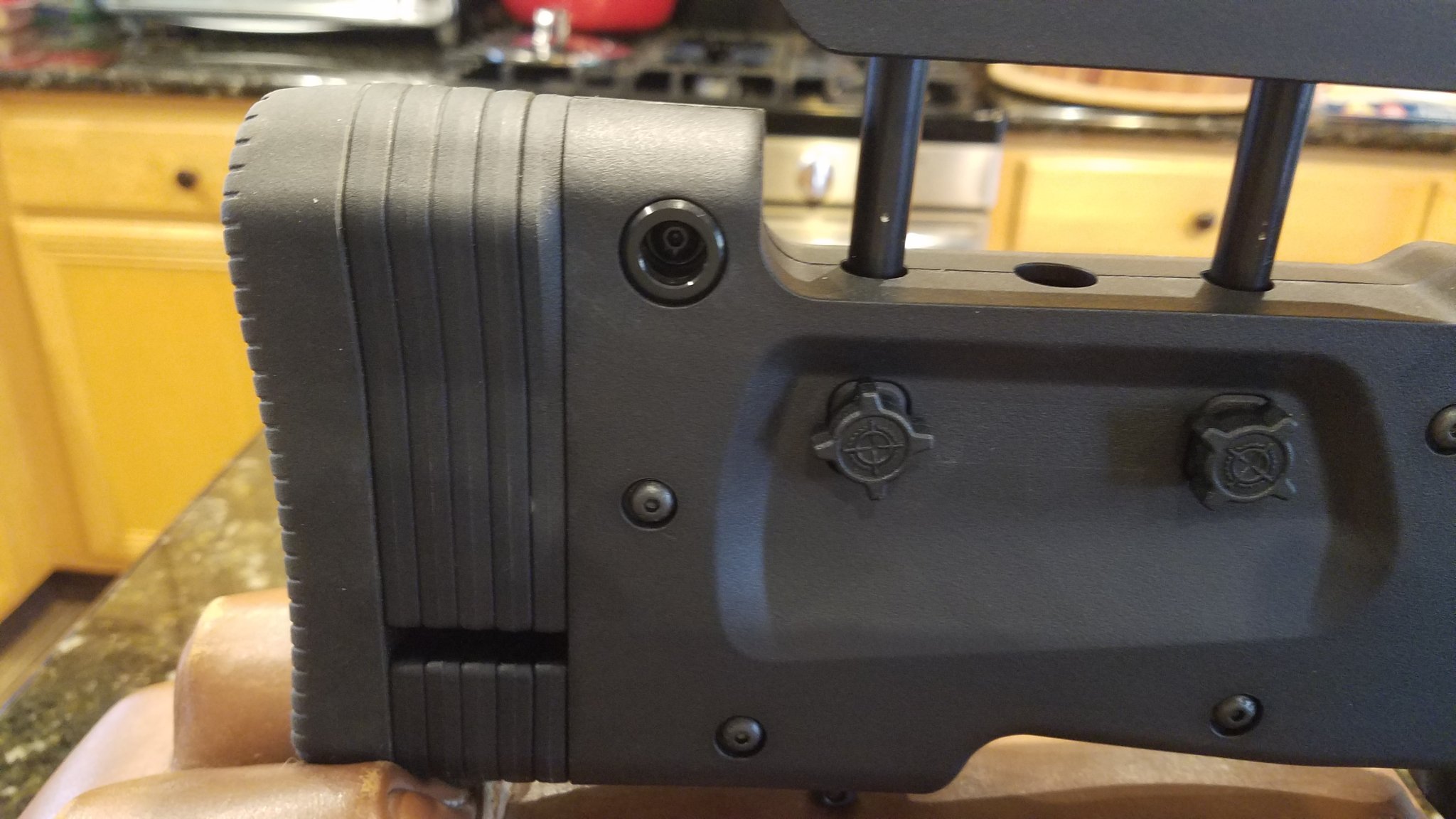

It wasn't originally listed as an option, because the previous version of the Oryx Chassis came without a mounting point on the bottom for the bag rider. The mlok channel came as a revision some time later last year.
In my case, the LOP added by the Jamer option is exactly where I needed to be (I use 2 spacers on my second Oryx), so it killed two birds with one stone.
Like I said before, either option works well, just depends on the application. Hope it helps for your plans.
I could honestly use another spacer, but this works for bench shooting too.
Definitely need it for prone.
