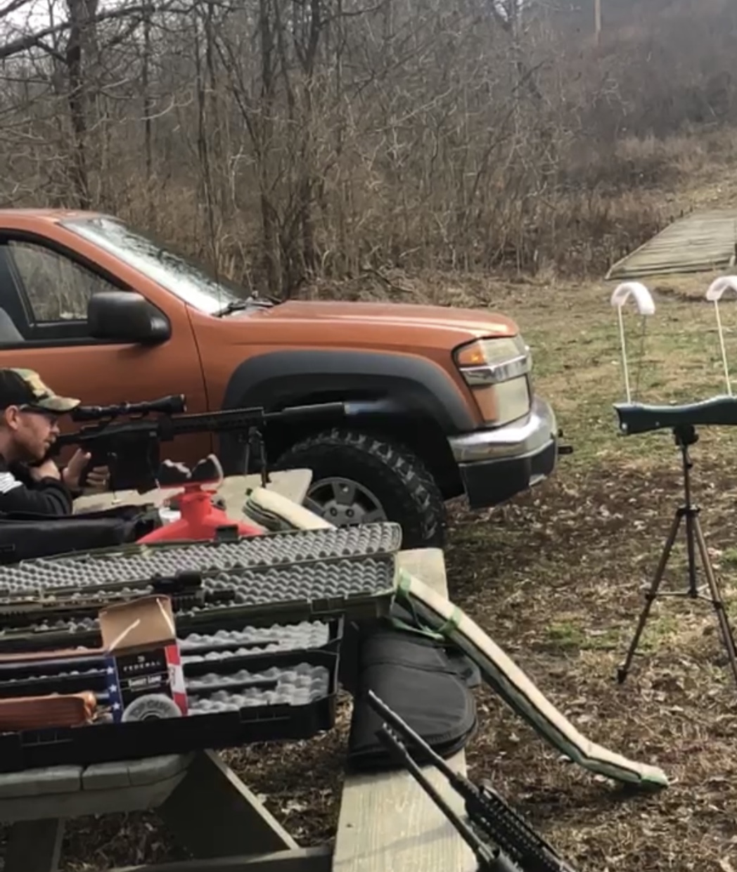

I have an OSS 7.62 and I love it. Gas blow back is minimal. Poi shift is minimal. I have threaded it onto all my guns and when brought the can back, same zero. (With can). I used ion 556 SPR, 6.5 bolt gun, and 16” 6 ARC. 556 is okay to shoot a couple rounds without hearing, but wouldn’t shoot all day without ear pro. 6.5 creed is suprisingly quiet. And 6 ARC is somewhere in the middle. 556 is used without adjustable gas block and no cycling issues and doesn’t seem to be over gassed. 6 arc has aero adj gas block and I have it at about middle setting. (Would lock to rear but not kick out brass, from there added 2 clicks. No issues )
slightly more carbon build up, it is after all a suppressor, so just increase your wipe down cleanings. Check your chamber when you do, couple cotton swaps and it will be clean.
Best question is to find your intent for the firearm. If you want dead quiet, then another option may be available. Crack of a high velocity round is hard to quiet. But if you don’t want gas in your face (I am a lefty), and easy to thread on and swap (the taper works great, my course threads are crystal clean) and be able to shoot for hunting without ear pro (night time thermal suppressed coyotes that doesn’t even wake the neighbors up) then I’d say go for it.
Will I eventually buy a different brand and style for a different purpose? Sure, but you won’t know exactly what role this tool fills until you try it, IMHO.

good shot of the flow through working.
