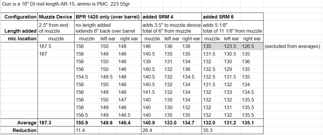

I wanted to attend the metering events hosted periodically by the NFATalk guys, but it didn't work out until the most recent one (yesterday). I decided to put my money where my mouth was and made the long drive to go satisfy my curiosity and add a little data to his database. So I finally have some numbers! Maybe there's somebody out there who also grabbed the closeout deal who will find it useful. And I gotta say that I do feel a bit vindicated. No it's not the exhaustive back-to-back comparison that the engineer in me always wanted, but it's more than we had before and I was pretty pleased with the results.
I'm not going to do a detailed explanation of the Gen 4 product because it has been replaced by a different design, but basically it was very modular. What I did was test 3 configurations:
1. just the muzzle device--it spits a lot of gas out to the side because it's designed to send it into the section that goes over the barrel so the muzzle meter readings were pretty high, but it's a baseline.
2. just the over-the-barrel section added, which does not add any length past the end of the muzzle device but is quite long and does make a difference
3. adding the short 5.56 module
4. I also got a 7.62 version of the Gen 4, but some of the sections are compatible with the 5.56 so I added the forward section which is longer than the 5.56 just for fun to see how low the muzzle numbers might go. I doubt it's a good idea to do a lot of shooting with this configuration, and I assume the manufacturer would not have approved of using it this way, but it was a fun experiment and I was happy to take the risk of something getting damaged for the sake of science. Maybe somebody will find it interesting, I definitely did. One thing that I did not expect is that the ear numbers never budged even though significant length was added. There may be something there worth talking about further.
I just realized now as I'm typing that I forgot to test one more configuration, which would be to use the longer 7.62 module instead of the short 5.56 module. I suspect that it would have knocked a few more db off the muzzle numbers, but for now I'll just have to add it to the list for next time, by which point I hopefully will have an AR-10 so I can also measure the 7.62 performance.
Here are the numbers--when I snapped a picture of the data sheet I missed the initial ear numbers, so when I get that from the NFATalk spreadsheet update I'll add it.
Something weird happened with the first shot in the longest configuration--I got a little excited when I heard those ear numbers, but after seeing what happened with the rest of the string I figured it should be left out of the average calculation. But I'd love to hear somebody's explanation for why that happened.

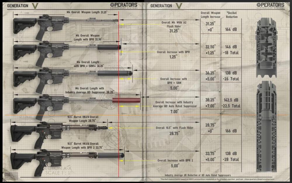

At one point OSS had this graphic on their web site. It's for Gen 5 but I don't think the differences from Gen 4 were substantial. Their published db numbers are supposed to be 6" from the shooter's right ear, and from what I saw with my numbers they appear to be reasonable. I think there was a lot of skepticism when those numbers were first published, so it's nice to confirm them even though we are years removed from that product line.
