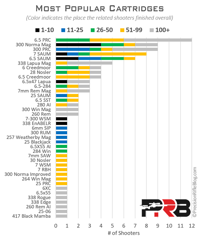

These are the calibers most popular with precision rifle shooters (PRS/NRL), using bolt action rifles, at ELR competitions "... to engage targets from 700-2100 yards … in sustained winds up to 35 mph and wind gusts measured on-site up to 60 mph!" - Cal Zant
Which wildcard cartridge has some crossover potential, not only for civilian use or the precision rifle community but also potential military application? A lot of these calibers seem way too large to fit your average AR-10 / LR 308 receiver set, barrel, chamber, mag, etc. Could any of these large calibers find a home on the AR-10 platform? Is there another cartridge on the horizon that I'm missing or not being used in the PRS/NRL world?

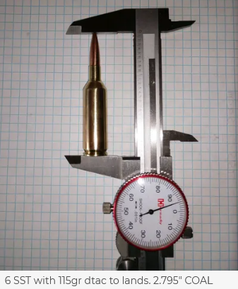

You'd have to call around to reamer Co's to see what designs they have, IMO .004" neck expansion is about right.
Be sure to check the measurement of ribs in the magazine to make sure AI would work before you go forward. Maybe someone else here has built AI in a large frame and they can answer this question.
My 6mmFatRat is an AI and it works well in Grendel magazines so 25CMAI might also work in large frame mags.

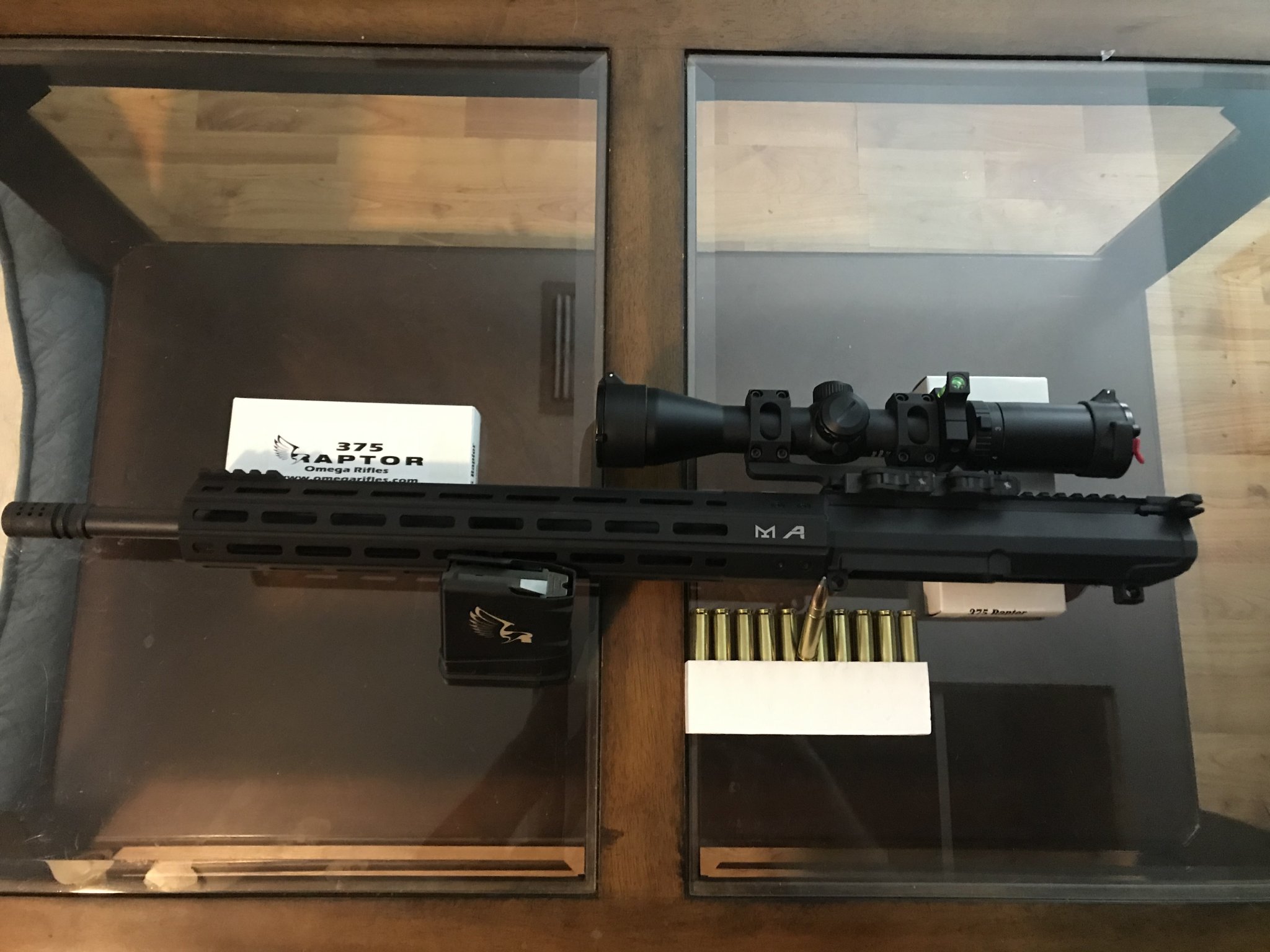

...too much case capacity for the bore volume on a gas gun for the 7mm...
Does this apply to all magnum case LR308 guns?
I think the pressure levels after the dwell time starts really effects the operation of the LR308.
Meaning my 24" 45 Raptor (rifle gas) has less pressure in the barrel during dwell time, and has a less detrimental effect on the BCG, than my WSM does with a rifle +2" with a 26" barrel.
And really those 2 barrels have the exact same dwell time, but the dwell pressure in much higher in the WSM
(Dwell time being the amount of time the bullet is in the barrel AFTER it passes the gas port)
I have a much broader range of powder loads with the 45 Raptor, than with the WSM.
When I'm pushing the WSM from 50-55kpsi, the WSM, with 3 different bullet weights, and a myriad of powders...wants to work with a few combos
I believe that with a heavier than 9/10 oz. buffer this would be achievable.
I'd like to try a 12-15 oz buffer in the WSM.

I've been wondering if cases with steel heads (ala Sig's .277 Fury) are going to catch on and be applied to existing cartridges. If so, we could potentially see small-frame AR cartridges approach the performance of large-frame AR cartridges (6.5 Grendel approaching 6.5x47L performance), and large frame AR cartridges approaching magnum action performance (.308 performing somewhere between 30-06 and 300 WM).
I'd be pretty happy with a 300 blk that could approximate .308 performance.

The low end of that range has only .045 in to spare and the high end is a full .155 in too long - that is quite a bit too long.
Even if we assume KAC or Larue mags are used, the high end is still something like .105 in too long.
Time will tell if it’s supported well in the AR10 market. Given that it’s probably not going to feed anything but the lightest weight / shortest / lowest BC bullets I would guess probably not.
