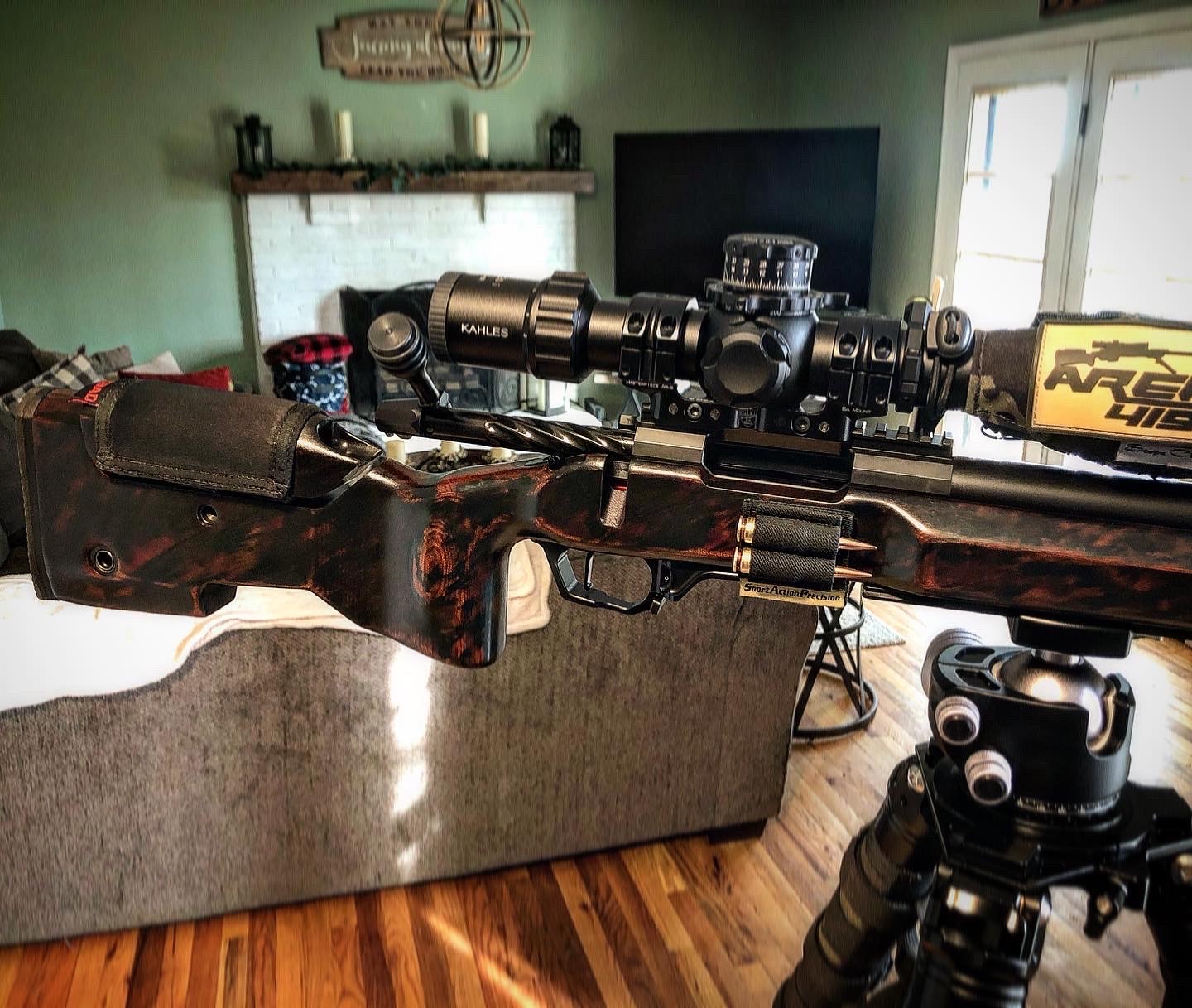

I was having trouble feeding the last round out mdt and AI mags. Seems they are sitting a hair to low. Is there a way to tune the mag catch on the magazine or the otm bottom metal? Or tune the mag spring or something?
When you say Joe, the otm shop?No, but if you call Joe he will help you troubleshoot. His advice will likely be to open up the mag feed lips to present the round higher and ditch the MDT mags, but it could be a number of things.
If the other rounds feed fine, I would suggest this:Got my barreled action last week and was finally able to get a few sent down range yesterday. I was having trouble feeding the last round out mdt and AI mags. Seems they are sitting a hair to low. Is there a way to tune the mag catch on the magazine or the otm bottom metal? Or tune the mag spring or something? I’m still new to all this so where should I start. Other than that I really like the look, the flared mag well and the mag release on this otm.
Yes, he would be the proprietor to my knowledge.When you say Joe, the otm shop?
I’ve cut G10 and put in the bottom of magazines to increase spring tension. Typically it doesn't take much height or thickness so you dont lose any capacity. I havent had much luck stretching springs; especially in Rem 700 BDL hinged floorplates.If the other rounds feed fine, I would suggest this:
Take apart the magazines and stretch the springs using a clamp with the jaws in reverse. A 12 inch clamp works fine.

The issue is this is not possible when you have magazine extensions. The best way to increase magazine length is the reverse clamp method. Area419, for example, requires you to stretch springs 1.5 inches from base and mention it as such in their directions.I’ve cut G10 and put in the bottom of magazines to increase spring tension. Typically it doesn't take much height or thickness so you dont lose any capacity. I havent had much luck stretching springs; especially in Rem 700 BDL hinged floorplates.
