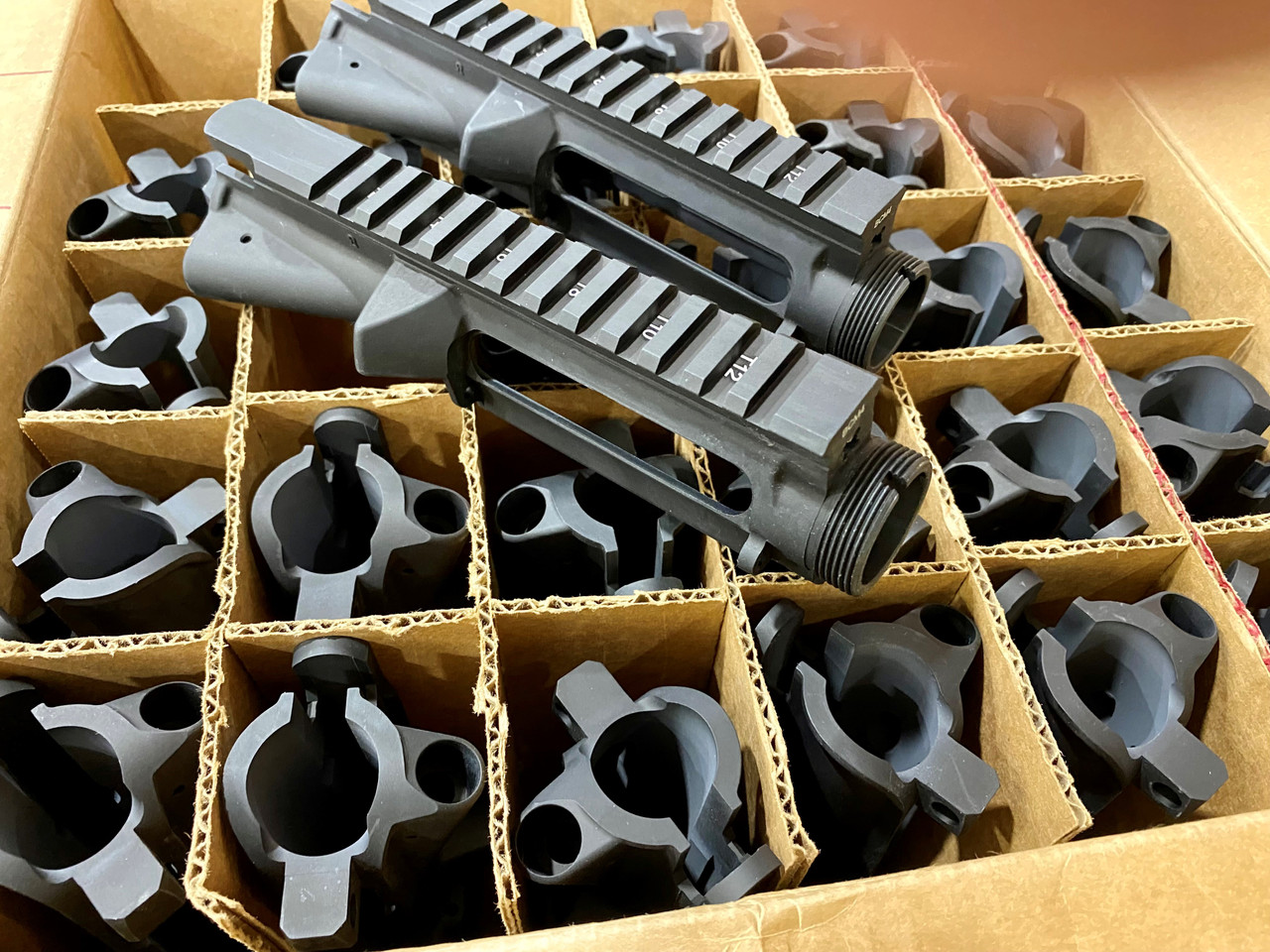

Visually there seems a difference. Did you actually measure? Below is a pic of BCM blem uppers from their page. Some visually look out of spec, but not likely actually out of spec.

Where are you measuring the variance?
I've updated the post with the areas circled that I'm measuring
Yes, left side upper wall (where charging handle/gas key would travel) is .03 thicker than right side. Again, I don't have any concerns regarding safety, just wondering if it would impact accuracy. Also, BCG moves freely and gas key lines up with the port.
