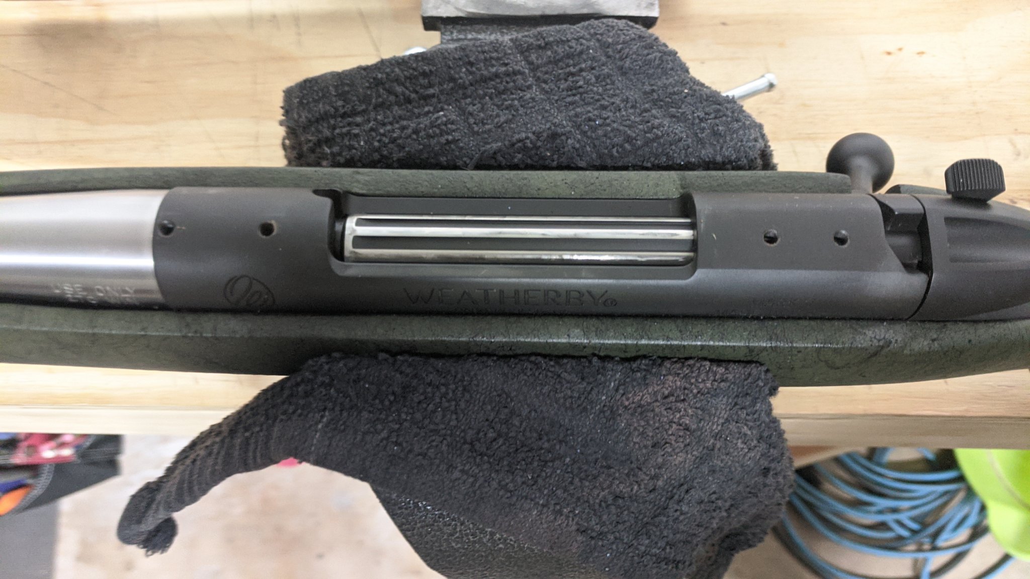

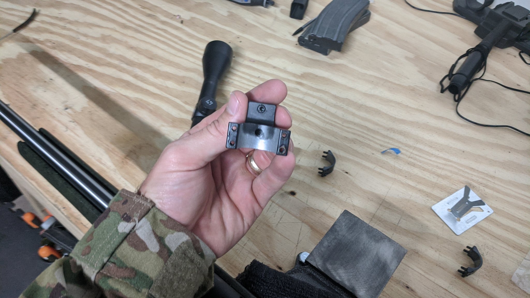

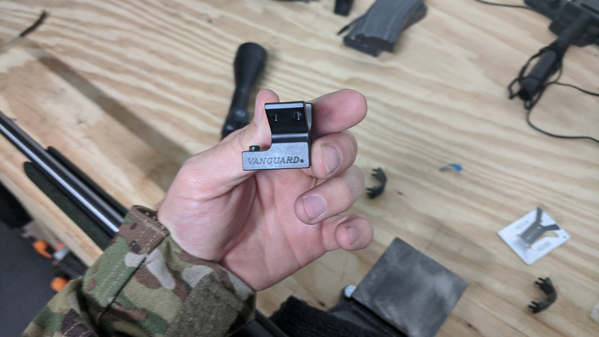

Hi, I've mounted a Zeiss Terra Plex scope to a Weatherby Camilla Mark V using weatherby lightweight rings/bases. When I went to zero it at 25 yards, my rounds were grouping at about 18 inches high, and I ran out of elevation turret travel before I could get them on target. Anyone have any ideas on what I did wrong?
Reactions: Sig Marine
Knowing the scope base as mentioned above would be good to know. Could you have acquired a base that has MOA built in to the base for long range shooing? Also, were you able to get your windage adjustment centered?
Maybe post a pic of your set-up too!
The rings are the ring/base combo from Weatherby. They don't mention an MOA slant. My windage was dead on. I did lap them before I mounted them, otherwise everything I did was fairly standard. Everything was perfectly leveled and torqued to the recommended specs.

Did you use the bases/rings for the 9 lug mark v or the 6 lug mark V? I had issues finding the right bases for my wife’s Mark V Camilla. The big name sporting goods store sold me two piece L- brand bases which had terrible vertical alignment. They turned out to be for a 9 lug action. Then they tried to tell me that bases for a Remington would solve it . I checked and no luck with that. I did some research online and ordered 6 lug bases online and solved everything. Just a thought.
That was it. I called Weatherby and they knew exactly what the problem was. Ordered the right rings and it worked great.
