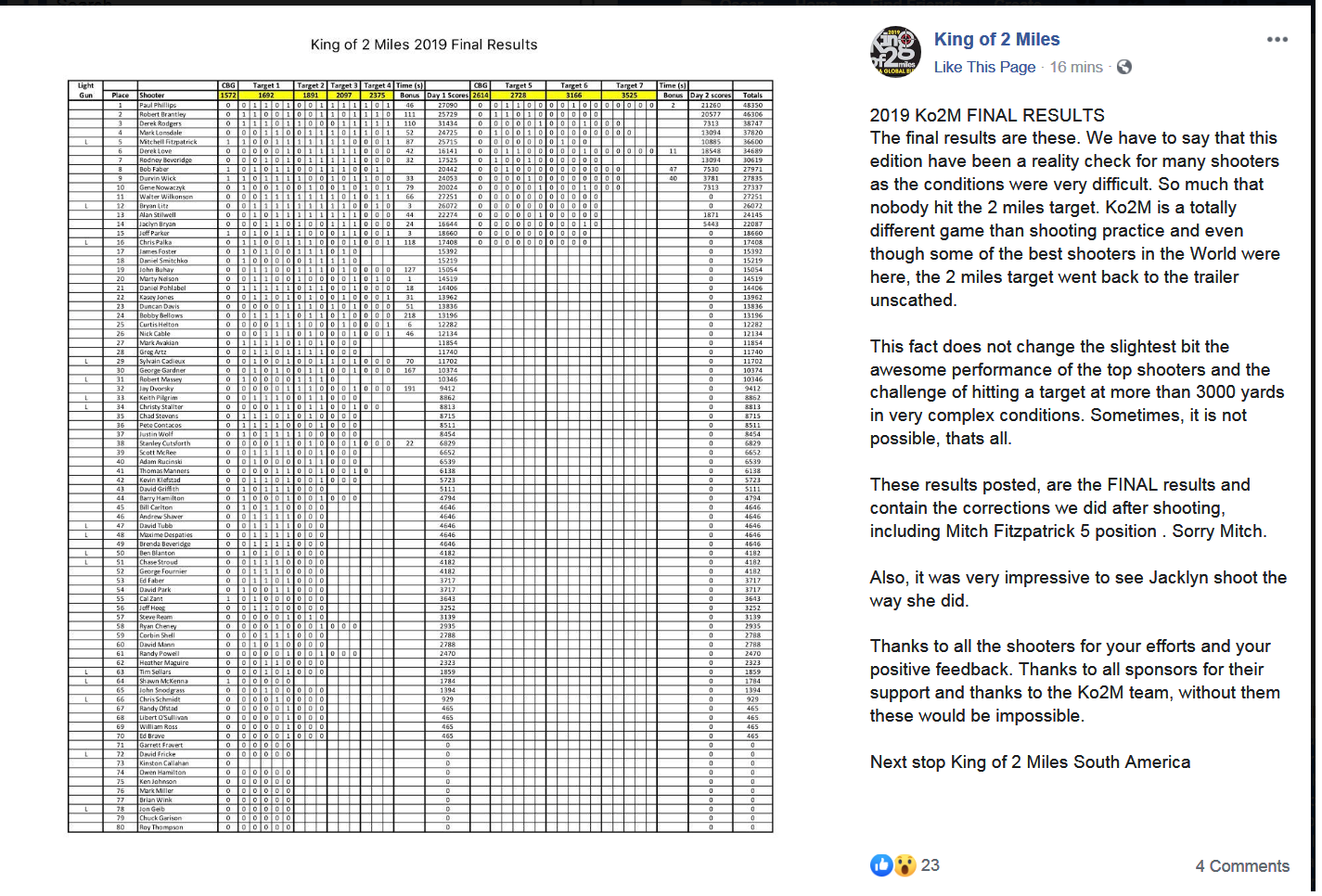

Well, three 6.5 variants went 1,2,3, in hunter class at the nightforce ELR match in Wyoming. Two of them tied for the overall win. NONE of them were creedmoors. I think a 7 rem mag would work to 1800.
Someone should have told a few of these guys about 6.5 cal. The one big thing that lays waste to well laid plans is wind. I shoot my 7 saum to 2075 often enough, it does fine in little or constant winds.
