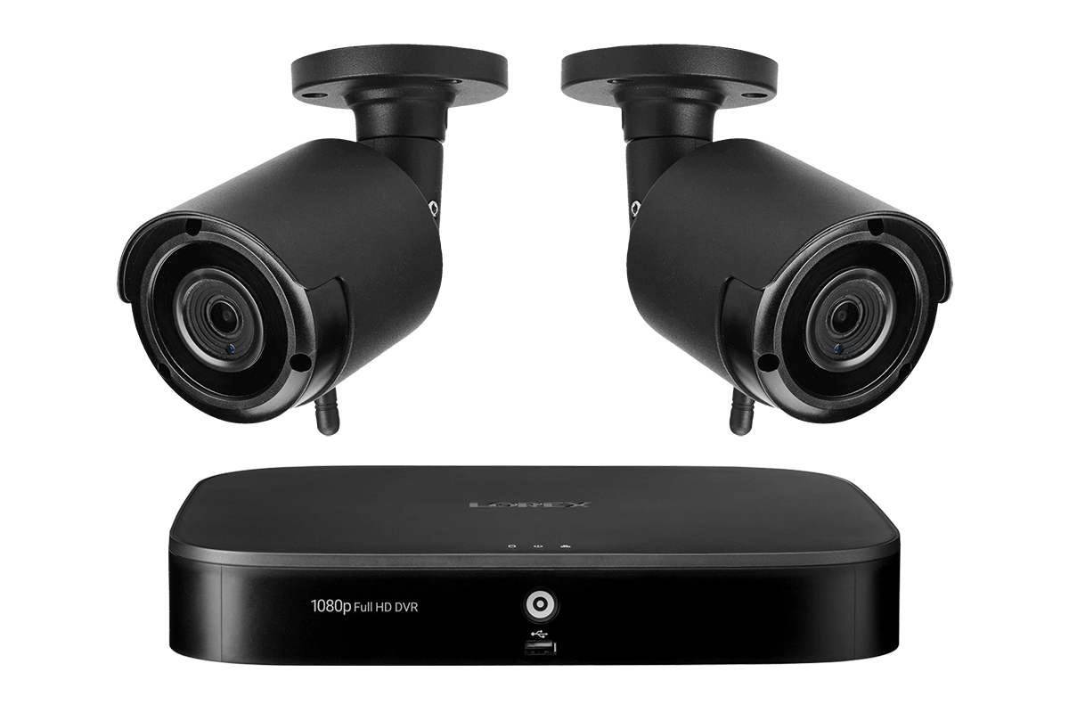

Hi,
Slightly over your budget but they are all wireless (usb rechargeable) with voice, motion, etc etc and she can view everything from her phone.

For security cameras I’d only go wireless when there is no other option to run em wired. THEIS linked a good set. Thing with wireless cameras is that they can be glitchy. With any kind of interference going mileage will vary.
Wired analog are in the price range but 100 yards is stretching the distance a bit. It might work depending on the brand chosen. Alternatively If there is power near where the pig is then you can probably overcome the distance by powering the camera in that location and back hauling the video feed back the house.
Digital PoE (power over Ethernet) systems can go 2 to 300 yards but are going to cost more.

I had this is my office once, bought from Costco. It was a PITA

IMO the Lorex hits the most of what you want. Do not get the Arlo if you are serious about the no internet, the system will just not work as it requires a phone and internet to set up each camera.

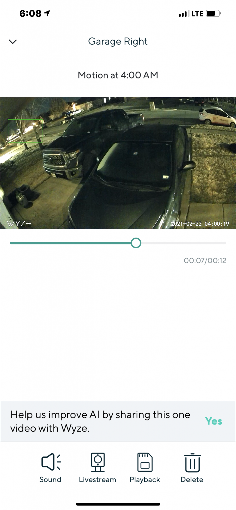

If you can get WiFi to the area I can not suggest Wyze cameras more highly. They are cheap, they work, you can do cloud storage or local.
you can get powered units that run off usb cables. I have a couple like this and what I did was put in a light socket USB adapter to plug them into my spot lights.
They also have rechargeable units I have a couple of those and fully charged I’m getting like 2 months between charges.
they also have a pan and tilt model that tracks movement.
there new cameras provide color at night
This is 4am
