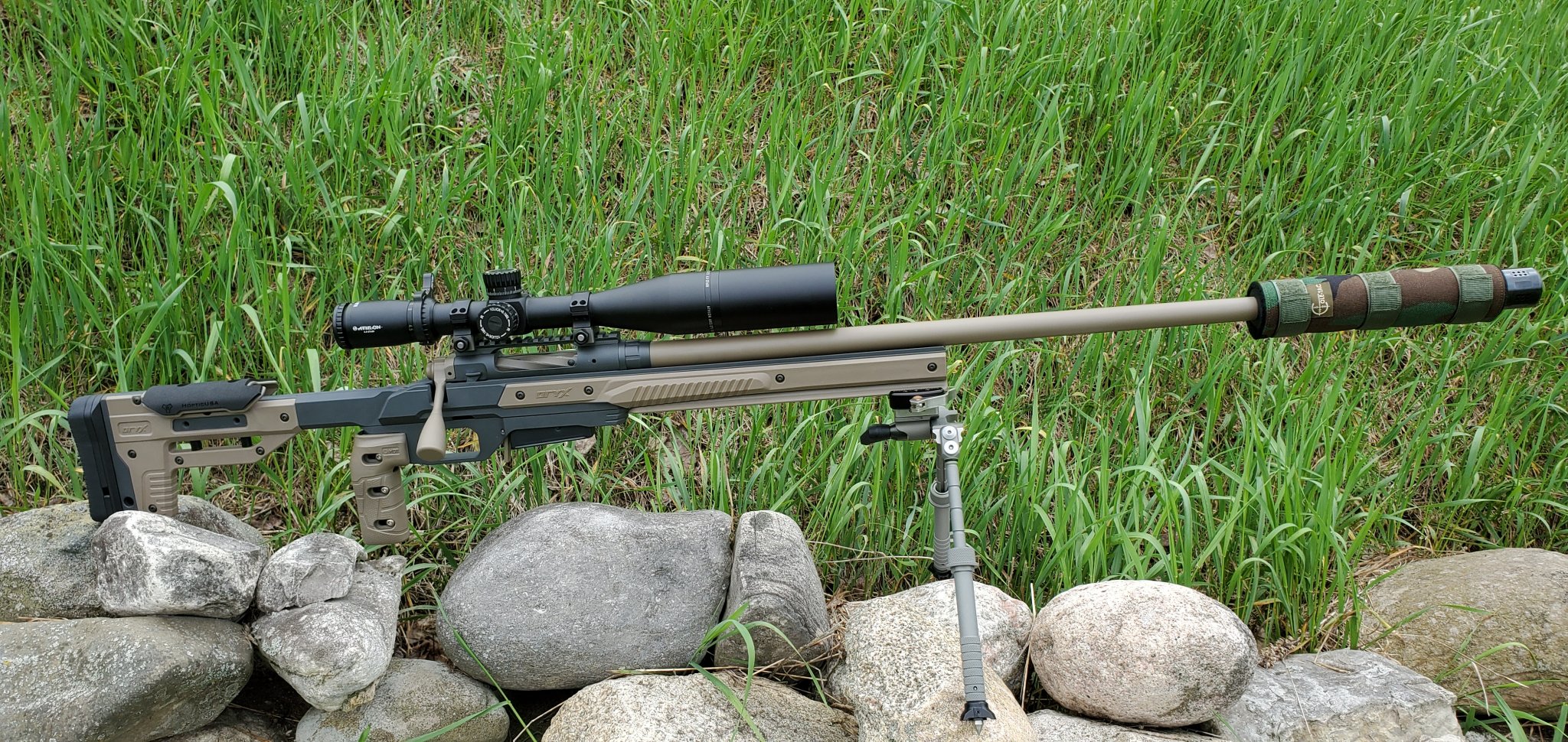

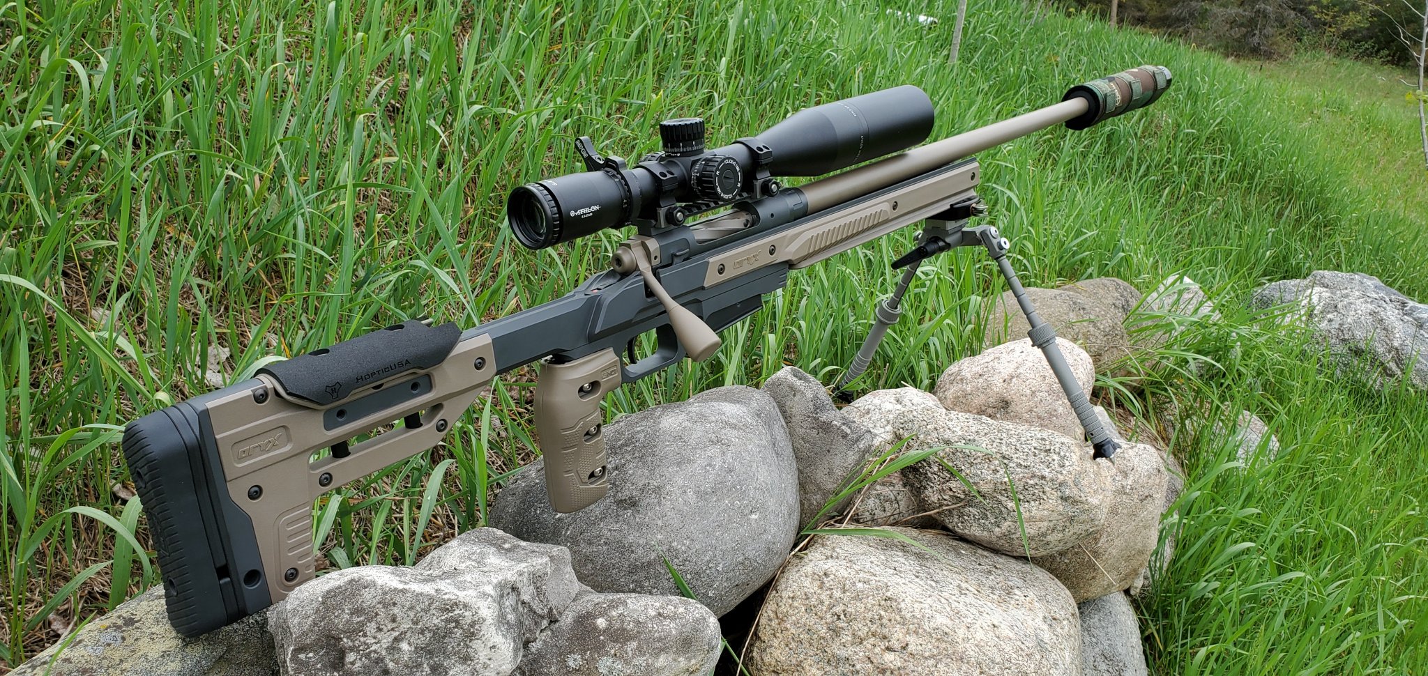

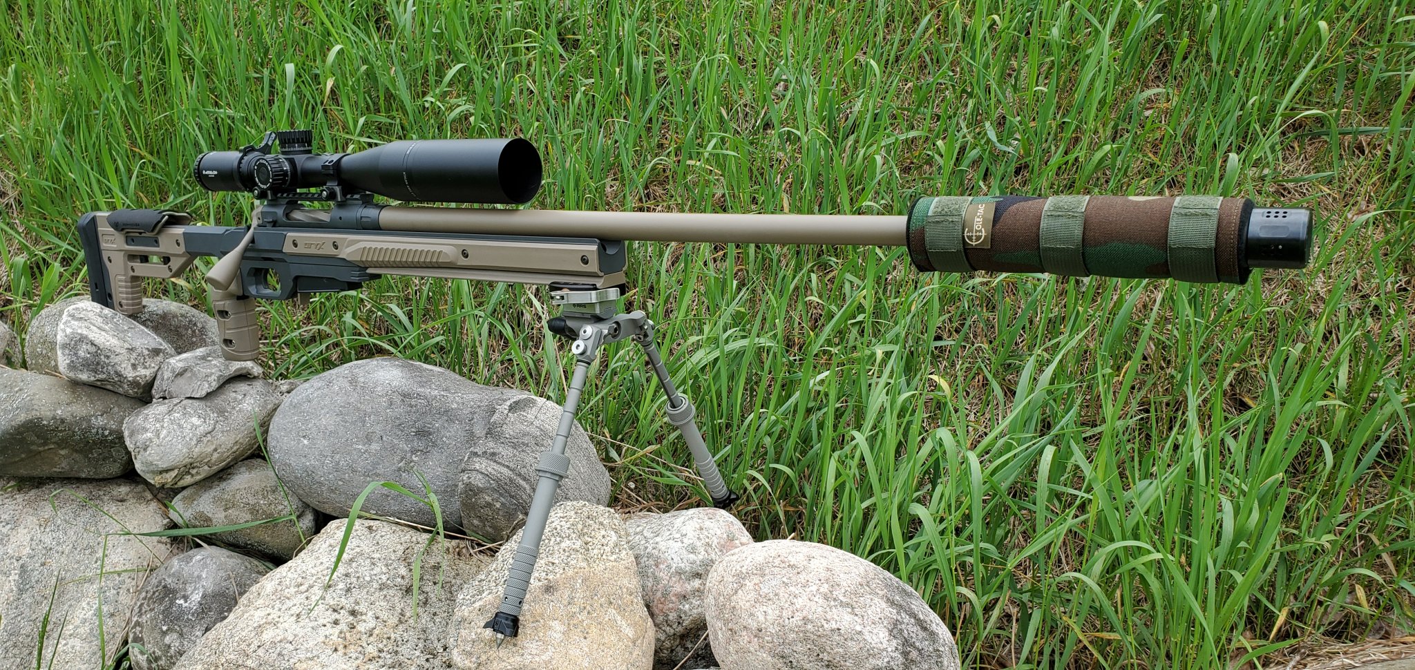

Look to MDT for chassis if yer into that - I put my Savage 10 FCP-SR into an MDT LSS-XL Gen2 chassis and turned it into a <.7 MOA rifle. AICS Magazines and the vertical grip and other goodies helped.

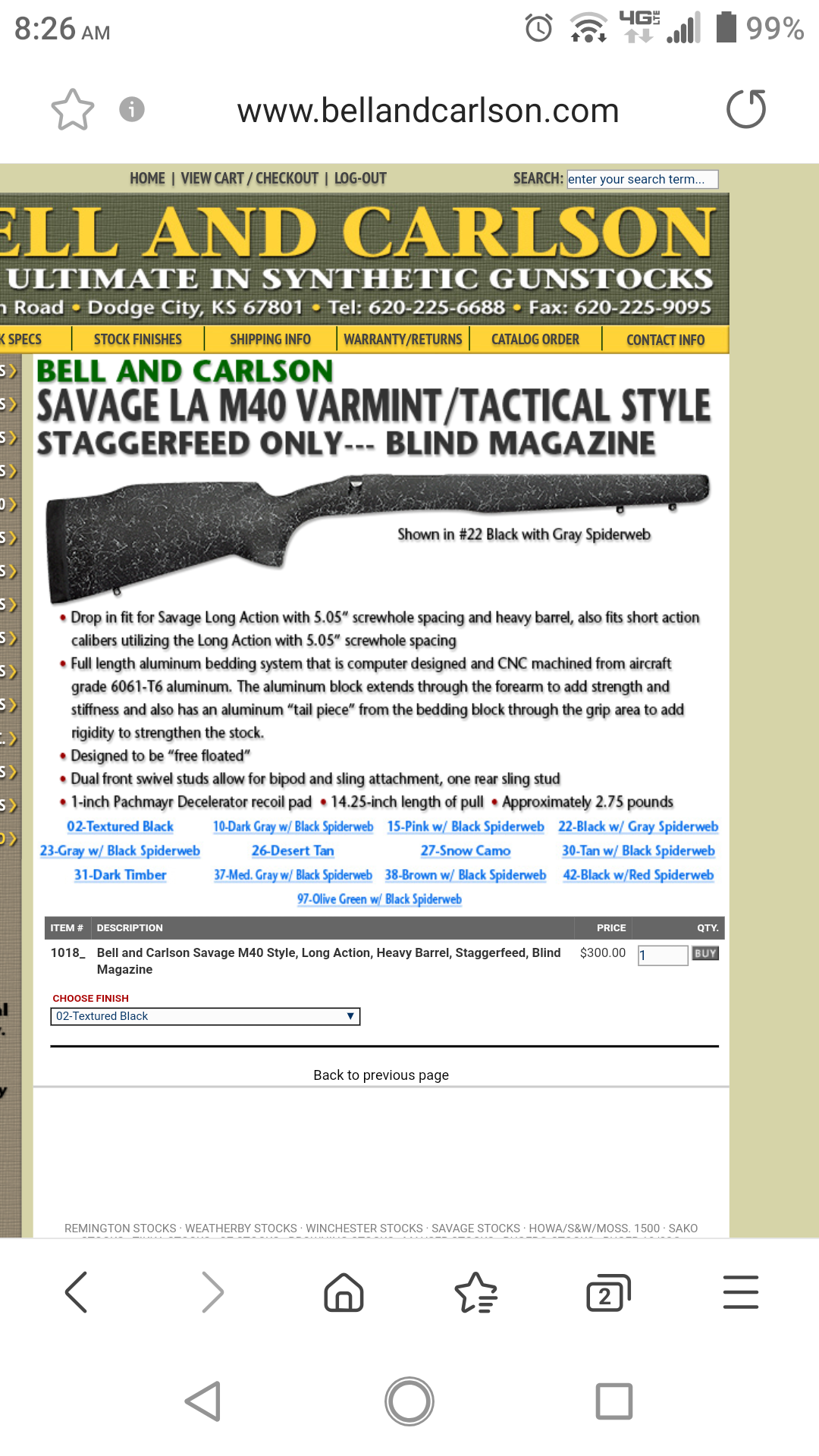

I’ve had bell and Carlson and I would say thats a great option for a stock, I think they are a pretty big step up from choate, mdt has awesome options for chassis‘s, krg is also coming out with an updated option for savage soon.

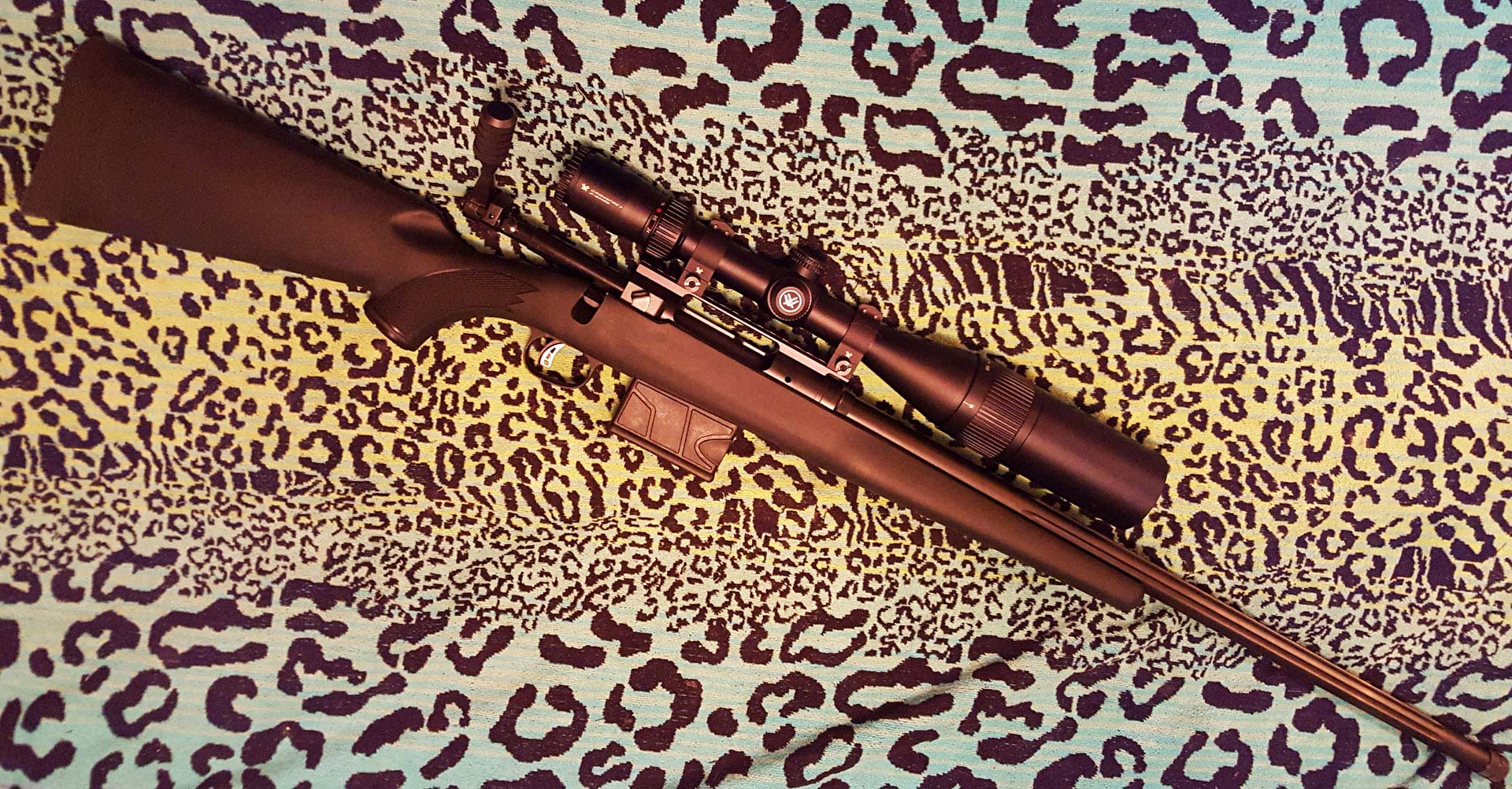

Hey guys,
Thanks for the replies, keep 'em coming. I had not previously considered the LSS Gen2 Chasis System, that is exactly the kind of information I was hoping to get. The truth be told, this wasn't the rifle I was intending to get. But a deal presented itself that was too good to pass up. So here we are.
This rifle won't win any beauty contests. I'm not going to be the most popular guy at the range. But if I can get it putting bullet holes inside of bullet holes, can I really ask for anything else?

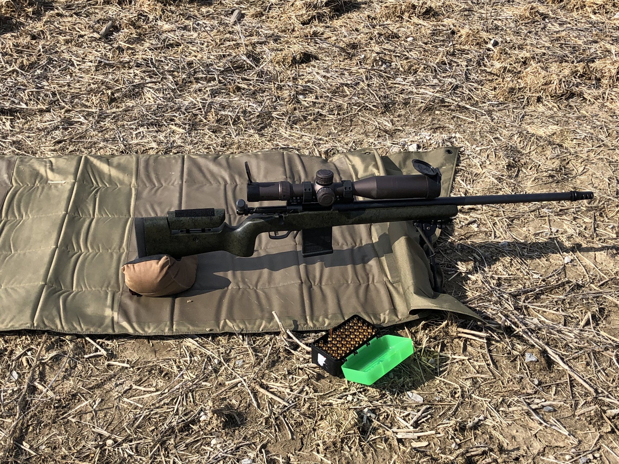

My Model 10 in 300WSM I built. Disassembled and Cerakoted.
Cerakote E120 Smoke and E200 FDE.
The panels I bought as FDE, grip I had Cerakoted.

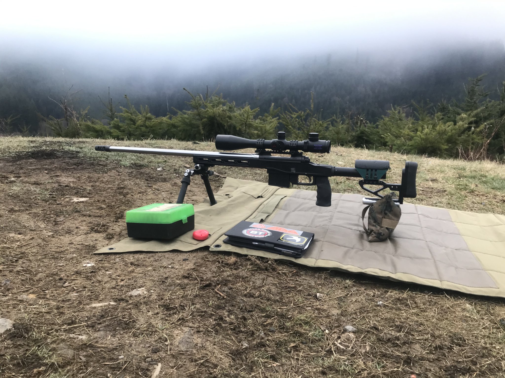

MDT and XLR are a couple of my favorites. Your staggerfeed will have a 4.25” screw spacing vs 4.4” for centerfeed. So keep that in mind when looking for options. Some work with both utilizing a reversible washer setup.
Rifle basix was the go to trigger when I played in the savage game. I usually just swapped out springs in mine tho
I'd definitely do a chassis, skip the bedding unless you really like the more conventional stock setup.

I've been very happy with my B&C stock so far, and its more than accurate enough for my needs. I got mine back when you could get CDI bottom metal for it, but the owner died unfortunately.
If I were buying the same thing now, I'd look into the KRG or XLR chassis...

Hi all,
Thanks for the replies, a number of you have given me plenty of feedback and suggestions to think about. One of the things I'm most conscious of is not just spending money for the sake of spending money. So I've been attempting to track down information on a number of the suggestions made in this thread in an effort to understand exactly what kind of performance I can expect from a stock upgrade, trigger replacement etc.
These Savage rifles have a great reputation for accuracy, but their resale value leaves a lot to be desired. People aren't knocking down the door to get a Savage bolt action rifle, so it can be easy to sink a small fortune in one of these rifles - never to see your investment again. Knowing that this rifle is already in that category, I don't want to get too carried away on the investment.
The two stock options I'm currently considering are as follows:
Bell and Carlson M40 Varmint Tactical
Oryx Precision Rifle Chassis
Truth be told, I'm still considering the Choate Ultimate Sniper and Tactical stocks, but I've read that they're pretty heavy. I wonder how these stack up in performance to some of the other suggestions in the thread?
Choate Tactical
Out of all of the suggestions, the Oryx (1a) and Bell and Carlson (1b) are likely the two choices I'm going to ultimately end up going with. I like the fact I can bring the rifle up to date in many ways with the Oryx chassis considering it's an older model Savage 110. With the Bell and Carlson, it has a more traditional look to it that I find attractive. Performance is where it counts the most for me, but it doesn't hurt to have a firearm that's easy on the eye as well.
I have a choate tactical, it’s ok but I like my XLR element a LOT better.
Savage can definitely be a dead end financially but if you’re planning on keeping it you get a decent rifle for the $$$
This savage has burned out quite a few barrels and I just have a hard time moving away from it.

My savage was my only bolt action for many years and my introduction into long range shooting.
I learned a ton on that rifle.
Reactions: AllenOne1
If you are just starting out in long range shooting the Savage is a great platform in my opinion. I have a model 10 GRS that I have been shooting for the last 3 years and have learned a lot about shooting and rifles. It came in a GRS Berserk stock from the factory and I still like that stock. I have changed out just about everything on the rifle so now I have the original GRS stock, the action and bolt which I have modified.
The great part is you can try out things that you won't try on a $5k Kelbly, if it doesn't fit you right you aren't as worried about taking a file to it and "fixing" it. If the trigger pull is too heavy cut the spring off and see what happens. If you like to tinker with stuff it's great, if you are one who has a gunsmith do every repair there are probably better ways to go.
And winning with a Savage against a bunch of custom high dollar guns is just icing on the cake.

The only thing I do to a Savage is a B&C M40 stock. Be careful though. They are for blind magazine top bolt release. Anything other and you will need to modify a little. I have a few Savage actions. Savage makes too many small changes and they lost their fucking minds. Thus, mine are all set up for single shot. They are very accurate with decent barrels that are not Savage. With what they have out now and not many choices for aftermarket I suggest a varmint model and just leave it stock.
Bell and carlson makes the M40 stock for both blind magazine and detachable magazine rifles. You just specify which one when ordering. the big change everyone talks about is screw spacing. this effects what stock works. if you have a savage made in the last 7 years or so the spacing is 4.4 inches the 4.25 inch spacing is older. I would have to look up when the change was made, not a major thing to think about unless the rifle is older.
The OP has a LA
